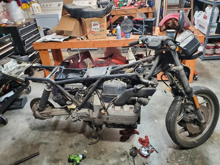

* Getting Started.jpg (100.29 kB . 768x576 - viewed 4446 times)

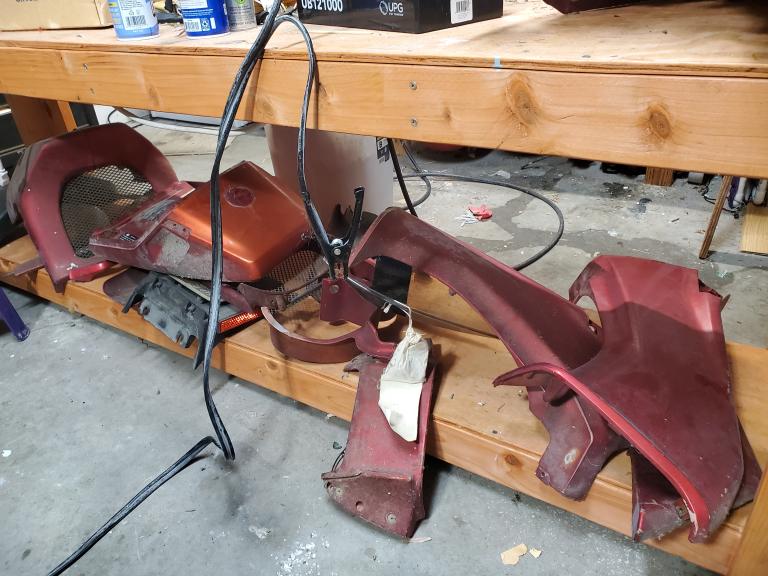

The body parts will be the last priority, obviously I have to get the mechanicals squared away first. Somehow a few of the fiberglass parts got cracked so that will all need repair before painting. They'll stay out of the way for now.
* Body Parts.jpg (76 kB . 768x576 - viewed 4542 times)

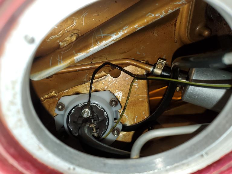

The first priority is getting the engine running, fortunately I sprayed the cylinders down with oil prior to hibernation so the engine spins freely. I played it safe and changed the oil and filter, good thing because the old stuff was thick as gear oil. I also drained the coolant and replaced it with a gallon of distilled water for now. I already knew the fuel pump was bad, so I ordered a new kit with hoses and filter. While waiting for that I did an inventory of what else was in need of attention. Both master cylinders were shot and the rear one was seized, so I started with that. The screws securing the MC to the foot peg mount were stuck solid, I removed the entire bracket but I couldn't even impact them loose. I feared this would be a harbinger of things to come but pressed on. I decided to disassemble the cylinder in-situ, and big surprise that wasn't happening either.

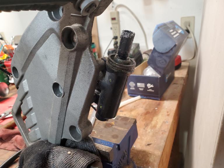

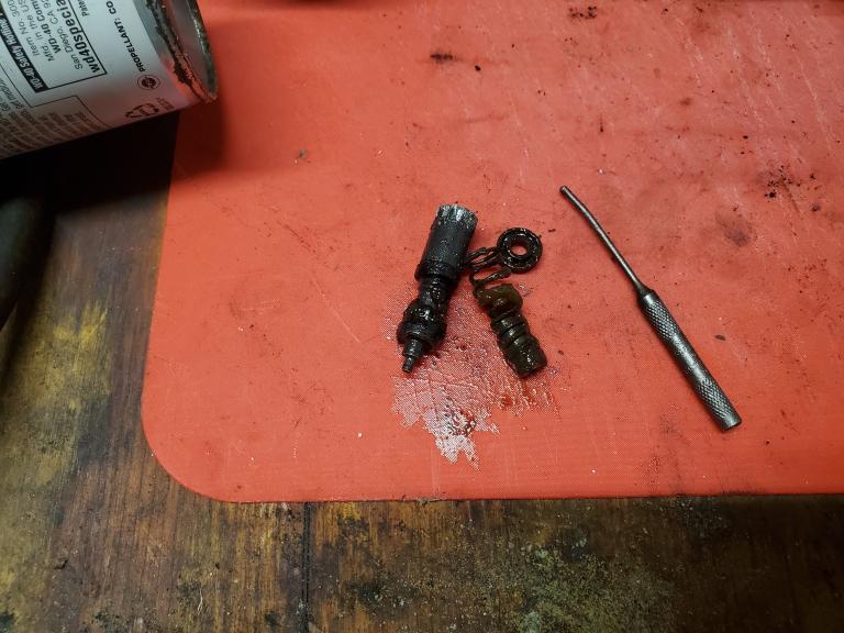

I soaked it with penetrant for days and finally got the guts to free up enough to hammer out with a small punch. Yuck...
* Unseized.jpg (66.27 kB . 768x576 - viewed 4664 times)
It's the dreaded 13mm Magura unit so replacement will be a challenge. Motobrick to the rescue as I found several posts here with "alternative" options using generic master cylinders. I'll give the original cylinder a good inspection to see if it's even salvageable, if not it's fabrication time. Fortunately the caliper itself, although leaking, came right apart and just looks like it needs new seals. Well that's a little hope at least but forget that for now because THE FUEL PUMP IS HERE!!!

With the new pump and filter in place I temporarily reinstalled the tank and attached the fuel lines. I have an RV battery that stays on a trickle charger in my garage which I used with some jumper cables as a 12VDC power source. With everything hooked up, a little gas in the tank and a fire extinguisher within easy reach, I turned the key and was pleased to see the dash light up for the first time in 30ish years. I assumed (wrongly) that the fuel pump would power up with the key in the "RUN" position, but no luck. After wasting a day poring over the wiring diagram and chasing wires with a multimeter, I suddenly remembered that this was a BMW motorcycle. Yeah, gotta push the start button so I held my breath and gave that a try. The engine spun nicely as did the fuel pump, so far so good. I had already disconnected the hose from the fuel rail that goes to the regulator and attached a length of rubber tubing to the rail and put the other end in a drain pan. That way any crud will be flushed clear before it gets to the injectors (I'm not kidding myself into thinking those won't need attention). The gas flowed freely so I reattached the hose to the regulator just to see what would happen and tried again. Needless to say every inch of rubber tubing on this thing is harder than my arteries and the lines to the tank are no exception, the line feeding the fuel rail had several pinholes that showed up immediately. The next day I picked up a foot of fuel injector hose from an auto parts store and tried again. The engine turned sluggishly and the fuel pump stayed silent. I wasted more time troubleshooting before realizing the problem was with my battery. The RV battery is a deep cycle unit that offers very little in the way of cranking amps, I needed a  proper car (or motorcycle) battery to do this right.
