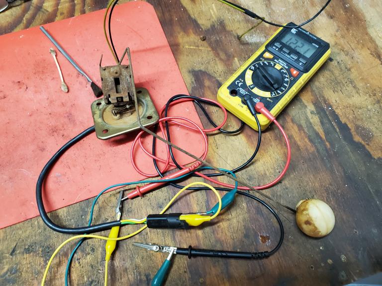

While I'm waiting on the folks in Idaho to resurrect my old fuel injectors and for my other parts order to be delivered, I figured I should revisit that crusty "fuel level" sending unit. I drained the tank and removed the old unit.
Like I said...pretty crusty. I also just learned that these pictures should be taken in landscape to orient properly when uploaded, too late now but you get the idea.
The rheostat was packed full of crud that I should have cleaned out prior to the initial installation, better late than never. I went to town with a small brush, swabs and contact cleaner (I've read a lot about Deoxit here, is it really worth the price premium over standard contact cleaner?). I got it as clean as I could before hooking up the multimeter.
* Resistance.jpg (92.78 kB . 768x576 - viewed 2217 times)
The rheostat showed open for the entire sweep until it hit the bottom stop where it read about 122 ohms. If this was a real sending unit paired with an actual fuel level gauge then I'd be suspect, but this only operates a warning light so why there's even a rheostat is beyond me. I have no clue what the actual readout should be but it's not working like a proper potentiometer. In order to really clean this thing I'll have to take it apart, which involves bending four metal tabs that I hope don't break.
* 20241230_172226.jpg (30.27 kB . 768x576 - viewed 2317 times)
Success, and not surprisingly I had a bit more cleaning to do.
Of course being a BMW it isn't wired like a typical rheostat either, this uses an unusual (to me) dual-wiper design that slides across both the wire coil and an adjacent metal plate, completing the circuit between the two and creating the variable resistance. The plate indicated open to both wires which isn't good, and the only way to get back there was to remove the phenolic plate with the wire coil. That's when I decided I can live without a low-fuel light for awhile, it's easy enough to get to this part as long as the tank is empty so this concern will get shelved for now.

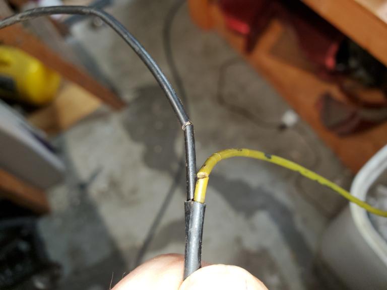

What is of bigger concern is the fuel pump wires, upon a closer examination the insulation is in pretty bad shape and cracks easily.
* Fuel Pump Wires.jpg (31.12 kB . 768x576 - viewed 2215 times)
Of course this requires special wire meant to be submerged in fuel, so there's another part I'm waiting on. Par for the course on a project like this.

The reason for being able to measure the level is for when the optional extra fuel level gauge is chosen.
I don't like the kink in the hose, it's too much. Maybe it could be routed differently. It might get worse on a hot day. You can also get external coils to eliminate kinks.

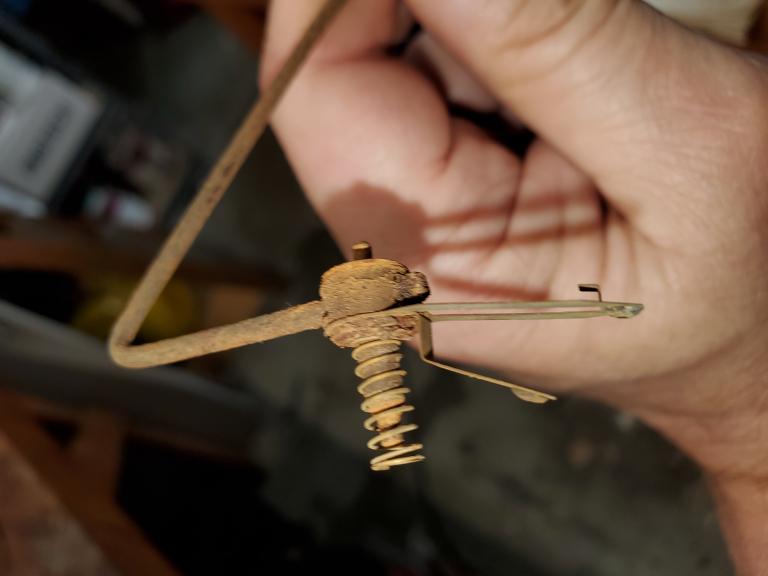

Well this sucks...
* Dammit.jpg (38.15 kB . 768x576 - viewed 2813 times)
Not the best picture, but that was the terminal on the fuel level sender where the positive wire for the fuel pump is supposed to attach. I was trying to solder on the new wire when it snapped off with just the slightest touch from my soldering iron. I guess it's a good thing, glass half full and all, that it broke now and not inside of a full tank of gas sometime down the road (literally). I've been researching the many posts here with clever alternatives to this notorious bit of kit, which certainly have my interest considering replacement options. EME has the only aftermarket offering, and at $270 each they obviously know it. Worse comes to worst I'll pry my wallet open, but only as a last resort. I normally wouldn't mind not having a functional fuel warning light, but unfortunately the knob for the trip odometer broke off at some point and not being able to reset the miles between fill-ups is problematic.
Oh well, fortunately I'll have some distractions soon. The seals for the brake calipers will be here tomorrow along with a new air filter. I already reinstalled the airbox with a new elbow, refitting the airflow sensor into the upper half of the airbox was a bit tricky but it's all back together and hopefully for good. I was able to re-route my custom "preformed" fuel return line so the kink at the tank is mostly gone, and best of all the fuel injectors are on the way back from Idaho (thanks Mr. Injector!) and will be here in 4 days. Once all that's back together the engine should be ready to run for the first time in 30 years...if only I had some fuel pressure.
I'm still doing a deep dive on my options, I'm impressed by the creativity many of you have on alternatives to this troublesome issue. I wish I had waited on messing with those wires until after I had the engine up and running but too late now. If anyone has any additional advice on this I'd greatly appreciate it.
