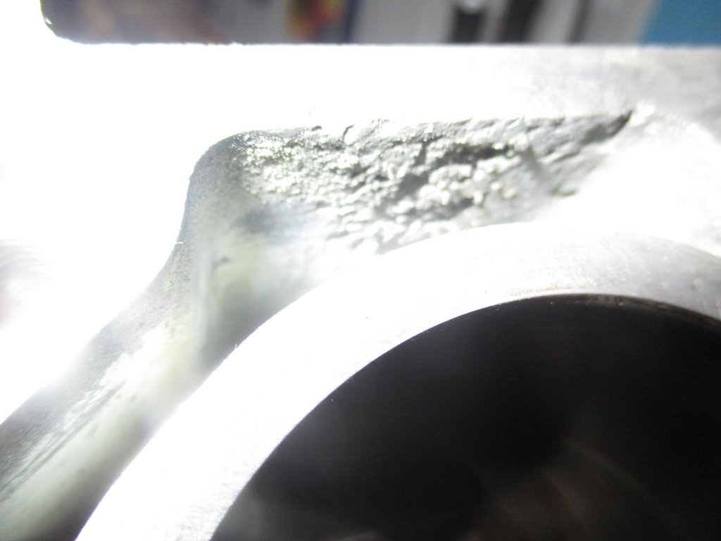

little work with grinding tool and hole shows

to close the hole welding job was outsorced

that in turn required machining of the contact surface

you may be interested how corrosion looked from inside. Here it is:

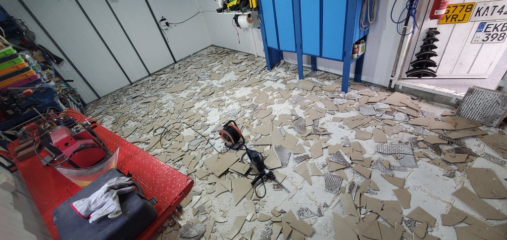

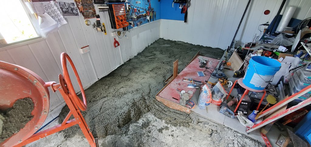

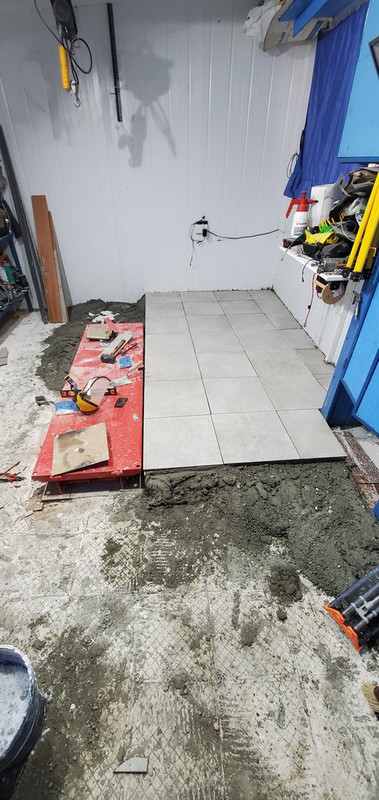

i did not like how my recently purchased heavy lifter table occupy the middle of workshop, preventing normal walking when no bike installed. It also required fixing to the floor, otherwise it was impossible to get bike rolled on it. Also, my floor originally was inclined - did not create problems before table appeared.
So these issues called for little side project, while waiting spares.
workshop was emptied and tiles removed
position marked and base installed
  • Cyprus
  • 1989 K75, 1989 K1, 2008 K1200GT
Offline koshak
  • Posts: 144
Re: 1989 K75 reanimation

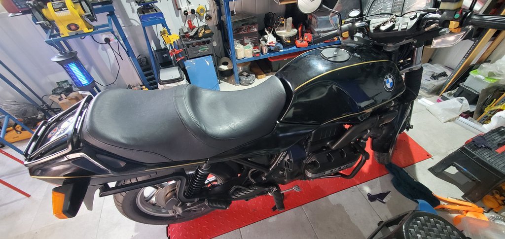

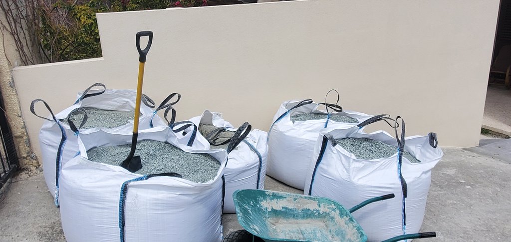

« Reply #156 on: May 28, 2021, 05:33:59 AM »
after table placed on the base, floor around was raised
spare parts for the floor upgrade:

  • Cyprus

« Reply #158 on: May 28, 2021, 05:45:02 AM »
pros:
- very easy rolling in/out
- comfort in the workshop when no bike on the table
cons:
- lost in max table height about 20 cm (however during later use did not find it as inconvenient)
  • Cyprus

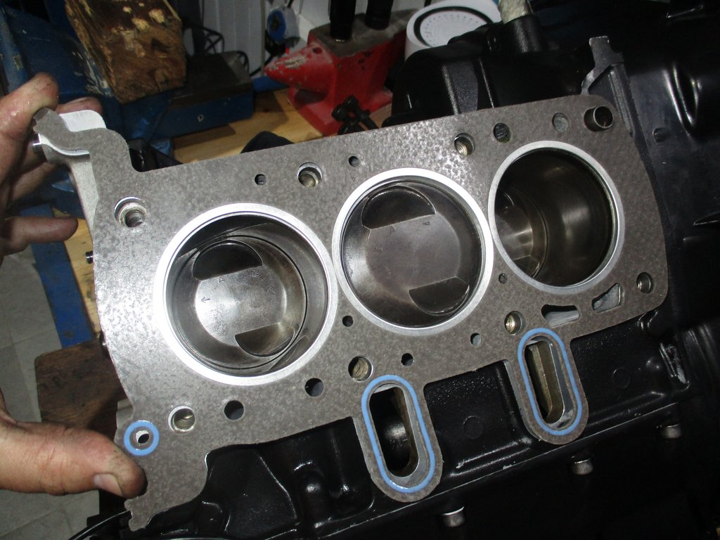

new gasket
