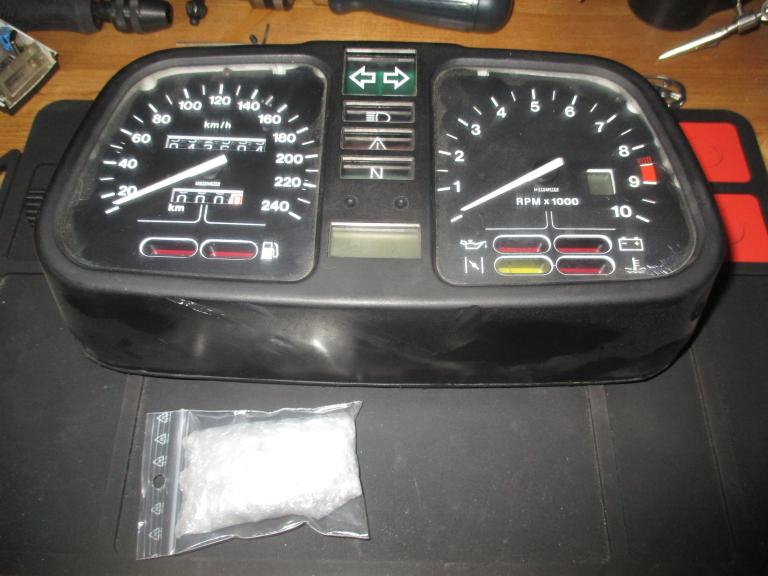

Hello, people.
While riding my lovely K75, recently noticed that the counter of the pleasure kilometers just stuck... No increments.
Well, thoughts immediately came to the broken plastic gears.  :idunno:
And again, as usual, Thom from kpartsholland.com is here for help. See that little packet?  :lets-eat:

Well, here is actually not much to write...
I never had any issues with the stuff supplied by Thom. And here is again. Plug n play.
Instead of brittle plastic gear, nice aluminum gears.

So, need to open the dashboard, replace damaged gear with a new one.
