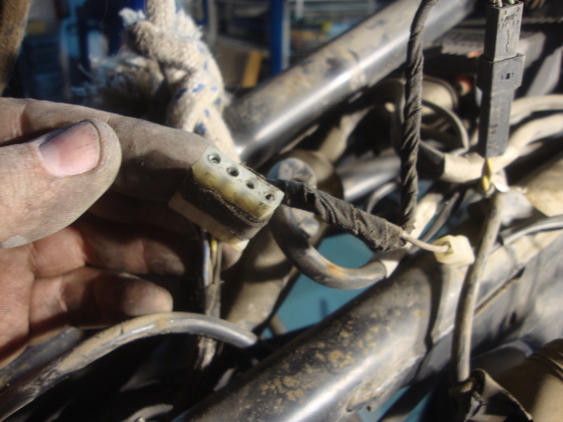

stripping continued
such funny relays used
alternator and starter are asking for a polish
traces of leakages in front of engine
thick layer of petrified grease
condition of alternator terminals, do not think there would be any circuit
some empty connector. What is that?

  • traces of leakages in front of . . .—Replace radiator hoses. Remove, clean and test the coolant temperature sensor within the T-connection below the vertical hose.
  • some empty connector. What is that?—To identify a connector it will help to clean off the wires and identify the wire colors connected to it. It might be for the turn indicators and parking light.

  • why BMW did such dirt collector, which is not accessible at all when assembled?—BMW wasn't focused on sale to housemaids with this model.   :laughing4-giggles:
Looks like you need to put a couple cans of Deoxit on the shopping list.
