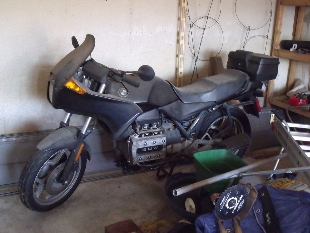

Hey guys, long time rider of many brands but never a bmw. I've always want a "brick" the right one finally fell into my lap today!
It's a 1987 k75s. I picked it up from the original owner. It has a tick over 20 thousand miles and has been sitting in the back of his garage for the last 20 years. It looked terrible and the clutch was locked up. After some rocking around and some proper cleaning it's starting to shape up quite well and I'm happy she's on the mend.
 Hopefully I'll have time on Sunday to finish cleaning and get it running. I plan to have the injectors cleaned, complete fluid flush, lube the drive splines, and give the electrics a solid once over. Any other suggestions on things to look at for on a barn find?
Here's a few pics of the retrieval and revival!

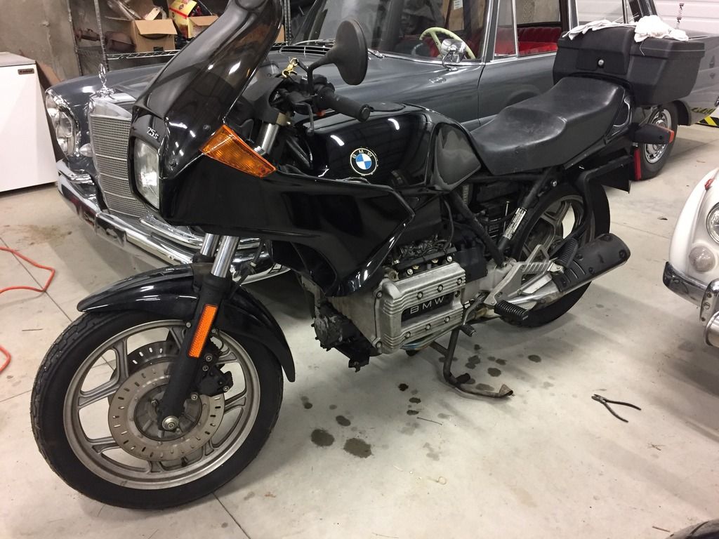

Welcome!  Your "new" brick certainly photographs well.
I would keep a close eye on the rear brake master cylinder.  You could have a lot of crystallized brake fluid in there that will tear up the seals and make it leak and not build good brake pressure.  With 20 year old brake fluid, I also wouldn't be surprised it the cylinder bore is corroded as well.  Watch closely for brake fluid leaks.

Thank you. I am not sure what the Vin number is , I will get it when I go back up to the shop on Sunday. I didn't know earlier black bikes were rare. This one is definitely a time capsule that still has all the original tools,manuals, cases, and parts.
That car you see is an old Fiat 500 that was in a car fire. We are restoring it now and it's nicknamed the toasted marshmallow

Ahh, that fits.  I was thinking more exotic, Lancia or something.  There was just another post here by a fellow putting a K75 engine in a '65 Fiat 500.  Small world. http://www.motobrick.com/index.php/topic,9245.msg73937.html#msg73937
