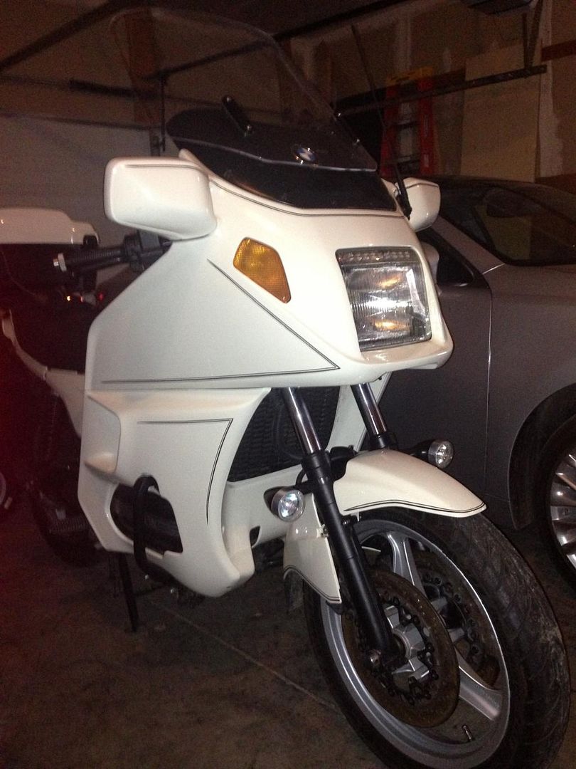

Today was the start of the meet'n greet with Heinz (my '86 K100RT - 61k miles- newly acquired). Lower fairings off, gas tank and seat off, bags off, windscreen off. Had to drop the oil pan to get the damn oil filter off. Took everything I had with a pinch-type oil filter wrench. Not sure it's ever been off! The gasket was bone-dry. The oil looked like bunker B. The gas tank got the major clean - much needed. Chris Harris said to be sure to clean behind the fuel pump when pulling the fuel filter also...snapped the damn tip off the fuel pump whilst removing the fuel line. Yikes. The gas filter is dated 1986! Who needs new filters?? I'm guessing the air filter is same. I pulled it and it actually looks pretty good....plenty of light coming through. Coolant change will be next...tranny and final drive oil also. I'll need fork seals, too. I really appreciate what I'm seeing in terms of quality parts and manufacturing. They put in some good stuff! Tires and battery, too. All pooched - bike is 28 years old, after all.
My 2004 Kawi Concours sits in pristine condition (under a cover) beside the Beemer. That U-Haul trip from Trenton to Hamilton in a snow storm left her pretty salty. Bike was pretty dusty already.
Looks like Heinz spent some time State-side, too. I think the PO did some tech work in North Carolina.
I'll post further as things progress.

Offline kris
  • Posts: 590
« Reply #1316 on: January 31, 2015, 11:04:56 PM »
This is up-to-the minute. Beautiful even stripped down!! What a piece of work.
"I got bike fever bad!!"
