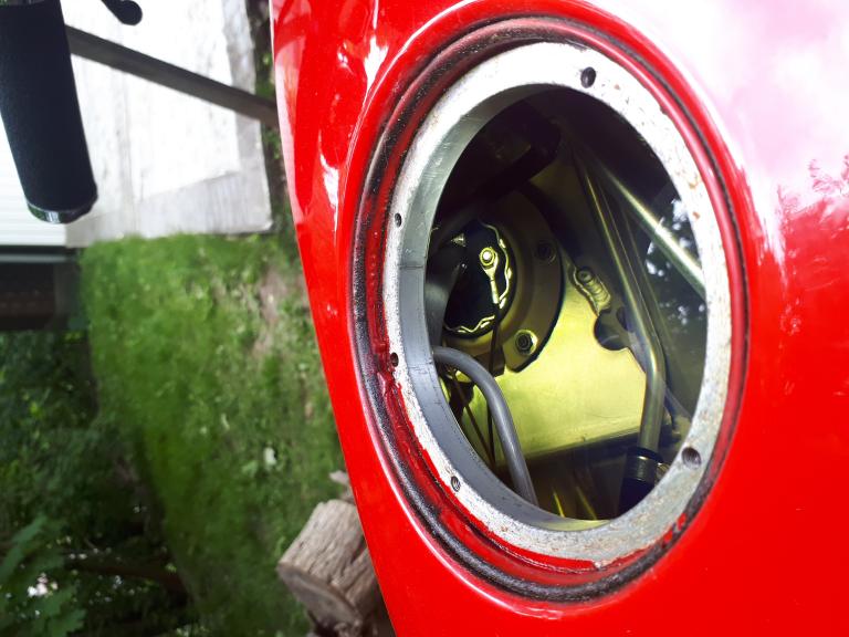

Hi, cleaned the frame ground.
* 20220605_131457.jpg (62.05 kB . 768x576 - viewed 881 times)
Cleaned the tank/pump connector and found the top left
connector was a bit brown looking.
Replaced the spark plugs and wires. The plugs had 0.038 to 0.040 gap.
Old wires.
Picture of pump. Used a screw driver to see if I could move
the connected wires. No movement at all. Will change filter
when tank is almost empty.
Cleaned the battery connections and ground to transmission.
Bike started and ran ok as I worked through these repairs.
To see that I didn't cause any other problems along the way.
Will have to go on a long ride hopefully this week.
Thanks Jethroww

* Screenshot_20220610-211047_Gallery.jpg (28.37 kB . 324x576 - viewed 805 times)
* Screenshot_20220610-211034_Gallery.jpg (19.89 kB . 324x576 - viewed 755 times)
I also found this under the tank. Any idea what it's for?
* Screenshot_20220610-211256_Gallery.jpg (14.15 kB . 324x576 - viewed 803 times)
