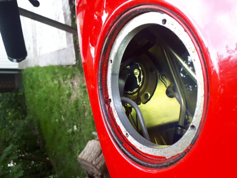

Hi, cleaned the frame ground.
* 20220605_131457.jpg (62.05 kB . 768x576 - viewed 674 times)
Cleaned the tank/pump connector and found the top left
connector was a bit brown looking.
Replaced the spark plugs and wires. The plugs had 0.038 to 0.040 gap.
Old wires.
Picture of pump. Used a screw driver to see if I could move
the connected wires. No movement at all. Will change filter
when tank is almost empty.
Cleaned the battery connections and ground to transmission.
Bike started and ran ok as I worked through these repairs.
To see that I didn't cause any other problems along the way.
Will have to go on a long ride hopefully this week.
Thanks Jethroww

  • Posts: 11299
Re: Just stops running
« Reply #11 on: June 05, 2022, 08:27:18 PM »
Will change filter when tank is almost empty.
Why wait? Use one of these to empty the tank fuel into a fuel can temporarily any time you want to get in there.
Your fuel pump's position is hanging low in the vibration damper; it should be similar in position to the one in the photo below if its an OEM pump. Verify that it is not loose. I encountered one that was bottoming out on the floor of the tank, its filter basket was damaged and the mess was causing fuel intake restriction. View what you've got in there.

Offline Jethroww
  • Posts: 102
« Reply #14 on: June 09, 2022, 04:13:18 AM »
Hi, changed the fuel filter another Carquest #86032 . Pulled the pump and everything
was tight.  Noticed the pump filter was not seating properly on the vibration damper.
Removed the pump and installed the screen properly.  Matched the 2 pump  groves
with the 2 in the damper. Was on a slight angle before. The pump screen has a smash
rip on the part that sits against the pump. The damper felt a bit rubbery/soft. Is that normal?
Should it be replaced? What would be a good place to get the parts?
Euro Motoelectrics, beemerboneyard? Here is a picture of the pump as found in the bike.
* Screenshot_20220609-040558_Gallery.jpg (29.93 kB . 324x576 - viewed 667 times)
* Screenshot_20220609-040629_Gallery.jpg (32.07 kB . 324x576 - viewed 642 times)
Will take it for a long ride and see if I fixed the problem.  Will order parts after some
suggestions on a good quality part/suppliers.
Thanks Jethroww

  • Posts: 11299
« Reply #15 on: June 09, 2022, 09:37:51 AM »
Does the yellow arrow point at sludge accumulation inside or outside that filter basket?  Replace it anyway because it looks like hell. If you rub the damper with your fingers will you get black residue on them? Regardless, my inclination from this distance would be to replace both the damper and the filter with Euro Motoelectrics stock. Is the fuel tank interior relatively clean or does it have floaters and a gooey patina on part of its surface?
  • 1995 K75 89,000 miles

  • Posts: 102
« Reply #16 on: June 09, 2022, 12:28:19 PM »
Hi Laitch,  almost all was on the outside.  Just a bit on the inside  I think it was slowly making it's way through the screen.
I don't know what it was. I ran water from a garden watering jug back through the screen and it cleaned up. I've been
driving it for 5 years now and this is the first time I have taken the pump out. The inside of the tank is spotless silver
color. Will order the parts and hopefully continue driving the bike until I get them
Thanks Jethroww
