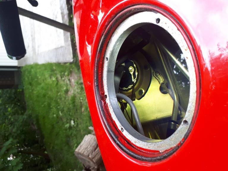

Cleaned the tank/pump connector and found the top left
connector was a bit brown looking.
Replaced the spark plugs and wires. The plugs had 0.038 to 0.040 gap.
Old wires.
Picture of pump. Used a screw driver to see if I could move
the connected wires. No movement at all. Will change filter
when tank is almost empty.

  • Posts: 11653
Re: Just stops running
« Reply #11 on: June 05, 2022, 08:27:18 PM »
Will change filter when tank is almost empty.
Why wait? Use one of these to empty the tank fuel into a fuel can temporarily any time you want to get in there.
Your fuel pump's position is hanging low in the vibration damper; it should be similar in position to the one in the photo below if its an OEM pump. Verify that it is not loose. I encountered one that was bottoming out on the floor of the tank, its filter basket was damaged and the mess was causing fuel intake restriction. View what you've got in there.

Offline Jethroww
  • Posts: 106
« Reply #14 on: June 09, 2022, 04:13:18 AM »
Hi, changed the fuel filter another Carquest #86032 . Pulled the pump and everything
was tight.  Noticed the pump filter was not seating properly on the vibration damper.
Removed the pump and installed the screen properly.  Matched the 2 pump  groves
with the 2 in the damper. Was on a slight angle before. The pump screen has a smash
rip on the part that sits against the pump. The damper felt a bit rubbery/soft. Is that normal?
Should it be replaced? What would be a good place to get the parts?
Euro Motoelectrics, beemerboneyard? Here is a picture of the pump as found in the bike.

Hi. Just opened my fuel filter.  Hear are some pictures.
* 20220611_201255.jpg (66.64 kB . 768x576 - viewed 1061 times)
* 20220611_201326.jpg (52.15 kB . 768x576 - viewed 1052 times)
* 20220611_201403.jpg (40.87 kB . 768x576 - viewed 1009 times)
As mentioned many times before  "change the fuel filter every year".
Thanks Jethroww
« Reply #19 on: June 11, 2022, 10:02:14 PM »
You don't need to cut a fuel filter apart to tell how clogged it is.  Just pull it out and try to blow through it in the direction of the arrow. If there's resistance then it should be replaced.

Hi, the other reason I cut open the filter was to see what was inside. It looked black. I am wondering
if that is the damper slowly breaking apart.
Just informed by Euro Motoelectrics  that the damper I ordered they don't have in stock
 Laitch as you recommend Euro Motoelectrics and I can't get it from them. Would
beamerboneyard be the next best place to get one?
Thanks Jethroww
