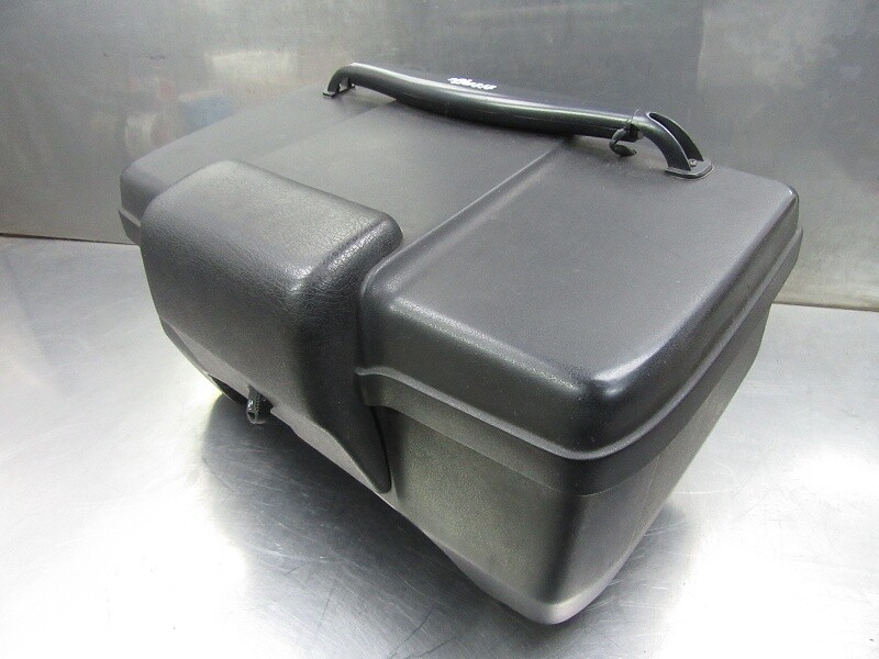

Also, some time ago ordered original top box, and it is already arrived, will try to pick it from the post today. But it is without mounting plate. How is this plate looking? Easy to fabricate, or need to search original part?
This is the box:

Clearly, you know how to make your way through a mechanical labyrinth, koshak.  112350 That's good progress.
  • The venting hose from filter cracked and broken in parts. Should its second side be connected to that breathing pipe near opening?—Yes. Submersible, fuel-resistant hose suitable for venting is all that's needed.
  • . . .some time ago ordered original top box but it is without mounting plate. How is this plate looking? Easy to fabricate, or need to search original part?—You need to search for both the plate and the mounting pin shown in the photo that attaches the box to the plate although you seem resourceful enough to fabricate a substitute. I haven't read of anyone doing that with the 22 L top case.

A future project at the Trades Guild for me was to look at making the retaining plates and pins. It is doable but whether there is enough of a call for them and how much time and effort is needed. Too many projects at the moment, however I'll have a talk to my engineering mate and see if it's viable.
Re: 1989 K75 reanimation
« Reply #39 on: February 25, 2020, 05:50:17 PM »
The kit for mounting the iconic 22 liter case is actually only $85 which is less than the plate alone.
P/N  46 54 2 316 755  Set, mounting parts
By BMW standards, the price is a real deal.

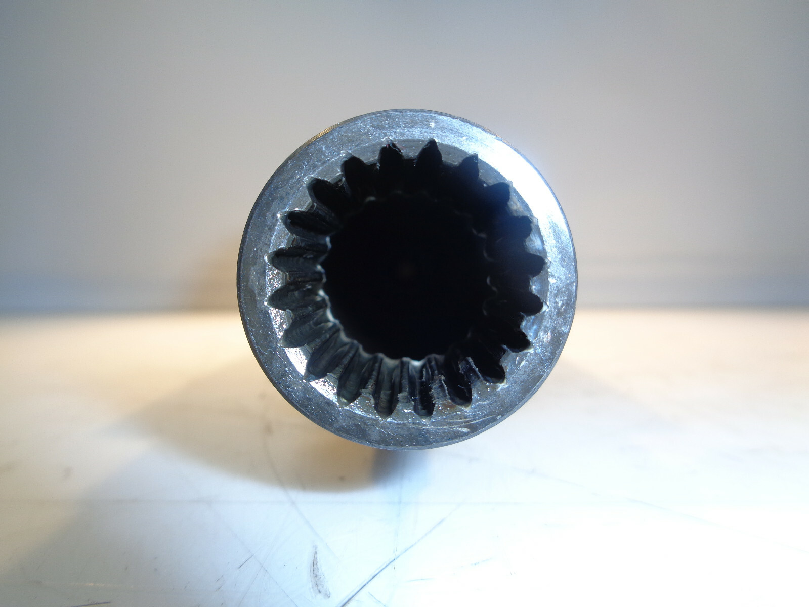

Have the question. I am in search of driveshaft. New one seems to be available, but costly. Will go for it, if not find alternative.
Here is the photo of one used, from ebay. What can you say about splines? look much better than mine, but shows overheating signs (? how it can be just in one section, not at whole?) at about 5 o'clock, and some wear already started.

If we number the topmost spline as 20 and the one to the right of it as 1, continue numbering clockwise then take a photo of splines 6, 7, 8, and 9 with increased lighting. As it looks now, I'd be happy to use it in my moto, or sell it to somebody.  :laughing4-giggles:
Offline koshak
  • Posts: 144
« Reply #44 on: March 01, 2020, 03:25:21 PM »
Cannot, it is available photo from ebay.
