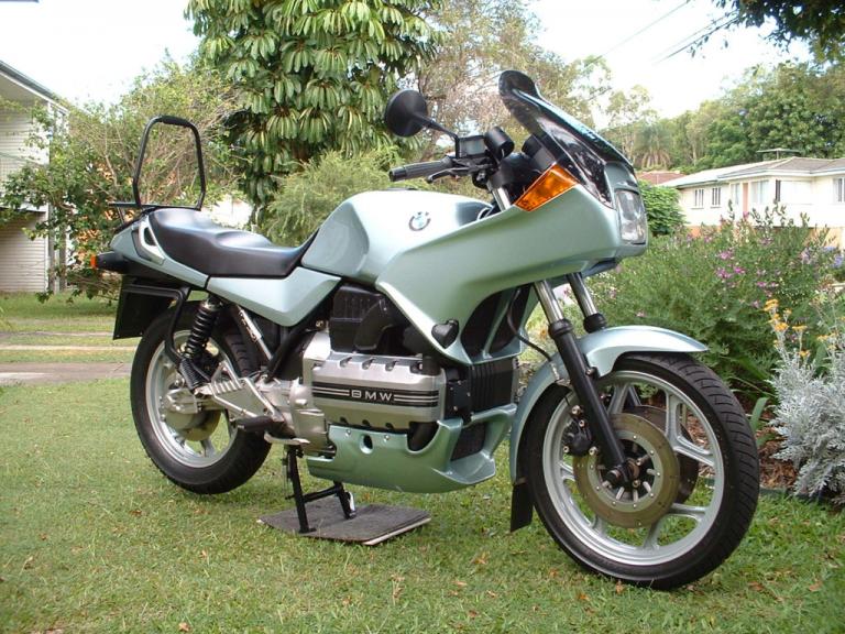

Bob to cheer you up a piccie of a K100S. Dream and you can sometimes make it so.
* BMW K100s 2.jpg (107.4 kB . 768x576 - viewed 1886 times)
Thank you for the motivation, Martin.  That's actually the color I had in mind!
