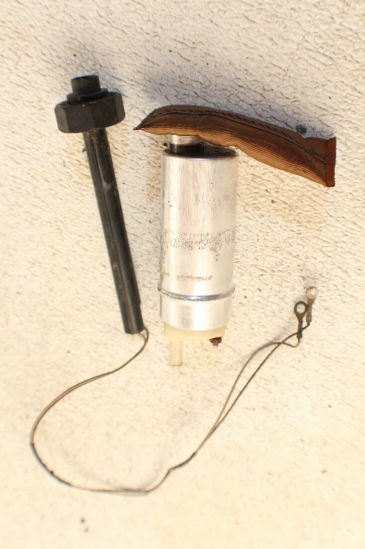

Was on my way to work, first (7L?) fuel warning light had been on.  Started hearing a clicking sound from around the tank.  Thought it was the engine.  drove a bit further.  Suddenly started losing power... luckily it was right in front of a gas station so I rolled in.  Filled up.  Sound was gone.  So I figured the 4L (or whatever it is) bulb was burnt out.  Bought a set of LED replacement bulbs for everything in the cluster from someone on one of the forums.  Turns out the fuel warning bulbs are yellow and red.  So what I thought was the first warning light was probably actually the second and final warning light.  I have yet to verify both bulbs work... haven't run the fuel down far enough but probably should so see if the yellow light ever comes on.
Don't worry about the invalid tag. As I hope you have already figured out, the photos will get posted anyway and be seen.
The noise might have been return line check valve ball vibrating from air pressure when the fuel flow stopped.

Thanks Laitch!  Would that have been brought about by the low fuel level?  It hasn't made that noise since that last fill and I've never had it that low in fuel since either.
That is indeed what I was implying; furthermore, that assembly can start rattling under any condition. Many riders have removed them when that happens. Maybe the previous owner already removed it and the buzz was from something else. Anyway, the later models didn't need a check valve to prevent fuel spill when the return line was disconnected. The return line extended to the tank's ceiling and returning fuel dropped into the tank from there.

Go about tank removal carefully.
The thermistor type fuel level sender is no longer available and rare as hens teeth on the interwebs.
Round connector ends power the fuel pump.
The photos are from DJEwen's '85 build  http://www.motobrick.com/index.php/topic,10875.375.html
http://www.motobrick.com/index.php/topic,12340.0.html
This pic is from the web shows a newer 43mm diameter fuel pump with sock strainer as opposed to the older 52mm pump
Good Luck with your moto
Yup, that's exactly what mine looks like.  Thank you for sharing that!
Good to know replacing that sender may be an issue if it goes bad.  So far, at least, I know it partially works.  I'll let this next tank run down until the red (4L?) warning light comes on.  Hopefully the yellow bulb was broken before I replaced it so that it'll light before the red.
And thanks for the link to that other build... I'll spend some time looking thru that.  It's a good looking ride!

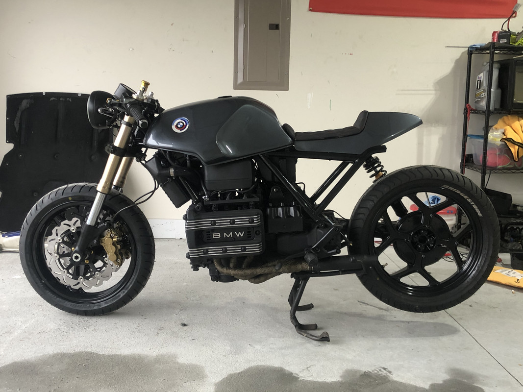

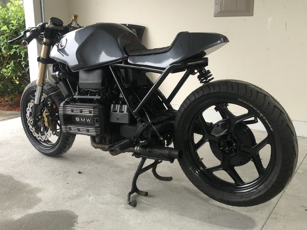

It's been a while since I posted.  Been enjoying the bike!
After many hours looking at pics on the internet, I've come to really like the classic look for the old K bikes.  In particular, the RS.  There's something about the squared off fairing that appeals to me.  So I've been looking around on what it would take to add that fairing to my bike.  Lots of parts on ebay but I'm sure there are a million little parts that I would need to pull this off that aren't as obvious as the fairing pieces themselves.  Just so happens I stumble across this '85 RS that some guy on Facebook was selling for pretty cheap.  So I figured if I could get the whole bike cheaper than what the fairing parts would cost me, I'd be that much further ahead.  Plus I'll know where alll the parts go and how they're held together.  Made the guy an offer and got the bike (delivered) for $300.  The bike itself sat for years and isn't in the greatest of shape.  It had the fuel pump pulled to get another bike going.  So here she sits...  not at my house yet but hopefully this week.  My tentative plan is to swap the fairing over since my bike runs and runs well.
* IMG_1488.jpg (78.76 kB . 439x576 - viewed 2171 times)
* IMG_1489.jpg (76.41 kB . 448x576 - viewed 2081 times)
