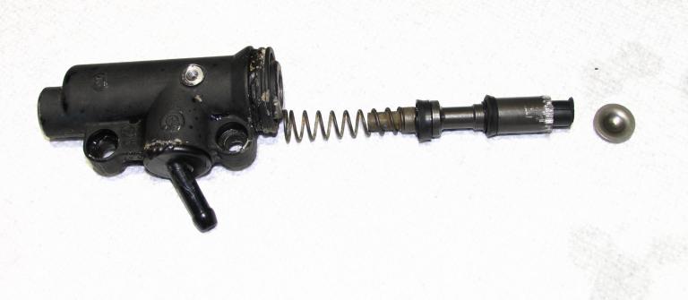

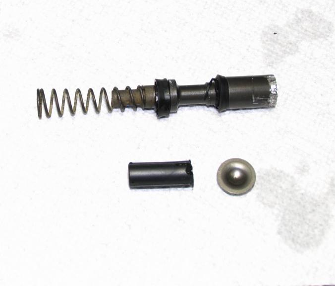

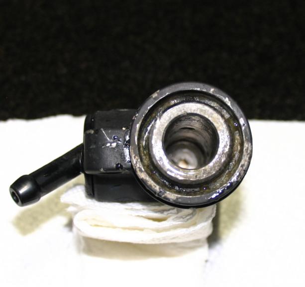

If the master cylinder is off of the bike and disconnected from the brake line, you can dissolve the crystallized brake fluid by a short soak in hot water.  After the parts separate, dry them off and blow any remaining water off with compressed air.
I soaked the parts in soapy hot water but nothing was coming apart. I ended up putting the housing in a vice and clamping a channel lock plier onto the plunger end and turning. After much marring and trying to twist it finally started to turn and I could hear the spring turning but it took some twisting and tapping the pliers for it to come out. the inside of the cylinder looks clean but hard to tell.  I am soaking for a while the see if it will clean up.
The plunger/spring looks good except the tip where the pliers scraped it up. How does it go back in though? does the other end where the hose screws in come out?
I think I have four options; get the retro fit from China, Buy the rebuild kit for $67, buy a whole new master cylinder assembly from MAX for $152, or try to reuse what I have.
Now that I am looking at the photos, the MC doesn't look to be in good condition so may have to go the Chinese or new OEM route:

Marred up tip. Not good. Little plate on the end of the plunger insert came off.
* fullsizeoutput_3835.jpeg (26.94 kB . 676x576 - viewed 1216 times)
Is inserting to the left the only way for this to go in? The taper on the plunger bushings is against the grain.
* fullsizeoutput_3834.jpeg (19.43 kB . 768x335 - viewed 1167 times)

A moment of clarity has revealed to me that for a brake cylinder to be a master cylinder, it must control a slave cylinder. These motos only have one front brake cylinder and one rear brake cylinder.
Anyway, your rear brake cylinder parts are junk when viewed from where I sit on the porch of The Ridley Brook Butterfly and Hummingbird Preserve Gun Club. I recommend replacing the entire rear brake cylinder assembly and also replacing the brake fluid reservoir with a cylindrical container that can hang on a frame member beneath the right side cover away from the effects of sunlight on its integrity.
Those suggestions sound wise and in line with what I am planning. Thanks

Received the master rear cylinder rebuild kit. The cylinder bore cleaned up nicely with 0000 steel wool so I went ahead and ordered the kit. Also have the calipers off so will check all of them and bleed the brakes when I get back from Maine on the 28th.

Old cylinder parts
* fullsizeoutput_3882.jpeg (48.09 kB . 676x576 - viewed 1118 times)
