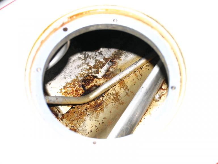

Here's a shot of the inside after spending about an hour just trying to get the particles out, using gasoline and rags. I scoured this one area with a 3M Scotchbright pad. After the tank dries out I am planning on using the two bottles of white vinegar I saw posted here. Will inform of the results with that.
* IMG_0019.JPG (41.71 kB . 768x576 - viewed 2706 times)

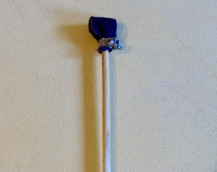

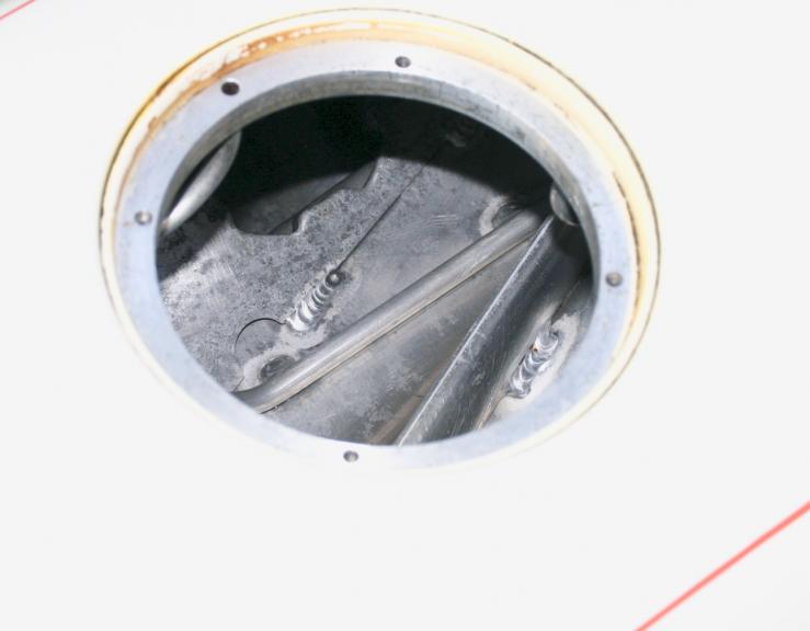

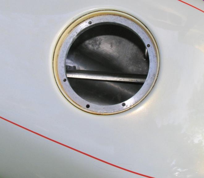

Well, I am totally thrilled with the vinegar outcome! Thank you Gryphon for the suggestion. I suppose the grime in the tank is a type of varnish left by the sitting gas and is not as hard to dissolve as it looks. I used (2) one gallon bottles of white vinegar and only let it sit 24 hours. I capped the fuel supply tube with left over rubber fuel hose so the vinegar wouldn't leak out. I cut the float arm and sensor device off the fuel gauge mounting plate and scewed the plate and old gasket back on to seal the bottom of the tank. Today, after the tank sitting for 24 hours in vinegar, I came home and made up a little scrubbing device from a 2' piece of 1/4" dowel with a piece of scotchbright pad attached to the end via one of the hose clamps. With the dowel I didn't have to worry about scratching the tank. I got into most of the nooks and crannys and was able to scub down the sides pretty well. Siphoned off the vinegar and rinsed the tank with the garden hose jet spray (that worked really well). Now the tank is drying out for a final vacuum tomorrow.
Here's the scrubbing device.
* fullsizeoutput_37e3.jpeg (52.12 kB . 726x576 - viewed 2700 times)
Before and after.
* IMG_0019.JPG (41.71 kB . 768x576 - viewed 2629 times)
* fullsizeoutput_37e5.jpeg (29.89 kB . 739x576 - viewed 2554 times)
Two more angles.
* fullsizeoutput_37e4.jpeg (28.59 kB . 660x576 - viewed 2644 times)
* fullsizeoutput_37e6.jpeg (22.92 kB . 768x576 - viewed 2635 times)

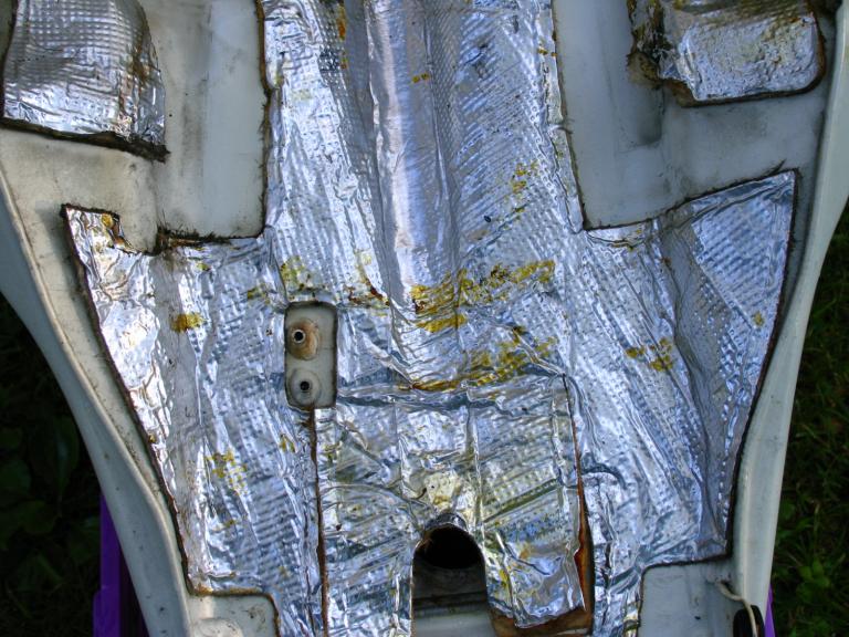

Here is a shot of the damping material on the tank bottom. It looks in good shape so I don't plan on replacing it.
* IMG_0010.JPG (96.19 kB . 768x576 - viewed 2607 times)

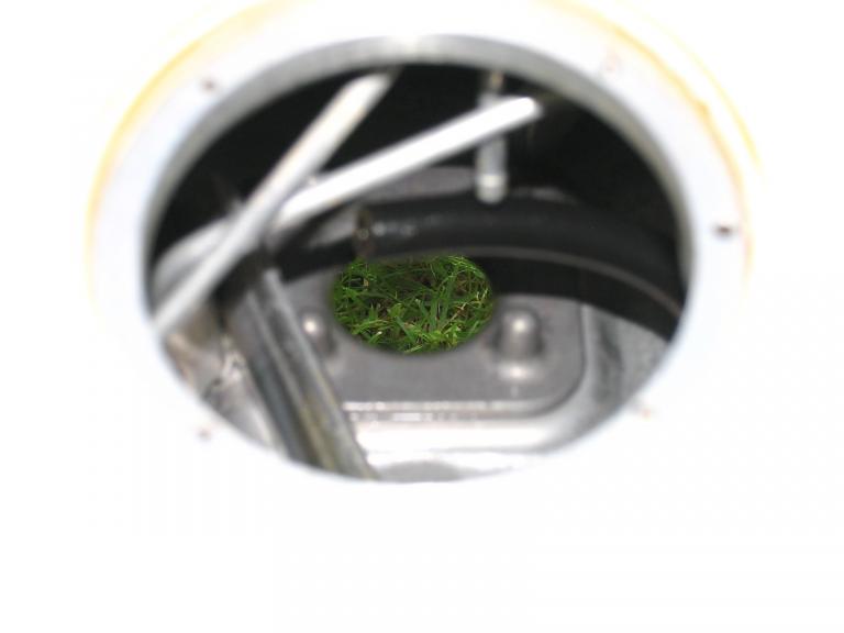

I'd kill off that grass in there, too.
That is insulation—not damping material—to reduce engine heat transfer into the fuel tank. It can be renewed at relatively little cost with material like Reflectix and its effect improved on the RT and RS models by being installed as a johnny blanket.
No, It's necessary for the green fuel movement.  :giggles
