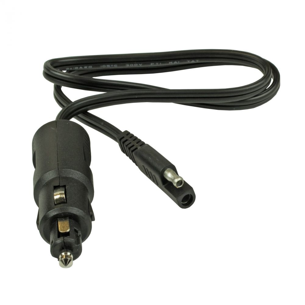

Plug your battery charger into it if it has the Hella or Powerlet BMW type male end connector
It looks like from the diagram that there are leads with ring connectors at the end. These go on the + and - battery posts? they are not on there now. There is a battery tender SAE plug connected to the battery but that's it.
This Merit plug can also be used in reverse, to charge or tend the battery? You would need the charger lead to have the Hella or Powerlet BMW type male end connector?
I have not seen a charger with that type male plug, only the SAE type.
https://touratech-usa.com/Store/Standard-BMW-Plug
Thanks for the link and PDF Volador. $12 is not bad for the 030-0111 plug. I guess I would have to cut off the SAE plug from the charger and screw the leads on the Hella plug.
Do any chargers come with the Hella or BMW Powerlet plug?
SAE to BMW plug
https://www.batterymart.com/p-mb-map-motobatt-sae-to-din-adapter-cable.html?gclid=EAIaIQobChMIr-68_ojq5QIVibWzCh0-QAPjEAQYASABEgKKX_D_BwE

This is what I use.  Be aware that although they have worked well for me, the low price probably means it will set fire to your bike and make your hair fall out.  Other posters here will confirm this warning and advise you to spend more money.
https://www.ebay.com/itm/Fits-Hella-BMW-Powerlet-Motorcycle-Automatic-Smart-Battery-12-V-Trickle-Charger/121917168976?hash=item1c62d45d50:g:xd4AAOSwu1VW3hcq

SAE to BMW plug
That is exactly what is needed. I think I will either get this, use the Merit socket with the Battery Tender Junior (750mA), or just use the Battery Tender Junior with the eyelet adaptor directly to the battery. Or just start the bike in the driveway once a month as Gryph says "Every couple weeks during the winter I'll go out and start them up, letting them run at fast idle with the transmission in first or second gear until the engine gets warm enough to cycle the fan.  This charges the battery, gets rid of the condensation in the crankcase oil, and circulates the oil in the transmission and final drive". Thanks

77 02 8 551 897 Removes the guessing with BMW male plug and additional battery connectors
Wow, $193 list for that? I think I'll stick with the battery tender junior. It will connect directly to that SAE to BMW DIN adaptor you showed me.
Hey, what's $193???  Isn't your peace of mond worth it?
