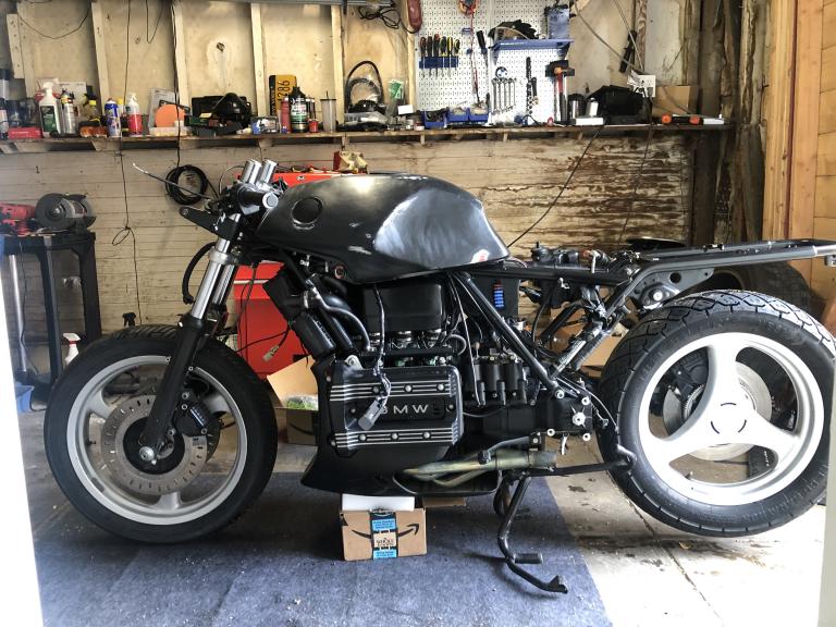

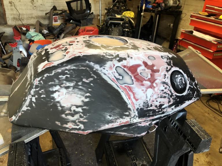

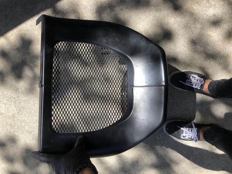

It's been quite a long road of trial and error.
Finally got a triple tree clamp created that will house my Motogadget Mini
Still on the way, custom short rear sets and really nice seat: https://bit.ly/2GyHziu
So far i've done the following:
- ABS Delete
- Custom SS front brake line
- Rewired the entire bike
- Fitting 7" headlight
- Custom throttle
- Lowering forks to accommodate my riding style
- Engine Tune (plugs, wires, timing)
- Land Rover Metallic Black on the gas tank
(will paint seat and lower faring same color... may do bedliner on the bottom of the faring as it's going to get some debris from rides)
- Ducati Monster 821 Hand Controls and Brake Master Cylinder
- LED Signals
- LED Circuit board bypass
- Rebuilt fuel tank (filter, pump, fuel level sensor, cleaning)
* IMG_9482 3.JPG (97.85 kB . 768x576 - viewed 2354 times)
* IMG_9486 2.JPG (87.4 kB . 768x576 - viewed 2267 times)
* E00BD357-B947-44C5-981B-0EA8D2649451.JPG (24.07 kB . 324x576 - viewed 2239 times)
* IMG_9497.JPG (74.7 kB . 768x576 - viewed 2283 times)
* IMG_9501.JPG (73.71 kB . 768x576 - viewed 2307 times)
* IMG_9502.JPG (84.89 kB . 768x576 - viewed 2290 times)
Still to come and looking for any suggestions:
- Deleting separating line in the bottom faring so it looks like one piece
- Muffler
- Painting forks
- Painting kickstand / Center Stand
- Shaft lube
- Tires
- Brakes
- Seat fitment
- Overflow tank relocation
- Lithium Batter Relocation (under seat)
- ECU relocation
- Ignition switch relocation
- First Ride :)

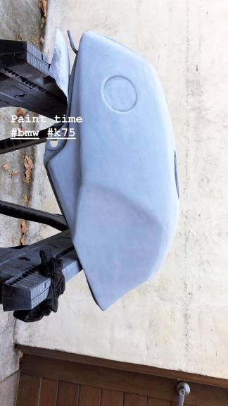

Now just wait for my paint delivery.
Fiberglassing the inside for more rigidity and taking care of some stress fractures.

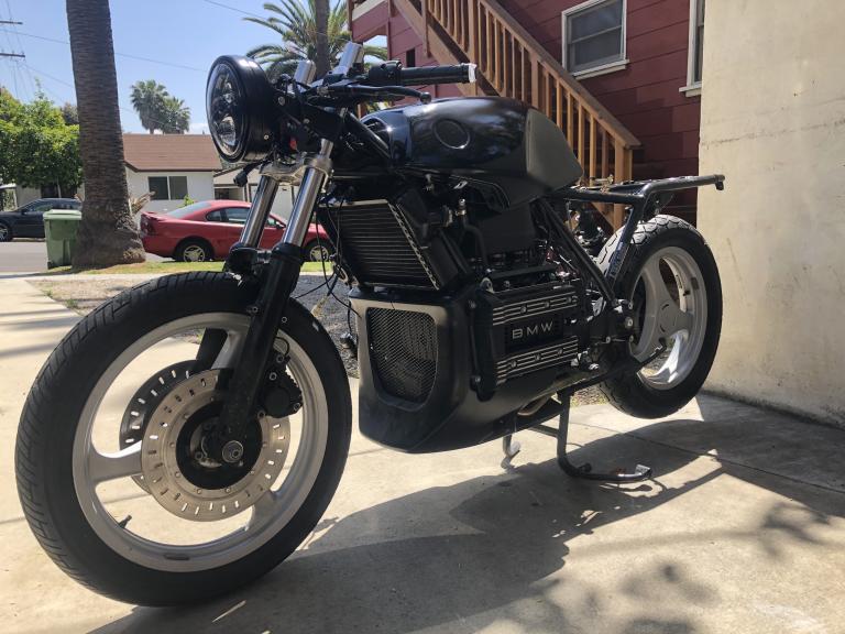

Plan on spending the next week thoroughly going through and finally finishing the build.
Over the bit of downtime I've had, I've relocated the Shorai battery, created a metal seatpan that I attached the ECU to, and doing some more cleanup with the overflow tank and rear brake reservoir.
Tidy'd up the front end, thread locked everything (blue), and wired up my motogadget motoscope mini, as well as some motogadget pin lights. Added additional side turn signals flush mounted into the holes on the tank as well.
Redid the entire fuel system (Sending unit, pump, filter, new bosch injectors) as well as the ignition system (plugs/wires)
Next up is getting the timing buttoned up, put the bottom flare back on, wire and mock up rear running/brake light and motogadget pin turn signals, trying out a minimal shorty style exhaust w the 30' k75 connecting pipe and take her on her maiden voyage.
* IMG-0632.JPG (52.36 kB . 768x576 - viewed 2024 times)
* IMG-0619.JPG (80.94 kB . 768x576 - viewed 2110 times)
* IMG-0626.JPG (34.93 kB . 768x576 - viewed 2066 times)
  • Los Angeles
  • 1991 K75s
Offline almostordinary
  • Posts: 76
Re: K75 - Starbucks Warrior build

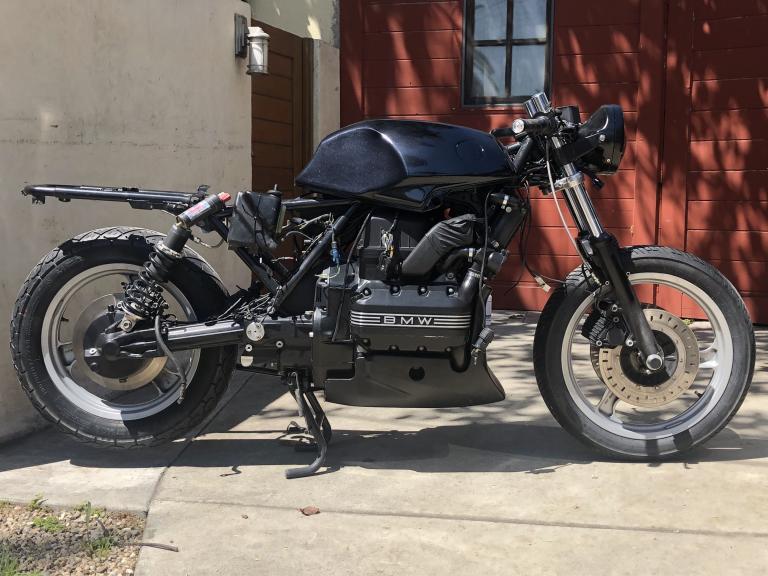

« Reply #20 on: August 18, 2019, 04:00:09 PM »
Finally been able to put some hours on the bike... just need to complete the seat and she's on the road for our first ride.
Thanks to the wealth of knowledge on this forum and a lot of trial and error she's almost there!

Looks great!
Nicely done.
I really like the belly pan, is that an original K100 RS belly pan?
I also like your exhaust but would worry about how loud it is, is there any silencing built in?
Cheers
  • Houston Texas
  • 1993 K1100RS
  • Posts: 76
« Reply #22 on: August 19, 2019, 11:31:45 AM »
Thanks! It’s the stock k75s belly pan. Really accentuates the lines.
The exhaust is a bit loud when the choke is open but quiet enough when the bike is warm.
Haven’t taken it out yet to see if it’s too loud, but there is some silencing built in. Not a ton though.
Hoping to get her out by weeks end and put some miles on the bike

That seat line really smooths out the lower angle on the tank that is usually out of place on these bikes.  Well done.  I wonder if you could mount the radiator cover from a k75 standard bike above the lower fairing.  Might look nice and give things more of a finished look there.   I like it.  The K75S, where the S stands for starbucks.
