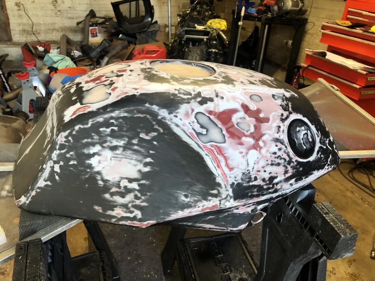

« Reply #7 on: April 22, 2019, 03:37:16 PM »
It's been quite a long road of trial and error.
Finally got a triple tree clamp created that will house my Motogadget Mini
Still on the way, custom short rear sets and really nice seat: https://bit.ly/2GyHziu
So far i've done the following:
- ABS Delete
- Custom SS front brake line
- Rewired the entire bike
- Fitting 7" headlight
- Custom throttle
- Lowering forks to accommodate my riding style
- Engine Tune (plugs, wires, timing)
- Land Rover Metallic Black on the gas tank
(will paint seat and lower faring same color... may do bedliner on the bottom of the faring as it's going to get some debris from rides)
- Ducati Monster 821 Hand Controls and Brake Master Cylinder
- LED Signals
- LED Circuit board bypass
- Rebuilt fuel tank (filter, pump, fuel level sensor, cleaning)
* IMG_9482 3.JPG (97.85 kB . 768x576 - viewed 1994 times)
* IMG_9486 2.JPG (87.4 kB . 768x576 - viewed 1945 times)
* E00BD357-B947-44C5-981B-0EA8D2649451.JPG (24.07 kB . 324x576 - viewed 1933 times)
* IMG_9497.JPG (74.7 kB . 768x576 - viewed 1957 times)
* IMG_9501.JPG (73.71 kB . 768x576 - viewed 1967 times)
* IMG_9502.JPG (84.89 kB . 768x576 - viewed 1954 times)
Still to come and looking for any suggestions:
- Deleting separating line in the bottom faring so it looks like one piece
- Muffler
- Painting forks
- Painting kickstand / Center Stand
- Shaft lube
- Tires
- Brakes
- Seat fitment
- Overflow tank relocation
- Lithium Batter Relocation (under seat)
- ECU relocation
- Ignition switch relocation
- First Ride :)
Really happy with my progress in between huge film projects and working on my Land Rovers.
Can't wait to get it out put some hours on the bike.
Getting close!

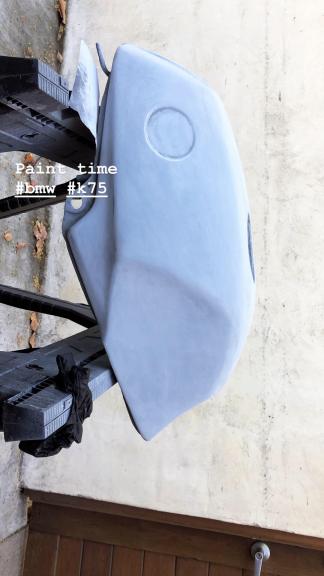

« Reply #8 on: April 22, 2019, 05:27:20 PM »
Now just wait for my paint delivery.
Fiberglassing the inside for more rigidity and taking care of some stress fractures.
* E0B39EE8-6859-4545-91CA-848B1DB07E26.jpeg (72.93 kB . 768x576 - viewed 1933 times)

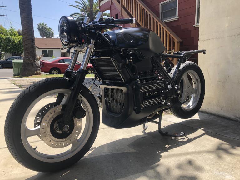

« Reply #9 on: May 31, 2019, 02:12:38 AM »
Quick update:
Bike is coming a long way, had to take some time down to work on one of my land rovers, but finally got to wrench on the bike today for a bit.
* k75s_May_30_19.jpg (75.8 kB . 768x576 - viewed 1964 times)
Up next:
- Revise new mount for 7" headlight
- Install Motogadget motoscope mini
- ECU mounting options
- Tires (Thinking Pirelli Angle GT2)
- Brakes
- Spline Lube
- Oil Change
- Exhaust
- Paint
- Wheel powder coating
- Seat Upholstery
- Front and rear signals
- Maiden Voyage
  • Los Angeles
  • 1991 K75s

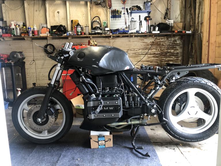

« Reply #12 on: June 06, 2019, 02:30:11 PM »
Had a chance to do some cleaning up as I wait for the last bits.
Decided to try a bronze color on the wheels, and think I am going to land on powder coated nardo grey. The lighter color does so much more for these wheels in my opinion.
Got my motogadget installed in my custom top clamp, adding a few warning LEDs to the headlight once my mounting brackets get in, hid my super loud new horn in the cowl.
I've ordered a Ducati ST4 starter choke control to add to the bars to replace the stock choke, hoping to install this weekend to give my thoughts on this upgrade since I've gone w a fully custom setup.
Need recos on Exhaust, I almost want a straight pipe w minimal muffling. Thoughts?
* 31A050DF-77E0-4325-813F-D1D3CCF334CF.JPG (70.58 kB . 768x576 - viewed 2134 times)
* IMG_0102.jpg (97.91 kB . 768x576 - viewed 2229 times)
* IMG_0111.jpg (48.04 kB . 432x576 - viewed 2194 times)
So close to getting her on the road!
  • Los Angeles
  • 1991 K75s

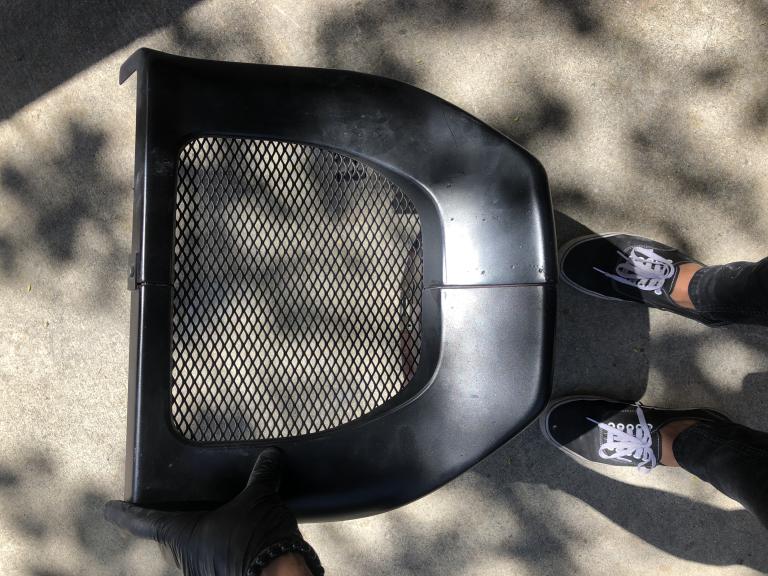

« Reply #19 on: August 08, 2019, 04:35:49 PM »
Plan on spending the next week thoroughly going through and finally finishing the build.
Over the bit of downtime I've had, I've relocated the Shorai battery, created a metal seatpan that I attached the ECU to, and doing some more cleanup with the overflow tank and rear brake reservoir.
Tidy'd up the front end, thread locked everything (blue), and wired up my motogadget motoscope mini, as well as some motogadget pin lights. Added additional side turn signals flush mounted into the holes on the tank as well.
Redid the entire fuel system (Sending unit, pump, filter, new bosch injectors) as well as the ignition system (plugs/wires)
Next up is getting the timing buttoned up, put the bottom flare back on, wire and mock up rear running/brake light and motogadget pin turn signals, trying out a minimal shorty style exhaust w the 30' k75 connecting pipe and take her on her maiden voyage.
* IMG-0632.JPG (52.36 kB . 768x576 - viewed 1701 times)
* IMG-0619.JPG (80.94 kB . 768x576 - viewed 1770 times)
* IMG-0626.JPG (34.93 kB . 768x576 - viewed 1700 times)
  • Los Angeles
  • 1991 K75s

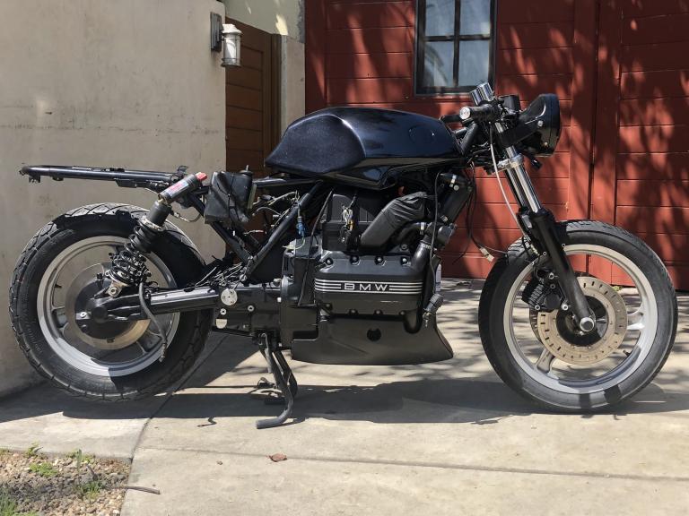

« Reply #20 on: August 18, 2019, 04:00:09 PM »
Finally been able to put some hours on the bike... just need to complete the seat and she's on the road for our first ride.
Thanks to the wealth of knowledge on this forum and a lot of trial and error she's almost there!

I really like the belly pan, is that an original K100 RS belly pan?

Thanks! It’s the stock k75s belly pan. Really accentuates the lines.
