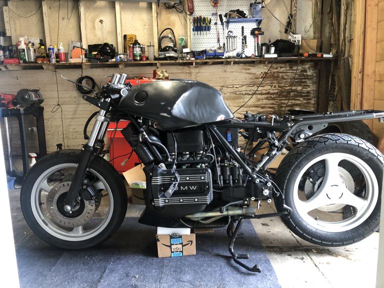

It's been quite a long road of trial and error.
Finally got a triple tree clamp created that will house my Motogadget Mini
Still on the way, custom short rear sets and really nice seat: https://bit.ly/2GyHziu
So far i've done the following:
- ABS Delete
- Custom SS front brake line
- Rewired the entire bike
- Fitting 7" headlight
- Custom throttle
- Lowering forks to accommodate my riding style
- Engine Tune (plugs, wires, timing)
- Land Rover Metallic Black on the gas tank
(will paint seat and lower faring same color... may do bedliner on the bottom of the faring as it's going to get some debris from rides)
- Ducati Monster 821 Hand Controls and Brake Master Cylinder
- LED Signals
- LED Circuit board bypass
- Rebuilt fuel tank (filter, pump, fuel level sensor, cleaning)
* IMG_9482 3.JPG (97.85 kB . 768x576 - viewed 1992 times)
* IMG_9486 2.JPG (87.4 kB . 768x576 - viewed 1942 times)
* E00BD357-B947-44C5-981B-0EA8D2649451.JPG (24.07 kB . 324x576 - viewed 1930 times)
* IMG_9497.JPG (74.7 kB . 768x576 - viewed 1954 times)
* IMG_9501.JPG (73.71 kB . 768x576 - viewed 1964 times)
* IMG_9502.JPG (84.89 kB . 768x576 - viewed 1951 times)
Still to come and looking for any suggestions:
- Deleting separating line in the bottom faring so it looks like one piece
- Muffler
- Painting forks
- Painting kickstand / Center Stand
- Shaft lube
- Tires
- Brakes
- Seat fitment
- Overflow tank relocation
- Lithium Batter Relocation (under seat)
- ECU relocation
- Ignition switch relocation
- First Ride :)
Really happy with my progress in between huge film projects and working on my Land Rovers.
Can't wait to get it out put some hours on the bike.
Getting close!

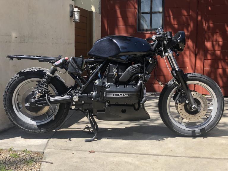

Had a chance to do some cleaning up as I wait for the last bits.
Decided to try a bronze color on the wheels, and think I am going to land on powder coated nardo grey. The lighter color does so much more for these wheels in my opinion.
Got my motogadget installed in my custom top clamp, adding a few warning LEDs to the headlight once my mounting brackets get in, hid my super loud new horn in the cowl.
I've ordered a Ducati ST4 starter choke control to add to the bars to replace the stock choke, hoping to install this weekend to give my thoughts on this upgrade since I've gone w a fully custom setup.
Need recos on Exhaust, I almost want a straight pipe w minimal muffling. Thoughts?
* 31A050DF-77E0-4325-813F-D1D3CCF334CF.JPG (70.58 kB . 768x576 - viewed 2133 times)
* IMG_0102.jpg (97.91 kB . 768x576 - viewed 2228 times)
* IMG_0111.jpg (48.04 kB . 432x576 - viewed 2193 times)
So close to getting her on the road!

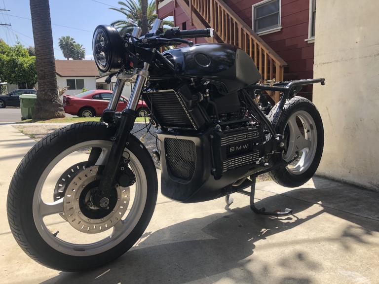

Finally been able to put some hours on the bike... just need to complete the seat and she's on the road for our first ride.
Thanks to the wealth of knowledge on this forum and a lot of trial and error she's almost there!

Looks great!
Nicely done.
I really like the belly pan, is that an original K100 RS belly pan?
I also like your exhaust but would worry about how loud it is, is there any silencing built in?
Cheers
  • Houston Texas
  • 1993 K1100RS
Offline almostordinary
  • Posts: 76
Re: K75 - Starbucks Warrior build
« Reply #22 on: August 19, 2019, 11:31:45 AM »
Thanks! It’s the stock k75s belly pan. Really accentuates the lines.
The exhaust is a bit loud when the choke is open but quiet enough when the bike is warm.
Haven’t taken it out yet to see if it’s too loud, but there is some silencing built in. Not a ton though.
Hoping to get her out by weeks end and put some miles on the bike
  • Los Angeles
  • 1991 K75s
Offline herseyb
  • Posts: 366
« Reply #23 on: August 19, 2019, 11:39:37 AM »
That seat line really smooths out the lower angle on the tank that is usually out of place on these bikes.  Well done.  I wonder if you could mount the radiator cover from a k75 standard bike above the lower fairing.  Might look nice and give things more of a finished look there.   I like it.  The K75S, where the S stands for starbucks.
