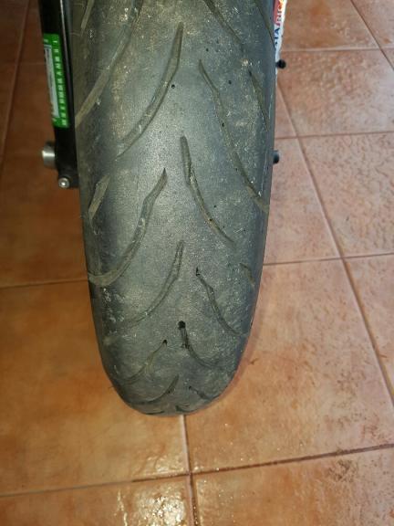

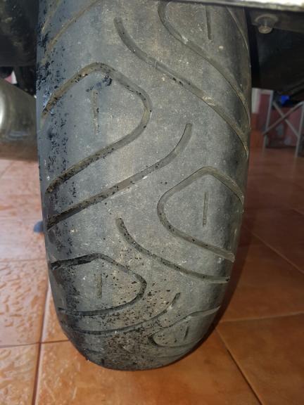

She lives!!
The battery was super flat of course but I connected jumper cables and gave it 20 mins then it did start if very reluctantly.  When I parked it I had left it on the center stand but at some point someone moved it and left it on the side stand.  That meant when I did get her going there was huge amounts of smoke to start with.
A big thanks to stokester for suggesting a pump - both tires were at 15 psi...
It is running kind of rough but running.

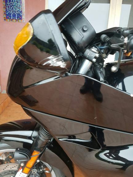

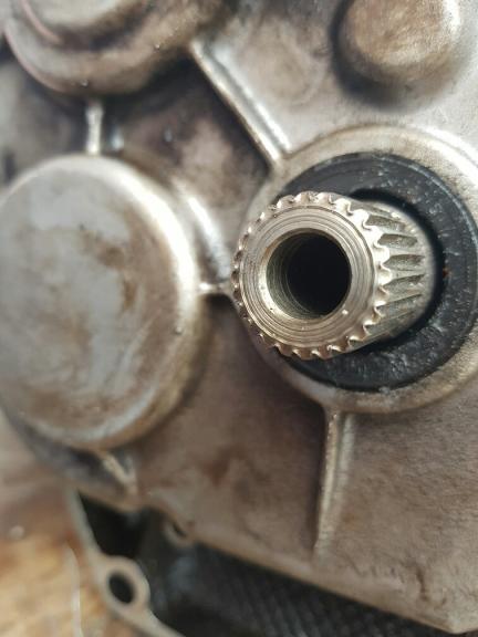

The bad news is that they had put paperwork covered with scotch tape on the tank. Over the months water has got in behind it and the tank if pretty badly damaged.
They do, in theory, have insurance so I will start the process of a claim but don't hold out much hope.
Luckily I had already planned on repainting anyway so...

Post by: Filmcamera on October 11, 2016, 08:14:48 PM

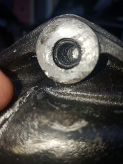

The extractor set has finally arrived - and it would be the week I cannot do anything to the bike until the weekend...
Fingers crossed for Saturday
Title: Re: K100RS parked for four months outside in all weathers
Post by: stokester on October 11, 2016, 08:23:04 PM
Looks just like my MATCO set with left-hand drill bits and the extractors to fit.
Take it easy and be patient.  Breaking off an extractor brings all kinds of trouble.
Post by: Inge K. on October 11, 2016, 08:54:28 PM
Not really needed, as you just could have drilled the head of the screw.
Be aware that it's a special screw with a shallow head, if using a ordinary allen screw you
need to grind down the head.
Post by: Filmcamera on October 11, 2016, 09:06:36 PM
OK I will remember that thanks. It is an M8 right or is it M10? I can't seem to find the part number or see it on the fiche but do see it in Clymer, though it just says allen screw without specifying the size.
Post by: Inge K. on October 11, 2016, 09:08:56 PM
M8
Post by: Filmcamera on October 11, 2016, 09:17:47 PM
Ty
Post by: Inge K. on October 11, 2016, 09:30:10 PM
Sorry, did first have the older type fork in mind.....on your fork it was a change in 08/91.
On early version seems to be M10, late version M8....both is special bolt, which you gonna need
the OEM part.....especially if you have the early version which have a integrated valve.

Post by: Filmcamera on October 11, 2016, 09:43:14 PM
The fiche on MaxBMW for my bike does show the integrated valve -
 31 42 2 310 804
but to be honest it isn't very clear
just my luck it is a $65 part and the later on is $8...
I guess I will take it out and see
The set switches from one size extractor to another at M9 so I might play is safe and use the one for M8 just in case..

Post by: Filmcamera on October 16, 2016, 09:58:00 PM
Soooo...
A largely but not totally successful weekend to report.
I had discovered a total of six wrung out allens on the bike when I started to work on it.  This weekend I managed to get five of them undone using the extractor kit.  The one that got away... yep the bottom of the fork leg.   I cannot get it undone.  I have drilled a decent hole and the extractor bites great using the tap wrench I have but it just will not turn.  I have so far avoided getting all butch and putting some kind of extension bar on the tap wrench because I don't want to break the tool off in the fork.  For now I think I will take both forks to a specialist BMW shop near me and let them have a try...
I DID manage to get the second fork off the bike (there was a threaded nut in the lower triple tree). I also got the rear brake off and gave it an overhaul - there is a hole in the pipe from the master cylinder hence zero back brake.  I also took the discs off the front wheel so I can swap them round and mount the wheel the right way. I took off the rear wheel so I can prepare it and the front for powder coating.
Lastly I tackled the fuel tank, to get it ready for a respray.
I drained it and was going to dismantle it when I saw how the filler looks.
I guess I am going to have more work with the extractor but they are such small screws i wondered if I should do anything different?
The inside of the tank doesn't look too bad but isn't great and the electrics have been hacked about (of course).  The sender unit for fuel level is a total wreck but we run ethanol free gas here so the rubber etc seems ok.  I can almost guarantee the hoses inside the tank are the wrong ones but wanted to get some input before messing the filler cap up to get everything out and check.

i suppose you applied heat to the bolt to melt the thread locking compound, and use an adjustable torque wrench so you can control how much you using--it may take at least whatever the tightening torque value is to get it loose.
A small carbide drill bit should open up the gas cap screws--hopefully you can get in there to get it squared away.

Yeah I did use heat on the Allen in fork. To be honest if I just got braver with some sort of lever on the tap wrench it might break free. The issue is that since it is JUST a tap wrench that the extractor connects to I don't know how much force it or the extractor can take  and survive. (http://uploads.tapatalk-cdn.com/20161017/80934d23feafa9f12102157a83e70c33.jpg)

Try heating with a hot air gun on the fork leg, also try a 50-50 mix of acetone and ATF fluid. As far as the filler screws I would try removing with a screw removal bit, they come in a set and are different than Eziouts. If this doesn't work drilling the heads off the screws carefully with a counter sink drill bit could be an option. You need to keep it centred and square ( helper is handy to make sure you are drilling square) and only go deep enough to just remove the head. Hopefully with the heads and filler removed and with a bit of heat and penetrating fluid they will come out. If they don't you will have to drill them out, if you have drilled the head off and it is centred and square you could use this as a guide to centre and drill out the screws. It is a tricky and daunting task go slowly and carefully. If you are not confident try out the techniques on a bit of scrap material drill, tap and countersink, fit some screws and try drilling them out with the extractor, try countersinking and drilling and retaping. It is better to stuff up a bit of scrap than stuff up the tank.

Get a square, or triple-square, socket of the correct size and then you can use a torque wrench (e.g. 4,8 or 12 pt socket)

Make sure you have thoroughly flushed the tank before applying heat. Also be careful if you use the the Acetone ATF mix it is highly flammable and will remove paint. Before attempting to use the screw extractor you could try alternating between heat and cold (freeze spray) then apply the Acetone ATF mix and let it soak for a few hours or days.You might want to replace your existing screws with stainless steel allen screws and a bit of Koppercote once they are out.

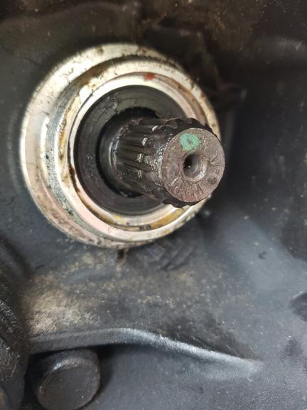

So the good news is - the allen is OUT!
The bad news is it is a mess in there.
The seals seem to be very well stuck in there and before I just hack at them with a screwdriver or something I wanted to ask if there is a specific method used to get them out?
They also seem different from the replacements I brought from MaxBMW.  It seems the ones in there are part number 31 42 2 312 928 which MaxBMW says were superseded by 31422310345 which are the ones I got as replacements.  That makes it hard for me to work out exactly what is going on under all that old grime and grit etc.
So can anyone tell me the best way to get the old ones out?
Post by: The Dude on October 23, 2016, 07:37:13 PM
Should be easy enough with a screwdriver working round.I seem to remember puting two blue seals in mine and original BMW gaiters many miles ago.
Post by: Laitch on October 23, 2016, 07:47:30 PM
When the springs and seal circlip have been removed, on my K75 I use the absorber tube as a slide hammer and bang the seal out of there.  Check Delboy (https://www.youtube.com/watch?v=vrmYJgcGX30#t=395) at 10:00. I can't say whether that's the best way on a K100RS but it works on a K75.
Post by: Filmcamera on October 23, 2016, 08:18:27 PM
Well that is exactly what has me confused.  I cannot for the life of me see any kind of circ clip or retaining ring holding it in...
Yet it is very well stuck in there
Post by: kennybobby on October 23, 2016, 08:33:44 PM
That dark brown wet rusty bit above the seal is the internal snapring--i can see the extraction hole in the ring at the 3 oclock position in your 3rd photo (073606) in the prior post.
google snapring and snapring pliers to see pictures.
A pick can be used in the hole to pry the ring out and a small screwdriver to work the edge around to get it oot if you don't have the right pliers.
Post by: Filmcamera on October 23, 2016, 08:52:40 PM
Yep just after posting  the last post I saw it myself and with a pick and some grunting me and my son got it out . Thanks for the help.  I am beginning to realize that the easiest task on this bike is a challenge. I have never seen seals such a mess. Still progress is progressing- we have had a great day

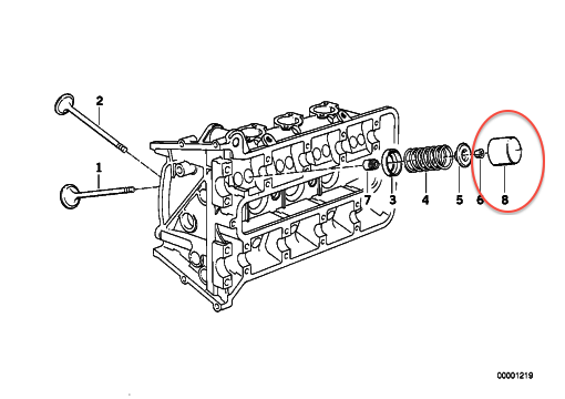

I am nearly ready to send some parts for paint and powder coating.  I have the front wheel off and the disc brakes removed etc. All I need to do now is take the bearings off and Clymer's mentions needing a special BMW tool to do this.  Is that the only way or can it be done without buying the special tool?  I know there are posts on how to do it if you are replacing the bearings but unless they are terrible I was hoping to reuse them, I just wanted to take them off before the powder coating process.

Post by: kennybobby on October 27, 2016, 09:27:42 AM
It's difficult to remove them without smacking the inner raceway, and that will damage (brinnel) the bearing.  You don't want powder coat in the bore of the outer race anyway, so it would need to be taped off well--it won't matter if the bearing is in or out when taping, actually may be easier to do a good tape job with bearing in place.  Cut a piece of cardboard to fit in the outer bore and trim the tape at the edge--no paint will get into the bearing.

Post by: Filmcamera on October 27, 2016, 09:58:38 AM
Great, I was hoping that might be the case. Makes life much easier. Thanks
Post by: The Dude on October 27, 2016, 04:22:18 PM
To be sure,take the old bearings out for powder coating ,a heat process,but must mask off the bearing housings.Or leave them in as masking but the bearing seals will be ruined so you'd have to scrape off any powder coating to get them out.New bearings on my old girl are cheap and standard.Brute force with hammer and drifts worked for me.New bearings= peace of mind.
If it's paint then no heat involved but is an inferior coating.

So the bearings are a standard type? That makes it a lot cheaper if I don't have to buy OEM from BMW in the US.
In '86 they certainly were.I presume yours are also similar but I have heard of more recent designs having bullshit added complicated weird tapered roller different either side bearings,which caught me out when trying to post authoratively about it....I could still be wrong.Replacing mine was easy.They fail slowly in my experience whining and getting hot untill the last bit and then they sieze or the cage colapses and shag out the housing.You'd deserve what you get if you didn't notice all that in time.
Proceed with confidence!..but use a reputable bearing supplier.

Can any 1100RS owner please confirm for me that this tapped hole on the rhs of the engine is for a fairing mount?

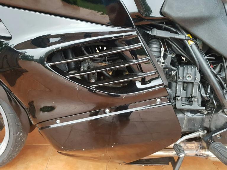

Post by: The Mighty Gryphon on November 24, 2016, 09:57:14 AM
That fairing looks really good!  Hope you have everything tied down for the big blow coming your way.

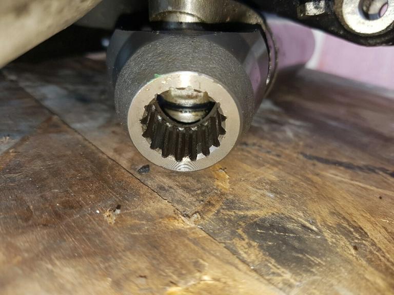

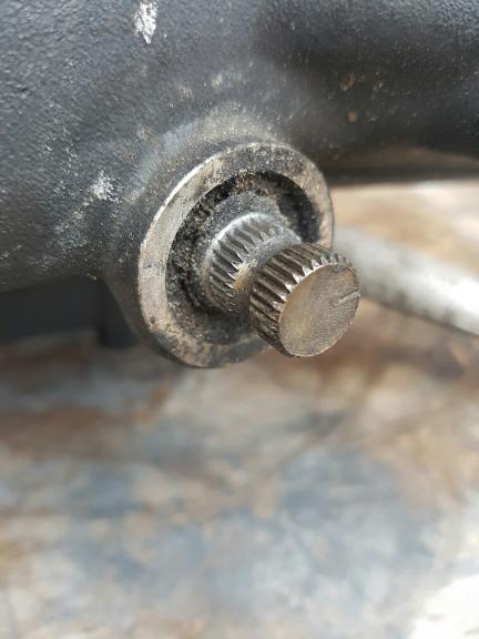

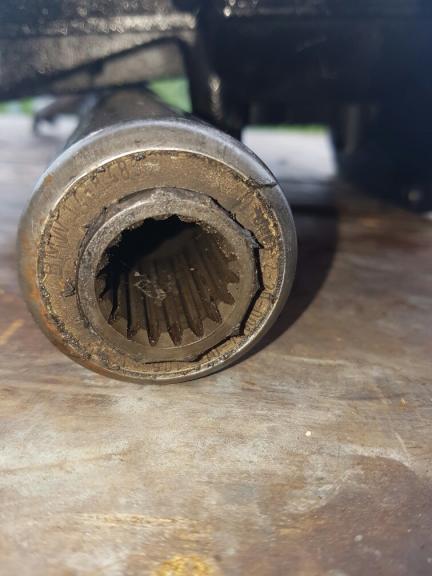

Today I started the process of doing a spline lube.  I can't go all the way to the clutch right now because I have no front wheel so can't easily get the bike off the center stand to remove the transmission.
Instead i though I would just remove the rear drive and have a look at the splines there - expecting to find them dry as a bone and worn as heck.
In fact I had a fairly pleasant surprise
The splines did have lube on them - though i suspect it was just regular grease and when cleaned up they looked in pretty good shape.
The only thing I am not sure about is in the top shot you can see a band around the middle of the shaft, like a cut, doesn't look too bad but I am not sure if I should be worried about it.
The final drive oil was pretty bad and very smelly so i will be changing that for sure.
Post by: Martin on November 26, 2016, 05:02:34 PM
Wouldn't worry splines look great just lube them up with one of the recommended high moly greases.

I was planning to check and probably change the transmission oil today.  Then I saw that the filler screw plug is wrung out (like it seems almost every other bolt head on the bike!)
I am getting pretty experienced at removing these bolts but this one has me worried.
The screw plug is pretty shallow and goes directly into the transmission so I don't think drilling it an using an extractor is a very good idea.
I was thinking maybe I would have to buy a sacrificial 8mm allen and weld it into the hole?
Anyone got any other ideas?

Post by: Laitch on December 08, 2016, 11:16:20 AM
Remove the drain plug to relieve pressure from heat. Using a heat gun, heat the filler plug and area around it. Pound a slightly oversized socketed torx or hex bit into the plug. Heat the area around the plug again. Apply penetrant. It'll probably smoke. That will reduce the insect population and impart a cloyingly sweet aroma to your coveralls. Return in 15 minutes and give a hard reef on the socket with an extension handle on the wrench or breaker bar. Instead of the socket bit technique, you can pound a notch into the hex opening with a cold chisel and hammer it out counterclockwise using the chisel. Or you can carefully weld something to it, as you suggested.
Enough heat, penetrant and patience, it is going to unscrew.

Post by: kennybobby on December 08, 2016, 11:28:37 AM
Put a drop of oil in there to loosen the crud, then use a scribe or pick to break it up and vacuum it oot to see how deep the hex flats really are--it may be deep enough that an allen wrench will extend past the damaged flats and come right out...

Post by: Filmcamera on December 08, 2016, 11:35:05 AM
I tried that no luck but then I got lucky - I tried a T 50 torx bit and that gave me enough leverage to crack it and get it out  :clap:
Needless to say the transmission was dry as a bone.  I don't have the special dipstick but Clymers shows it and the lengths in mm of the handle and oil measuring levels.  So I used those and it took 400 ml before even registering.
I am going to order a new screw plug and washer and will see if I can also find the correct dipstick - the washer wasn't even there on mine which is no doubt why the PO gorilla'd the nut hoping to stop leaks.

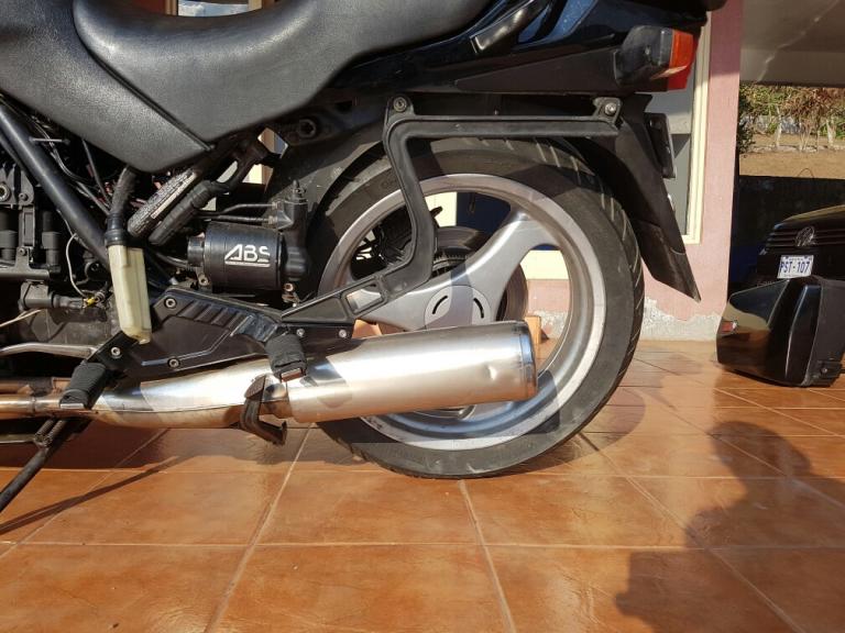

Today I begin re-installing the ABS on the bike.  I have been looking on the internet and in this forum but I am a little hazy on one thing.  As far as I can tell on the modulators, ABS I, the top hole is for the line coming from the brake lever, either hand or foot, and the bottom one is for the line going to the caliper.  Can anyone confirm that?
Post by: Laitch on December 10, 2016, 08:56:11 PM
Have you looked at the diagram that's found if you scroll down here (http://www.kbikeparts.com/classickbikes.com/ckb.tech/0.ckb.tech.files/abs/abs.htm)?
Post by: Filmcamera on December 10, 2016, 09:01:39 PM
Yes. I did, in fact that is the ONLY place I found a clue as to which goes where, I was just looking for confirmation from elsewhere.
Post by: Laitch on December 10, 2016, 09:02:49 PM
Go with it.
Post by: The Mighty Gryphon on December 11, 2016, 10:44:24 AM
Looking at the modulators on my K75S, the top fitting near the bleeder is the inlet from the master cylinder, and the lower connection goes to the caliper.

Now,  have a question about the three hard lines., Two long and one short.  As far as I can tell so far one of the two long lines one is shorter than the other and has a wider thread at one end.  I think this is the line that goes from the modulator to the caliper. The other long line is therefore for the line to the brake lever.  The third short, curved one seems to be an extension for the line to the caliper.  I am having a little trouble working out the exact routing of the that pipe so I can connect it right. I have searched but can't find any photos on line.  Can anyone tell me how I should route the lines?  Thanks
Post by: The Mighty Gryphon on December 13, 2016, 04:23:34 PM
Does this help?
Post by: Filmcamera on December 13, 2016, 04:29:47 PM
hmm kind of - though it seems to reverse the previous decision that the top line was for the line to the brake lever and the bottom line to the caliper...
Post by: Laitch on December 13, 2016, 10:08:15 PM
Does this help?
It is a cause of confusion because it varies from the BMW ABS I Users Manual regarding the positions of the lever lines and the caliper lines. What is its original source, Gryph?
If this were my bike, I'd follow the manual and fit the parts accordingly. Somebody here must be able to make a photo layout of the assembly to help move you forward, Filmcamera, if the manual isn't enough for you.
Post by: The Mighty Gryphon on December 13, 2016, 10:36:41 PM
It's the parts fiche for the bike he's working on.  It should show the basic relationship, as far as what connects to what, of the various lines he said he was having a problem identifying.  The lines he is working with are off my RS which is the same model as his.
The two long ones run to the modulator.  The one with the hose and the hard line goes from the master cylinder to one of the long lines.  The hose connects to the master cylinder, and the hard line connects to the long line that has the matching fitting.  The long line that connected to the hard line from the master cylinder goes to the inlet of the modulator.  The other line connects to the modulator outlet and is connected by a hose(not provided) to the fitting on the fork brace between the fork tubes.
As near as I can remember the two long lines run from somewhere above the right hand side of the radiator, back above the air box to the modulator.

Post by: Laitch on December 14, 2016, 07:42:56 AM
In the fiche diagram you supplied and your description from memory, that would make their positions reversed from the manual's schematic drawing as I understand it.
I'm slightly disturbed that although my safety is compromised by not having this ABS system on my bike, I'm happy about that—classic approach-avoidance.
 :yippee:
Post by: The Mighty Gryphon on December 14, 2016, 08:34:47 AM
On my K75's the rear brake modulator is connected as follows:
Upper fitting goes to the master cylinder and the lower goes to the caliper.
The connections for the front modulator are configured differently from the rear modulator.   In that case I would follow the manual or the fiche illustration in lieu of better documentation.  I suppose it was a screw up to assume that the internal passages of the two modulators were the same even though the line connections were in different locations.
I guess that Filmcamera will have to sort this out on his own.  The more I post the more confusing this gets.

Post by: Filmcamera on December 14, 2016, 08:52:50 AM
Yes the rear is easy, even the Clymer's specifies which line in the intake and which the outlet but it doesn't for the front modulator.  It also seems they changed the early ABS system's all the time.. For example my modulator has clearly different sized holes for the intake and outlet (as does the shorter of the two long hard lines I got from Gryph) yet the other one I have (which had the wires cut) has the same size holes. All I really need to know is if the top hole is intake or outlet, the rest I can work out from there.

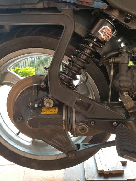

I had one question about the rear wheel.  I know they came with four and five bolts.  I have five - on ebay I had got hold of a hub cap but it turns out it is meant for a four bolt wheel - it doesn't fit with my five bolt set up. How big a deal is it if I leave the fifth middle bolt out so I can use the hub cap?
Post by: The Dude on December 19, 2016, 01:32:19 PM
"How big a deal"?
I'm a bit confused about the fith bolt being in the middle...(Disclaimer)
I believe I'm far enough away to avoid litigation.4 bolts is ample for all the stresses involved....actually one would be enough not if it's the one in the middle though but don't quote me. :yow
(Disclaimer)Best sort it out properly.The inspector may take the cap off?
  The powder coated in wheel bearings,just scratch out the offending film on the wheel housing,carefully, and bash them out with a drift (solid bar)?and well aimed brute force.
Square dancing is par for the course.You will do better next time...won't you?
The five bolt configuration is news to me too. What's your source for that info?
Post by: Filmcamera on December 19, 2016, 02:01:45 PM
Well apart from the fact there are five holes and my bike came with five bolts, the Clymer shows five bolts for the three spoke wheel - in chapter 14 - supplemental info on 1990 and later models - the only part of clymer that seems to be right for my bike most of the time.
Post by: Laitch on December 19, 2016, 02:09:59 PM
Well, the fact that your front wheel came with its spoke orientation reversed doesn't make your bike's appearance a particularly sound reference for how things should be, does it? If the wheel calls for five bolts, it ought to have five bolts holding it; otherwise, you're heading down the maintenance path of the previous owner.
I questioned you because there's no reference in MAXBMW's fiche from a 5-bolt patterned wheel. Onward!
Post by: Filmcamera on December 19, 2016, 02:13:57 PM
I agree 100% that what ever is on my bike is not a great guide but it is in the Clymer ad the reason I though of asking was that in one of Chris Harris' videos he mentions them in passing with a disparaging remark.
Post by: Martin on December 19, 2016, 04:07:34 PM
Is the five bolt pattern counting the one in the centre as shown in your picture. I have a 92 K75S with 3 spoke wheels and it does not have the centre bolt. Does this centre bolt actually retain the wheel?   :dunno  I have looked at a Haynes manual and a few parts sites and can not see any reference to it I will continue to look it is a bit of a mystery.
Regards Martin

Martin yes it is in the center and it does seem to play a small part in retaining the wheel.

Post by: Martin on December 19, 2016, 05:44:53 PM
Must pertain only to a couple of models. I would not do away with it, must be there for a reason for fitting it. As for the hub cap you should be able to find one that fits with a bit of hunting. The one from a K75 will not fit due to the centre bolt, one of the inmates might have one.

I didn't know there were 4 bolt wheels. Must be a K75 thing. Yes, use all 5. The fifth is not an accessory...
Post by: Laitch on December 21, 2016, 12:19:55 PM
I didn't know there were 4 bolt wheels. Must be a K75 thing....
Five bolts are a paralever thing.

I finally found out where the brake lines go correctly for the ABS 1 on my bike . a big thanks to John (SugarHillCTD) over on the k1100 forum for taking the time to take photos and send me the explanation.
The bottom hole on the modulator is for the calipers as Drake had it in his diagram.  The top one is for the brake lever.
So the fiche is wrong

Post by: Laitch on December 22, 2016, 11:50:39 AM
Say it isn't so!
Regardless, the schematic from the BMW ABS1 Users Manual available in the Technical Library here has been accurate.

Post by: Filmcamera on December 22, 2016, 12:10:22 PM
The ABS manual is accurate but limited in the info.  It does show which line goes into which hole but no specifics on the lines themselves. I am very glad I managed to get confirmation from an owner with the same bike as me.  If it had been anything other than the brakes I would have been less concerned.  I am getting my new brake lines tomorrow so I will install everything and bleed the system over the weekend, when not cooking or stuffing my face with Turkey anyway!

So now to the big question that I have been avoiding.  On this forum there are a million threads and posts about valve clearances and shims on the 2v models. Mention 4v though and there is a collective sharp intake of breath and lots of sideways glances.  As far as I can gather it is ok to check the 4v engine's valve clearances but unless you are a wrenching God do not attempt to shim them.  Is that fair? Are the valve clearances as critical on a 16v?  Should I check them and them take them to BMW if they are wrong or just take it to BMW to check and fix if necessary?
Post by: Laitch on December 27, 2016, 09:23:10 PM
Your Brick has been neglected. You must check the valve clearances.  If they need adjusting and you've got the time, tools, clear written instructions and the nerve, adjust them to the correct values.
Mechanical procedure at the level most of us practice is nothing more than following instructions carefully using the appropriate tools and paying attention. That includes adjusting valves on 16v Bricks. It's more complicated than on 8v Bricks only because there are more steps and parts involved in the procedure. Regardless of whether a procedure is simple or complex, only one step can be done at a time—one step after the next until it is finished.  Once the valves are correctly adjusted on 16v Bricks, their reputation seems to be that they stay that way. If you've got the money to pay somebody else to do it, pay them and accept the outcome.
It is pointless to raise this deal to a mythical level. Getting a less complex bike would be a better strategy.
Post by: The Mighty Gryphon on December 27, 2016, 10:25:07 PM
The dearth of comments on this procedure is testament to how often it is needed.
OK, here is my experience from a sister brick to yours.
My bike has over 114,000 miles and came to me with no service records, but judging from it's condition I'm guessing the valves were never done.  I say this because the word on the 4 valve engines is that the valves hold their clearance.  Thus, they wouldn't have needed adjustment during the early part of it's life, and I'm pretty darn sure they weren't addressed in the last 50-60,000 miles.
So, assuming they were never done, here is what I found.  Out of 8 exhaust valves, all were still in spec, however, several were at the tight end.  All the intake valves were in the middle.  I could have left them alone, but since I was pulling the head and replacing the valve guide seals I decided to get all the  exhaust valves as close to the wide end of the spec as possible.  I wound up changing 4 exhaust shims.  Had to buy 3.
On the 4 valve engines it's a royal pain in the ass to do the shims, about on a par with changing the clutch o-ring.  You need to pull the cams, and the timing chain to change the shims on this engine.  On the bright side, at least I was able to get the job done without needing any special tools.  Figure at least a day(a long one) start to finish.  I was lucky(!?) in that I was able to do it as part of a head reassembly.  Still, it's not something I want to do again soon.
My advice is to check them, record the clearances and store them.  Unless a valve has totally gone out of spec I would leave everything alone.  A complete check should take less than an hour start to finish.   If you absolutely have to do them, get a firm quote on having the shims changed from a reputable mechanic.  That should convince you that it is a job you might want to learn how to do.

Great! It should show the types and sizes of the feeler gauges and how to use them.
So does this video that is accessible in the Technical Library.

I used a set of inch feeler gauges.  I have metric gauges too, but they didn't have the resolution the others did.  With the inch gauges i could fell a gap that was in the middle of the spec.  My metric gauges only let me know top or bottom of the spec.

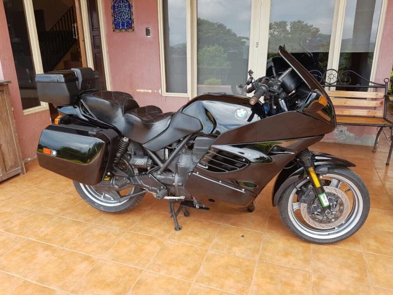

Yesterday I flushed the radiator and added a 60/40 mis of distilled water and coolant, I also balanced the TB's and bled and fixed the rear brake.
Today I put on all the tupperware for real for the first time.
I still have things to do (like find some vinyl paint so I can paint the backrest on the top box for example) and fix the front brakes but do feel I am getting very close now.
Here are a few pictures
Post by: MaraudeRS on December 29, 2016, 03:26:52 PM
Looks good!

Post by: Filmcamera on January 04, 2017, 10:50:02 AM
Looks like fixing the clutch boot leak has just shifted the leak to another place out the drain hole.
According to this post http://www.motobrick.com/index.php/topic,2883.msg16783.html#msg16783 (http://www.motobrick.com/index.php/topic,2883.msg16783.html#msg16783) it is either the input shaft seal or the clutch pushrod seal and that I have to pull the tranny either way.
So I am assume I might as well go ahead and replace both while I am in there - as well as doing a spline lube.
My question is, is there anything else I should do while I have the tranny dropped? Also how urgent is this? If I keep it topped up with gear oil can I ride for three or four months till the rainy season starts or should I take of this right now? (I know, I know, I SHOULD do it now but I want to ride it a little before it rains again for six months...)
Ouch - I have been reading up in my Clymer's on how to do this and it looks very tricky.
This thread http://www.motobrick.com/index.php/topic,4542.0.html (http://www.motobrick.com/index.php/topic,4542.0.html)
Scares me, am I crazy to even think of doing this myself?

Ride it until it becomes a real problem(rear tyre).Check the oil level regularly and enjoy your dry season.
Post by: Dennis de Vries on January 04, 2017, 09:10:56 PM
Ride it, keep an eye on it, it might even fix itself through use....

If that is transmission fluid leaking from the weep hole, you might have overfilled the case. I use my fluid level gauge to check the depth of the fluid as I fill my bike's case. If you just poured in a set volume and it exceeded the correct level, that might cause a seal to leak. Putting in the correct level and riding it may reduce the volume of the leak or the leak may stop altogether.
I'm surprised you hadn't done the input splines yet. Replacing seals and lubing the input spline shaft is just like everything else. Get your procedure in order first, then follow it step-by-step.
Post by: The Mighty Gryphon on January 05, 2017, 11:03:09 AM
I'm with Laitch on this.  Too much oil in the transmission can possibly let the oil leak where the clutch pushrod exits.  However, IMO you probably have a hardened o-ring at the clutch hub.  That will result in engine oil leaking.
A good time to change that o-ring is when you are in there to do the splines.  If that's the problem, which I think it is, unless you are leaving puddles when you park, you should be ok enjoying your brick until the rainy season.

Post by: Filmcamera on January 05, 2017, 11:14:28 AM
OK great thanks.
I will order the parts and maybe when they arrive I will feel the urge to just get it done.
I freely admit that I have been putting off do a spline lube.  I had zero wrenching experience before I got this bike and just the fact that it is a six part video watching Chris Harris to a spline lube has me more than a little intimidated.  Still I have no doubt I can do it, I have managed everything else so far.

I don't bother with the front wheel when doing stuff like pulling the transmission for spline lubes.
My setup consists of a stack of 2 x 8 pieces about 10" long under the oil pan.  I notch the top piece to accommodate the drain plug.  I have made a saw horse that goes under the rear frame loop to support the bike when the centerstand is removed.  I made the horse just high enough that the front wheel is just off the ground.
Another stack of wood helps to support the transmission when you pull it back.  I use a floor jack with wheels and a pair of 8mm x 4" bolts with the heads cut off the slide the transmission in and out of the clutch pack.
A handful of 12" long cable ties holds things like brake calipers to the frame after they are removed.
As far as the leak, I found that after 24 years/116,000 miles my rear main seal was still ok, and that the oil was coming from the o-ring that had hardened to where it was so brittle it crumbled when I pulled it out.

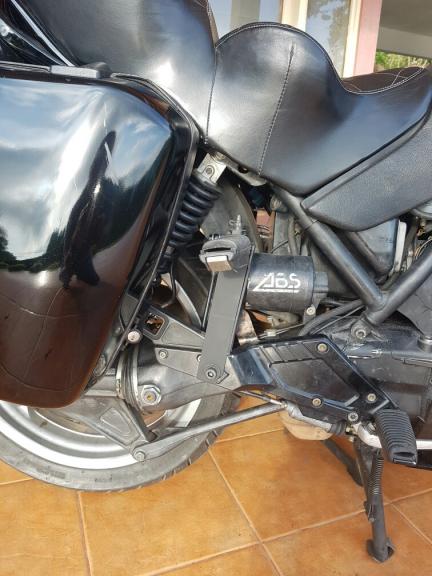

Post by: Filmcamera on January 11, 2017, 12:38:34 PM
Today I installed the new ABS modulator, bled the brakes and took her out for a ride!!!  :mm :riding: :bmwsmile
All in all it felt good, though they were a couple of niggles.  The speedo and odometer don't work, has anyone ever had that before?
Before I get harangued that was a joke...  I know all about the numerous threads on the subject and will dive into them and see how it goes.
The brakes are kinda mushy - I will rebleed and see if that helps. The ABS does appear to work, at least I get the warning lights when I start up but it goes out once I get moving so looks good.
One of the side cases is loose and rattles a lot, I think I have seen threads on that as well.
Basically I am very very happy. It was great to get it out on the road after so many months, even if only for a five mile shake down ride.  My plan now is to go all over it and check everything is still tight then take it to the government test center on Saturday to get it certified road worthy.
A huge thanks to all of you for your help and guidance, I could not have done it without you! :clap:

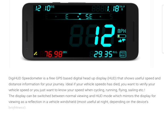

If you've got a speedo app on your phone that has a large display, your phone is in a cradle that allows a fairly heads-up view and you have a pocketful of expendable paper money, that will show them that your intentions are good, and so are their prospects. It's a winning situation for everyone.
* speedo app.png (129.42 kB . 576x398 - viewed 840 times)

Throttle bodies yes and now I come to think of it that one was running pretty rich, the problem is the PO had clearly messed with the not to be touched throttle body screws so I was having a hard time getting things smooth and at a decent tick over, I imagine it needs more tweaking.
The valves I didn't, I watched a Chris harris video on how to do it and he says very clearly - if you have 16v K bike you are wasting your time don't bother with the valves, they never get tight.
So I took his advice and didn't, though i think I will during the rainy season just to increase my knowledge of the bike.

. . . if you have 16v K bike you are wasting your time don't bother with the valves, they never get tight.
I'd usually go with what Harris is saying but your bike was in such a sorry state, I'd be compelled to check the clearances. I'm not one who goes looking for something to do either. I'd rather be riding.
Anyway, the plugs might have something to tell you and that's easy enough.

Today I have started the process of changing the clutch as well as doing a spline lube etc.
One bad thing, I removed the exhaust and the exhaust outlet for number two cylinder (which was always running cooler than the others) has oil on it (see photo) is this seriously bad news? Are we talking pistons rings? When I did a compression test it was lower than the others but still 125 compared to 135 for the rest so in theory not too bad.
Anyway I have also attached some pictures of the splines, I would like to hear some opinions on them, I am not experienced enough to be able to tell a good one from a bad one...
Post by: The Dude on February 18, 2017, 04:06:26 PM
Your splines,both male and female,look good.My experience is the females ware out earlier suggesting harder males.I hope that translates....
The oily exhaust stub suggests a possible weeping exhaust valve guide/seal.I personally would just let it be for as long as possible.Get a follower to report on any blue haze from the exhaust silencer.That valve will be the first to die.Now,Don't ask me how I know...(half a million km on old triumphs:(
"Excessive"Oil consumption and status amongst the Friends of the Earth are some reasons to rectify early.Otherwise,keep on trucking.
Post by: Filmcamera on February 18, 2017, 04:22:56 PM
Great thanks, that makes me feel a whole lot better.

I also repainted the swing arm and paralever but am not happy with the results. I used a matt black and it is too matt, doesn't really match the OEM so I am going to keep hunting for a semi matt or something.  I remember someone mention a rustoleum product that was a goo d match?? Can't buy it here but maybe I can have someone bring some down for me.

I did look at the side stand connector - I believe the one on the 16V RS is different to the ones that were on earlier bikes.
Here are two pics of the switch, one with the side stand down and one with it up - did I screw up when reconnecting it? (not the easiest thing to photograph but hopefully good enough)
Post by: The Mighty Gryphon on February 25, 2017, 07:17:43 PM
I can't say if the switch is installed correctly.  I can go out in the garage tomorrow to check mine.  Can't say if the contact is normally open or closed with the stand up or down.  The side stand switch isn't used on the earlier bricks.  They used a retractor connected to the clutch lever.
I would work on seeing if the pump runs when the starter is cranking.  You might want to hot wire to the tank connector to override the pump interlocks and do a static pump test first.  +12V to the green/white wire and ground to the brown wire.
Post by: The Mighty Gryphon on February 25, 2017, 07:24:30 PM
Man, am I screwed up.  Three bikes with different systems has my brain scrambled.
Just went out to the garage and checked my bike:
1.  Pump should run for a second when ignition is turned on.
2.  Side stand down prevents pump from running.
3.  Look at your side stand switch.
I'll look at mine tomorrow to see if there is anything I can add.

Yesterday afternoon the clutch cable adjuster arrived to today I was able to put everything back together and go out on a test drive.
The new clutch works great! The shifts up and down are noticeably smoother and less clunky.  I can also feel a big increase in acceleration now the clutch isn't semi slipping.
So that is a spline lube and clutch change done and dusted, thank you everyone for your help.

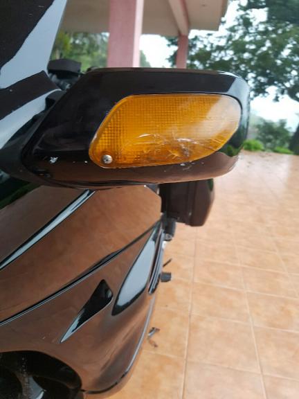

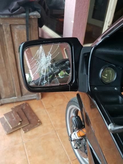

I got the first of my two new mirrors yesterday and have been trying to install it today.  I know there is a trick to getting the mirror out but is there one to getting it in? I have pushed and heaved and done everything I can but the mirror is still maybe 1 or 2 mm short of being in enough ti be able to slip the mirror clamp on at the other side. I think that is how I lost the old one so really want to try and get the clamp installed properly
Post by: Laitch on March 08, 2017, 12:33:52 PM
Any suggestions?
While you're waiting for your rebuild kit, loosen then retighten snuggly all your hose connections then bleed the system again.
Post by: Martin on March 08, 2017, 02:08:27 PM
You might want to fit leashes on your mirrors, would stop them wandering too far.. Fishing line tracer would do the trick.

Post by: Filmcamera on March 08, 2017, 02:13:05 PM
I have leashes on the whole mirror housing but can't work see how I could also add them to the glass on its own.  Last time the housing stayed on the bike but the glass came off by.  That is whyI thinkmaybe I didn't have the clamp on right, but despite my best efforts I cannot get the clamp on now either.
Post by: Laitch on March 08, 2017, 04:05:30 PM
I'm uncertain what kind of gyrations and incantations you're involved in with this process because my bike is less complex; however, try this post on for size (https://forums.bmwmoa.org/showthread.php?37948-K100RS-mirror-glass&p=479694&viewfull=1#post479694) and read the others surrounding it. Maybe there will be something useful.
Post by: Filmcamera on March 08, 2017, 04:17:36 PM
Thanks, I have worked out a method of tethering just the glass separately to the rest of the pod so I am going to try that and not worry about it too much
Post by: The Mighty Gryphon on March 09, 2017, 03:45:15 PM
Laitch, the RS mirrors have a different attachment for the glass from the RT/LT mirrors.
I just went through my inventory of spare RS mirror pods and made a startling(to me) discovery.  It seems that there is two ways to attach the mirror glass.  On the new style pods, there is that nasty wire thingy you have to stick through the pod behind the reflector to clamp the mirror glass into the pod.
On my older(?) pods there is a built in spring wire that does the same job as that friggin' wire thingy.  If you look down in the hole carefully you will see two wires that will clamp the glass in place.  In order to get the glass into the clamp, you will need to push pretty hard on the center of the glass right where the post is.  If you don't push there you will be cruising eBay for a new mirror.  (No need to ask how I found that out.)
It seems those sneaky guys at Motorad changed the pod where the glass connects when they went to the 4 valve models.  It is possible that you are trying to use that wire thingy with the old style pod.
Post by: Filmcamera on March 09, 2017, 03:54:11 PM
You could well be right.  I tried installing the new mirror in the other pod and had no problem.  Both the pods I have on the bike are new to me, one came with the fairing and the other from ebay.  So it could be they are different and the one I am having trouble with simply doesn't need the mirror glass clamp thingy (that is a technical term).  Either way I am going to tether the mirror glass itself with fishing line since the glass is becoming hard to find and I don't want to keep losing them!

Hoarder? Me??? Well maybe a little
I was contacted by one of the only other two Brick owners in CR earlier this week.  He has a K1100 LT he is turning into a cafe racer.
So...
For $75 I picked up all the stuff in the photo!
Do I need it - hmm not really but $75!
Gen 3 cases with locks, 35 lt top box, rear cowl, Corbin seat (that seat has me intrigued - it looks like it mounts like a regular seal but is formed to be a low seat, anyone heard of that?)
I also got mud flap extensions for both the front and rear parts of the rear mud guard!
First issue is I can't work out how to take the top box off the mount, can someone tell me please? (edit - nevermind I worked it out)
Now it seems I need to buy the mounting bracket - one arm is busted - though a fiber glass repair might be possible I guess.
Oh and best of all - the six locks on the Gen 3 cases - they open with my existing ignition key!

Post by: Filmcamera on March 28, 2017, 05:49:11 PM
I have pulled the alternator out.
The good news is that there is no visible bulging on the battery so my fingers remained crossed that it is ok.  It is lso showing 12.80 V right now, I will keep an eye on it.
In the photo of the alternator what is supposed to plug into the single spade? There was nothing there and judging by the state of the spade there hasn't been for a long time.
Also a picture of the famous monkey nutz - I have no idea what a good monkey nut looks like so opinions are welcome.
Lastly the alternator came out very easily - I have sneaking suspicion getting it back in and lined up with the nutz might be another story!
Post by: Martin on March 28, 2017, 05:56:33 PM
Not to be too personal but your nutz look good. Long bolts with the heads cut off help when replacing the alternator, and a dab of rubber or heavy silicone grease can help to keep your nuts located.

Post by: The Mighty Gryphon on March 28, 2017, 07:21:38 PM
+1 on the monkey knutz being in good shape.
I don't know what that other terminal is for, but since everything worked in the past and the electrical drawings only show two wires connected to the alternator, the chances are pretty good that it isn't needed.
Looking forward to hearing what the alternator test finds.

Post by: Filmcamera on April 11, 2017, 12:49:21 PM
I installed my new rear shock today.  It is MUCH shorter than the original, so much so I can now flat foot both feet while sitting on the bike - not bad for only 5 ft 6.
The problem, however, is that I now cannot get the bike on the center stand anymore.  I did finally manage to but only by building a ramp to raise the rear wheel a couple of inches more so I could get the center stand further down and get more leverage on it.
I think I am going to stick with it anyway. I can keep a ramp at home for getting it on the center stand and use the side stand when I am out and about.   I know that might lead to smoky brick syndrome a bit but honestly the bike is now so low that the side stand angle is a lot less than normal (though still enough to feel safe).
I have not been able to test ride it yet, I am still waiting for the alternator to be fixed, which will be next week at the earliest now since it is Semana Santa this week (Easter) and the whole country closes down for the week.
Post by: Martin on April 11, 2017, 02:25:47 PM
You could remove the centre stand and cut it down and sleeve it. It would give you something to do over Semana Santa.
Post by: Filmcamera on April 11, 2017, 06:14:25 PM
I do not really want to do that - perhaps crazily I think of future non tiny owners who might put a normal shock back on and therefore not be able to use the center stand if it is cut down...
Before I make any long term decisions I need to ride it, I am worried it is going to bottom out a lot going up and down my hill.
Time will tell.
Post by: Martin on April 12, 2017, 02:50:25 AM
If you were in the US you could probably pick up a spare stand cheap off one of the Café builders. Probably not much of a chance where you are.

Post by: Laitch on April 13, 2017, 10:18:37 AM
I'm wondering that if you lowered the triple tree on the fork tubes by the same .75" or so that the rear was lowered by the replacement shock—a task that is recommended generally when lowering the rear—you'd unload some weight on the rear and gain some distance to develop momentum that would help you when you attempt to lift the bike onto the stand.
Post by: The Mighty Gryphon on April 13, 2017, 10:30:09 AM
Lowering the front will improve the handling with the lower rear end, but it will lower the center of gravity another 3/8" making it that much harder to get the bike up on the center stand.
Post by: Laitch on April 13, 2017, 10:38:49 AM
It's worth a try, not that I don't appreciate your negativity, Gryph.
Post by: Filmcamera on April 13, 2017, 10:44:03 AM
I had already lowered the front a little but was thinking to do it some more to match the lowered rear end.  I was planning to do a test ride first though, the new rear shock has lowered the rear over an inch, maybe more.  I am concerned it might bottom out on my hill so before going to far I want to ride it. It will be next week before I can ride it though with the alternator situation.
When I have used my ramp and put the bike on the center stand the rear tyre is 3 inches off the ground. I am worried that shock was built with a monolever set up in  mind, not a paralever like mine and it might be too much of a height lowering.

Post by: Filmcamera on April 13, 2017, 10:52:58 AM
Nope, it was set on the highest preload - I managed to knock it down one notch bot no  more.  As soon as life returns to normal here I will find a C spanner - Costa Rica during semana santa is a ghost town, everything is shut.

Post by: The Mighty Gryphon on April 13, 2017, 11:19:59 AM
Speaking of negativity, I had a rather negative experience pulling out my back trying to lift my lowered K75S onto it's stand when I first got it.
The cam action of the center stand loses it's mechanical advantage as the bike is lowered.  This combined with the additional distance you are required to raise the bike's 500+ pounds can indeed lead to some negativity.  Pulled muscles and even a right side flop.  Nice of you to notice.

Post by: Filmcamera on April 13, 2017, 11:33:20 AM
There is no way you could get it on the center stand now unless you were the hulk - the angle is just too small to be able to lever the bike up.  With my little ramp it is fine but taking it off the center stand it really crashes down pretty hard.

Post by: Laitch on April 13, 2017, 11:41:06 AM
I guess this is just one dog that won't hunt.

Post by: Filmcamera on April 13, 2017, 11:50:11 AM
I think you might be right, I am hoping not though, it cost me $240 inc tax and shipping etc.  I guess I might be able to sell it here though.

I meant the centerstand not the shock. I think this shock is going to work as well or better than the other and you are going to be more at ease at a standstill. I agree with Martin. Be on the lookout for a center stand that you'll eventually be able to modify satisfactorily.
Parking it on the side stand will need to do. Any temporary smoke from arising from starting in that situation will repel mosquitoes. Flats in tubeless tires can be plugged without dismounting them. Ride on!

Post by: Filmcamera on April 13, 2017, 11:59:56 AM
OK so let me test ride it when it is back on the road then sleeve the center stand to stop the issues and lower the front forks a little more to match.

Analyze the center stand modification closely before undertaking it. Ensure that is is able to retract fully.

The lowering may allow the center stand to ground when you do your next left hander with a dip at the apex and especially with your missus on board.It may be the stand's foot access extension which would trigger a rethink,hopefully.Like,just get rid of the stand.

I had no prob putting the bike on the stand with that shock. I step on the stand with my left foot, use my right hand on the handle, left hand on the frame and pop the bike up. You can also turn the shock around to place the pink sticker on the inside
Post by: Filmcamera on April 20, 2017, 06:57:56 PM
Yeah JC yours is a monolever mine is a paralever - the standard shock length on the paralevers is more, 15.13 inches compared to 13.75 inches for a monolever. so going to a 13.2 inch is a big difference on mine.
https://forums.bmwmoa.org/showthread.php?19881-Correct-Length-for-91-K100RS-(4-valve)-rear-shock (https://forums.bmwmoa.org/showthread.php?19881-Correct-Length-for-91-K100RS-(4-valve)-rear-shock)
My bad for not checking, seems to ride ok, I just cannot easily use the center stand.

Post by: Filmcamera on April 22, 2017, 12:01:06 PM
OK I seriously need to stop reading the threads on this forum.  It seems every time I read about an issue happening to someone it happens to me soon after.
Point in case...
This morning it was a beautiful fresh day and so I decided to take my new shock for a proper test on some twisties on a short ride to the local town of Puriscal.
The bike was handing great and with a correctly working alternator so was the engine.
As I got more in to I started pushing more until, it was all high revving second and third gear turns.
On one straight bit I hit about 8500 revs in second and all of a sudden it felt like I had momentarily pulled the clutch then dumped it again. I shifted into third and everything was fine. I carried on riding in a spirited way and the next time I down shifted to second and accelerated hard I got the same thing again.  I eased off and left the bike in third for 15 mins or so then gently dropped into second and accelerated very gently - same thing happened again.
It seems I have caught whatever ailed Motorhobo.
So for now first straight to third only while I hit up Motorhobo and see if he has worked out the issue.
Sigh - I was having SO much fun!!

Post by: Filmcamera on April 22, 2017, 02:22:06 PM
Does anyone know if the gearbox from a K100 RS 2v fits my 16v? Or if a K1100 RS gearbox fits mine?  I have found both for sale but want to make sure one or the other is compatible.
Post by: Laitch on April 22, 2017, 03:14:16 PM
Somebody always knows. The crux is whether the transmission has mounting points for the forward end of the final drive rod that attaches to the transmission. Read this (http://www.motobrick.com/index.php/topic,2866.msg16676.html#msg16676). Don't be put off by the title.
Post by: Filmcamera on April 22, 2017, 03:21:04 PM
Right I see, yeah looking at the three different transmissions I found on ebay only the K1100 one seems to have the tangs for the paralever. Even the one listed as a 1992 K100RS does not appear to have the paralever tangs I need.
The other option is to find out if the bits inside the tranny are the same and then just swap the innards from the new one into my existing housing,
Thanks Laitch
Post by: Laitch on April 22, 2017, 03:36:57 PM
Before you run out and buy that transmission, it would be helpful to get from somebody who rides at high speed a description of what it feels like when a rev limiter kicks on. By your admission you were only 150 revs from that happening and that's easily within the margin of error for one of these tachs. The next point I'd like to understand is if this limiter is an electronic function, is it possible for it to malfunction then create performance problems at lower speed.
I'd be tempted to disconnect and reconnect the battery and hope for a reset, magical thinker that I am. :giggles
Post by: Filmcamera on April 22, 2017, 03:41:56 PM
Positive thinking! I like it. I shall certainly disconnect and reconnect the battery just in case.
However since I had the same issue on 2nd at lower revs under gentle acceleration and only in 2nd not in 1st, 3rd or 4th no matter how hard I was accelerating I fear the worst.
The whole will it fit or won`t it issue has already got super complicated. From what I am reading it is possible that only the tranny from another K100 RS 16v will fit, not the K100 2v or the K1100 which would be a major pain.

My replacement transmission finally turned up today!!  :clap: :clap:
It came with half a drive shaft, I have one U joint but not the other. My feeling is that I can use it in emergencies but generally it is not advisable to  mix and match a drive shaft with a U joint, right?
The various shafts and splines all look good to me but I would appreciate a second opinion.
My plan is to install it on Tuesday (my older son has his day off then and can help me).  More to follow
Post by: Elipten on May 13, 2017, 08:47:59 PM
Splines look great
Sent from my iPhone using Tapatalk Pro
Post by: Martin on May 13, 2017, 08:55:50 PM
 :2thumbup: looks fine.
Post by: The Mighty Gryphon on May 14, 2017, 10:01:40 PM
Those wide flats at the top and the sharp edges on those flats are a thing of beauty.

I spent the best part of today installing the new transmission.  So far everything has gone perfectly - except for one small issue which I find odd.
The bolts connecting the tranny to the frame are M8 on my bike.  When I installed the new one it seems the LHS is M8 but the RHS is M6?? Is this even possible?
The tranny is from a 1993 K110 so maybe, but different size bolts on the left and right sides? Seems very unlikely.   I am not sure whether to just go with M6 or to tap out the hole and make it M8 - I am slightly worried that the frame is meant to have a M8 so a M6 might cause issues of some type.
I also retorqued the clutch bolt to the correct torque and used my new clutch centering tool - wow does that make things easy!  I also managed to get the entire rear brake system including ABS modulator off in one piece so no rebleeding needed.  :clap:
If all goes well I should be able to do a test ride tomorrow.
Any input on the tranny to frame bolts sizes would be great, thanks.

Post by: The Mighty Gryphon on May 16, 2017, 11:58:34 PM
Filmcamera, can you post a photo of the bolts in question?
On my K100RS they are M10, and the K1100 also uses M10.  An M6 is even small for attaching the transmission to the intermediate section.  Those are all M8.

Post by: Filmcamera on May 18, 2017, 05:47:28 PM
Well it was a M8 helicoil in the M10 hole - kept in the JB weld (I think) of all things.
Anyway I drilled it out, put in a M10 helicoil and reused the correct sized original bol. Now the new tranny is installed and the bike is all back together and good to go.
I was about to go for a test ride when the heavens opened so I will try a quick ride tomorrow morning.

Arrgghh the killer driveway from hell got me today!  With the new rain it is super slick and the rear wheel got away from me on the steepest part with the handlebars on nearly full lock.
I dropped the bike!
No huge damage but what a bummer.
Broken indicator lens (luckily glueable - yay superglue!)
Broken mirror - time to stick on some regular glass for now
A few scratches on mirror pod and fairing
All LHS.

Time to practice my filling, sanding and painting skills.

I already have one - the bike is great at anything over 3 mph - but less than that it is a real handful if it starts to go.
Post by: Filmcamera on May 24, 2017, 10:37:06 PM
The problem with the driveway is it is a 1 in 3 slope. more or less, combined with a 180 degree corner over 12 ft and it is part of the run off for the rainwater coming off the mountain.  That means that it gets lots of moss and algae growing on it.  It is more or less ok if if I stick to the tracks left by the cars but today I was slightly off line and it is like ice.  My bad.  Life in the tropics...
Post by: Laitch on May 24, 2017, 10:40:17 PM
What brand and model of tire are you using?
Post by: Filmcamera on May 25, 2017, 10:18:25 AM
Continentals -
Contiforce 160/60/ZR18 rear
Contimotion 120/60ZR17 front
both in good condition but of unknown age, maybe four years max

Post by: riots100 on June 01, 2017, 03:29:40 PM
I do not know of a good mechanic here to try and replace the buckets and yes that includes the BMW dealer.  I don't feel up to the job myself yet
Do the buckets need replacing?  Generally you would replace the valve shims that ride on top of the buckets.  Replacing valve shims isn't hard with the right tool.  To replace the buckets you will need to remove the camshafts.  Putting it back together requires attention to detail, but certainly not beyond your abilities considering everything that you've already done to this bike.
(and as a film cameraman, you should know better than to post vertical phone video... :nono )
Post by: Laitch on June 01, 2017, 06:13:38 PM
The four-valve engines are different animals from the two-valve, riots. They don't have shim-and-bucket adjustment. They just have inverted buckets; the cam pushes on the bottom of the bucket. Instead of replacing shims, you replace buckets to the tune of 28–35USD each from the dealer. The camshafts must be removed to replace the buckets. Fun, huh? I'm starting to understand and appreciate the differences.
* 4v cam follower. Diagram from MAXBMW parts fiche.png (48.05 kB . 510x360 - viewed 738 times)
Like you say though, Filmcamera is up to the task.

The real pain is there is no way of knowing what size buckets you need until you have taken the old ones out to measure them so you can order ones 0.05 mm or whatever shorter.  In my case that means the bike would be off the road for at least three weeks waiting for the new buckets to wend their way here. Since I had 10 out of 16 valves out of spec that is a lot of buckets!
First priority is the vacuum leak, then at least the bike will run and ride ok whilst I get together the cash for the buckets.

I finally got round to making the foot peg risers so my petite wife can sit more comfortably on her new Russell seat.
No major issues except I had to angle them forward when I put on the tragkorbs because they were too close otherwise, giving her no heel room.

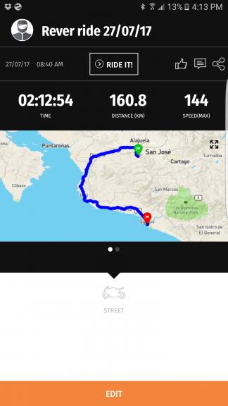

I played hooky today and went to Manuel Antonio to see my cousin who is here on vacation.
It has been 30 years since we met so I think I am ok in skipping work to see him!
Great ride down in the morning, clear and cool and the bike running like a champ.  Less fun on the way back, very muggy and I got rained on pretty hard.
Worth it though for sure!
https://a.rever.co/embed/rides/589698 (https://a.rever.co/embed/rides/589698) here is a map from a new app I am trying
EDIT: BTW my new Russell seat is just brilliant. 4+ hours of saddle time and I got off fresh as a daisy!

After seeing a video on youtube the other day I found the DOT stamp on my tyres - they were manufactured in June 2006!
That means when the PO said it had been laid up -for a couple of years - it appears it was more like seven or eight.  The tyres had maybe 500 miles of wear on them when I got the bike.  Now this is CR so I can see a dealer selling 3 year old tyres but even so that means there were fitted in 2010 at the latest.
So a couple is probably more like six years.
I know I should change the tyres instantly but I am not going to just yet, a pair of tyres here is at least $600 and it is not like I am racing the bike so I will keep riding on them for now.
