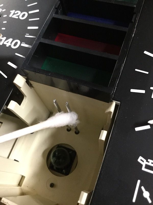

Forgot to add some to the other days efforts.

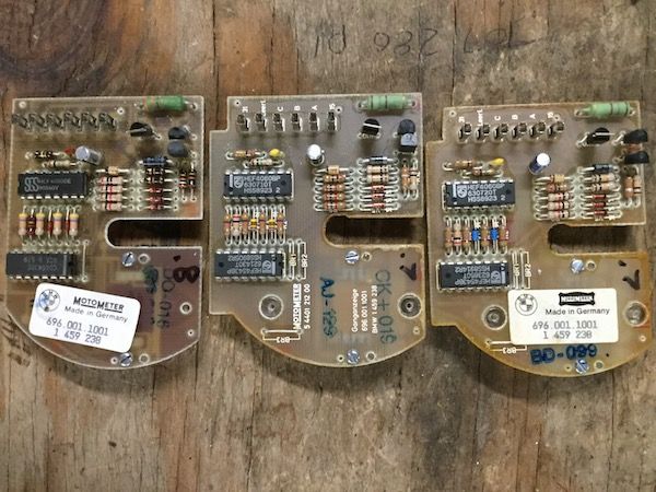

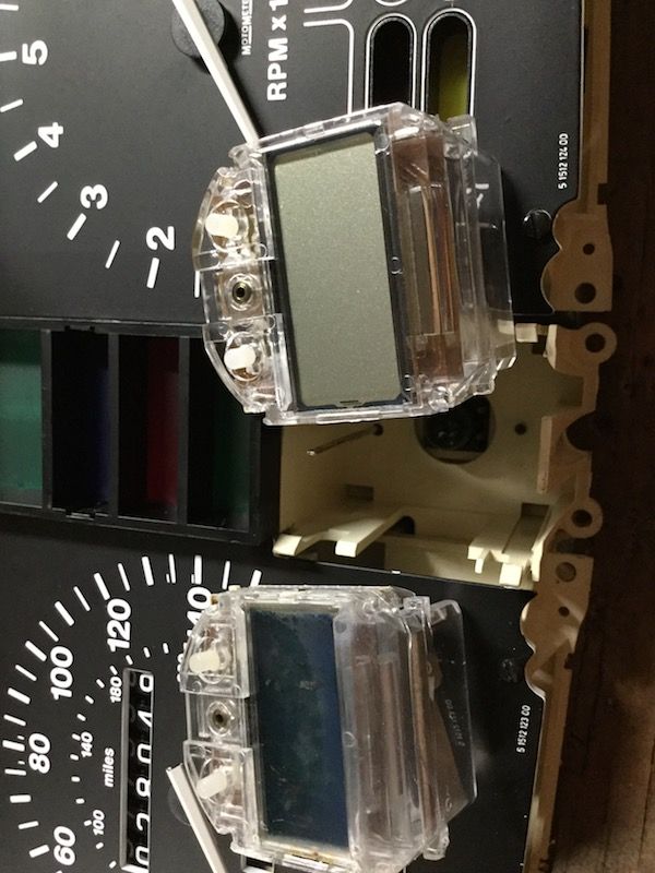

Found a decent deal on a complete cluster from Canada to cannibalize for spares.
While inside I also swapped in the working clock.
Deoxit bath for connectors
Now everything works as intended.
And still have a working spare Gear board on the shelf.
Also, cleaned all the connectors I could find.  Including the 3 for the speedo.
After reading they can be troublesome.

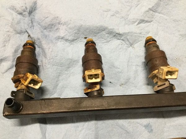

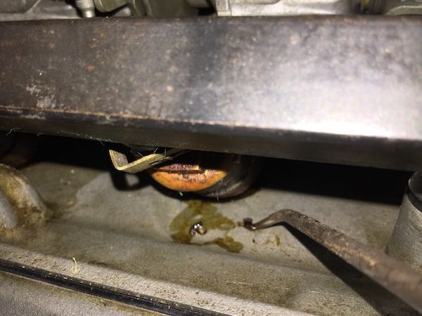

Re: 87 K75C injectors

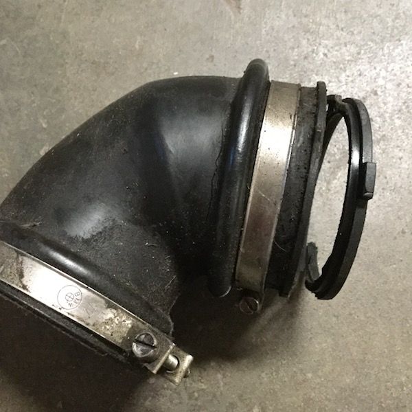

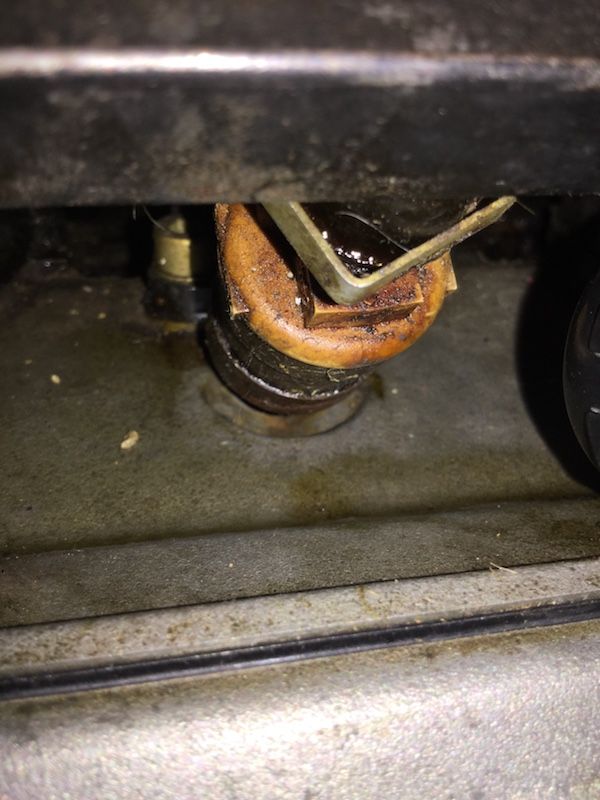

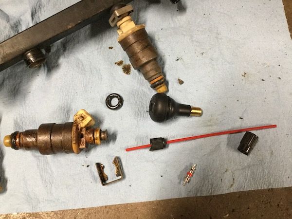

« Reply #209 on: March 12, 2017, 09:27:53 AM »

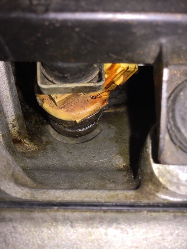

HA!!!  Well this is a $15.00 error,  Live and learn.
The PO had this 1/4 torn off.  And I just kept pulling and prying...til I finished it off.
Found it slips right off the other end REALLY easy.
  • Illinois
  • 87 K75C

« Reply #210 on: March 12, 2017, 10:46:56 AM »

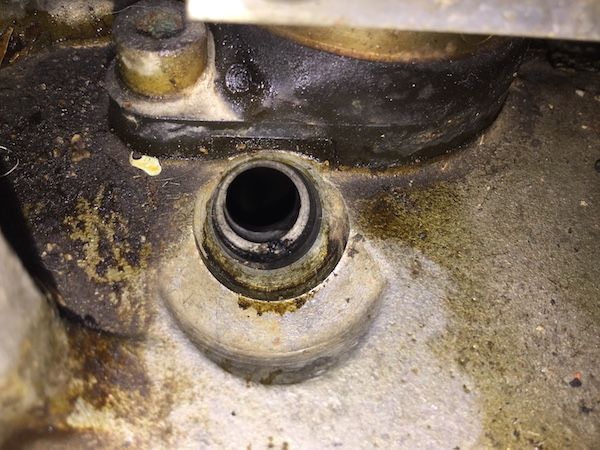

GROSS!  hahaha
[size=78%][/size]
I dont believe any crud got down in there.
  • Illinois
  • 87 K75C

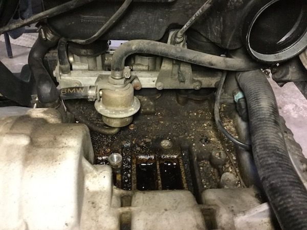

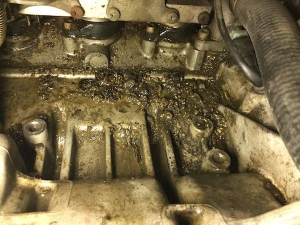

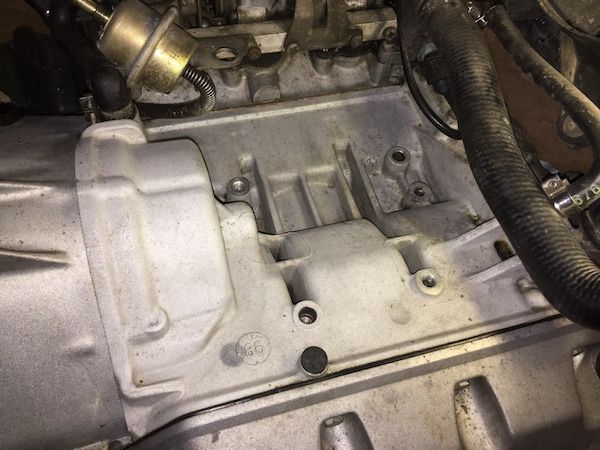

  • Posts: 11299
« Reply #211 on: March 12, 2017, 12:19:32 PM »
GROSS!  hahaha
That's the classic look of a neglected engine though. One member was going to fill the murky indentations shown in your first photo with epoxy to aid future clean up or improve the look for anybody looking in there or something.
  • 1995 K75 89,000 miles

« Reply #212 on: March 12, 2017, 02:58:43 PM »
HA!   :2thumbup:   Maybe I should just level off the whole thing w spackle.

« Reply #213 on: March 12, 2017, 06:36:28 PM »
There goes half a day of my life cleaning the top of the engine...
No one will see....EVER!!!

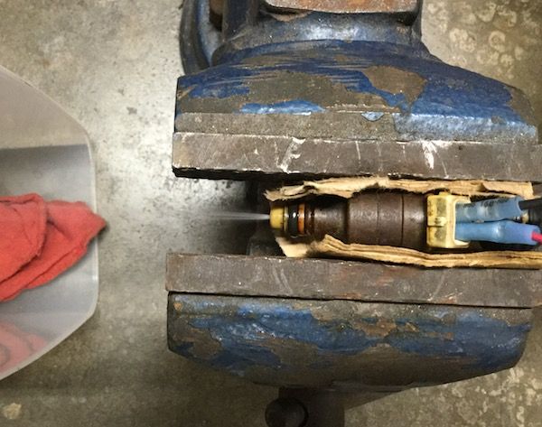

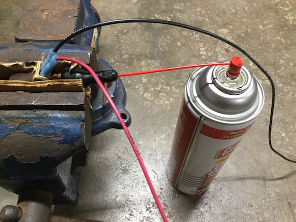

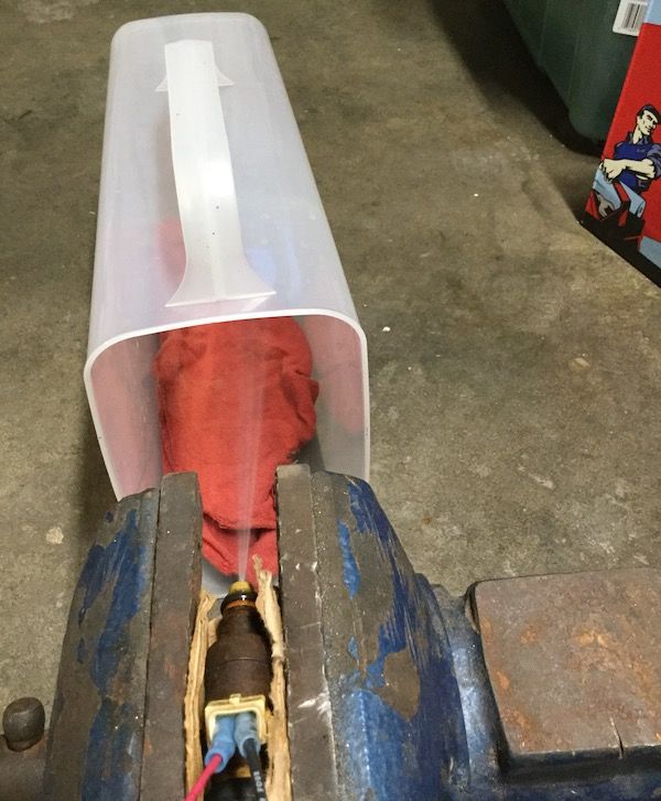

Re: 87 K75C Cleaning injectors

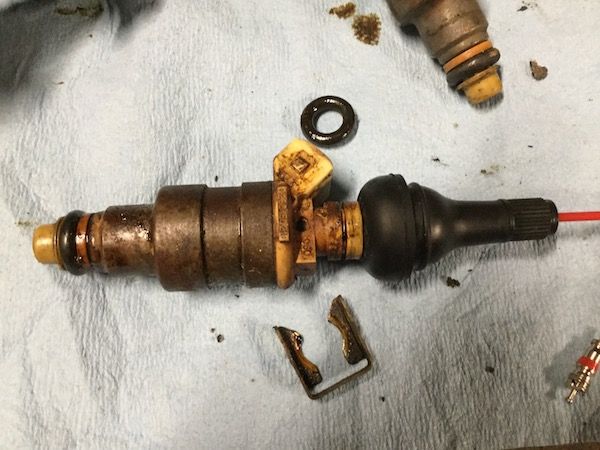

« Reply #220 on: March 13, 2017, 08:36:15 PM »
Carb cleaner is HIGHLY FLAMMABLE...and can be easily ignited by electrical sparks causing fire, damage, injury and death.
AMATEUR DO NOT ATTEMPT!
DO NOT TRY THIS AT HOME.
Everybody probably already knows all this, but here goes.
Sweetest injector cleaner ever.
Valve stem w guts out, i drilled hole in cap just a bit smaller than tube so it fits tight or glue it in.
I pulled o-ring off injector and fit valve stem on the injector, screw on cap w tube.
injector in vise, tube in can.
First- I touched wires to battery to open injector valve.  Second- hit the spray can button.
  • Illinois
  • 87 K75C
