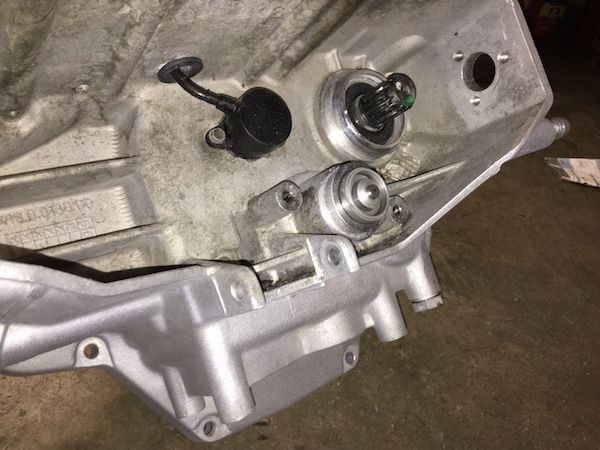

Sounds like the clutch friction disc is out of alignment.  What did you use to center it?
I think you need to pull the transmission and recenter everything.

Phew just got it.  I shifted it into gear gave the output shaft a small turn...aligning the input.  on it slipped right into place.  Wow.

Thanks TMG for your quick response!  As soon as the splines lined up it just slipped into place...smooth and easy.
Thats a pretty tight tolerance in there.  HA

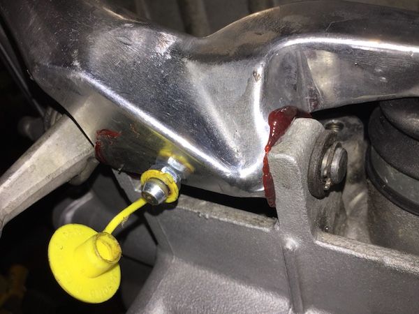

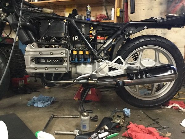

Ok just to catch up.  The reason I started all this...
New gear selction switch.  Heavily coated w plastidip installed.  Also, gave the gasket a coat of silicone that never cures...Time will tell.
Now clean up everything that came off and bolt her back together to check throttle body sync.
Oh and fresh valve stems going in wheels.

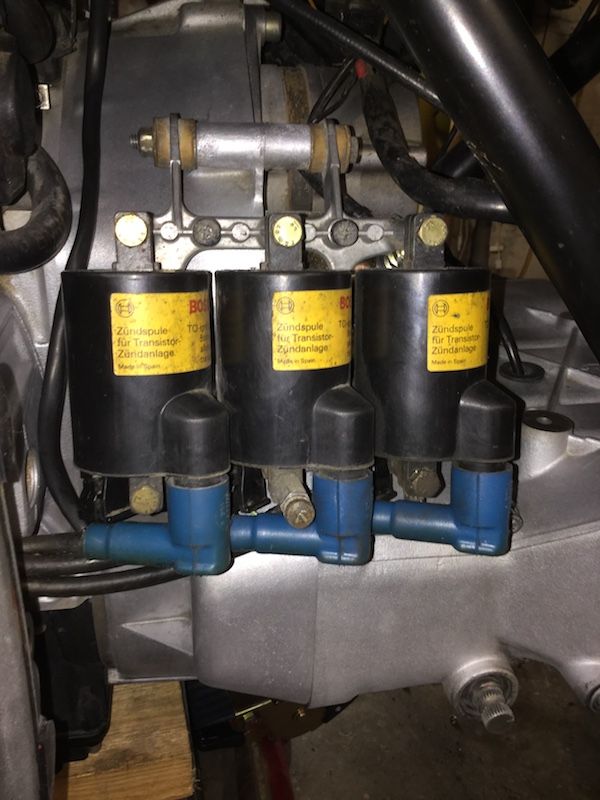

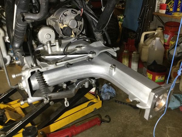

« Reply #183 on: January 16, 2017, 08:13:38 AM »
Funny how things can go.
Spent 2 hours psyching myself up for "The Dreaded Swinger Boot Installation.  I just knew this was going to be a terror.
So, procrastinated by cleaning up and installing coils.
Then, no choice, ugh, cleaning up the swinger.
Got set up, gave it a couple half hearted wiggles and twists...and "THUMP!"  It popped on.
I pulled and twisted and pulled like 50 times...it tugged back every time.  THANK GOODNESS!

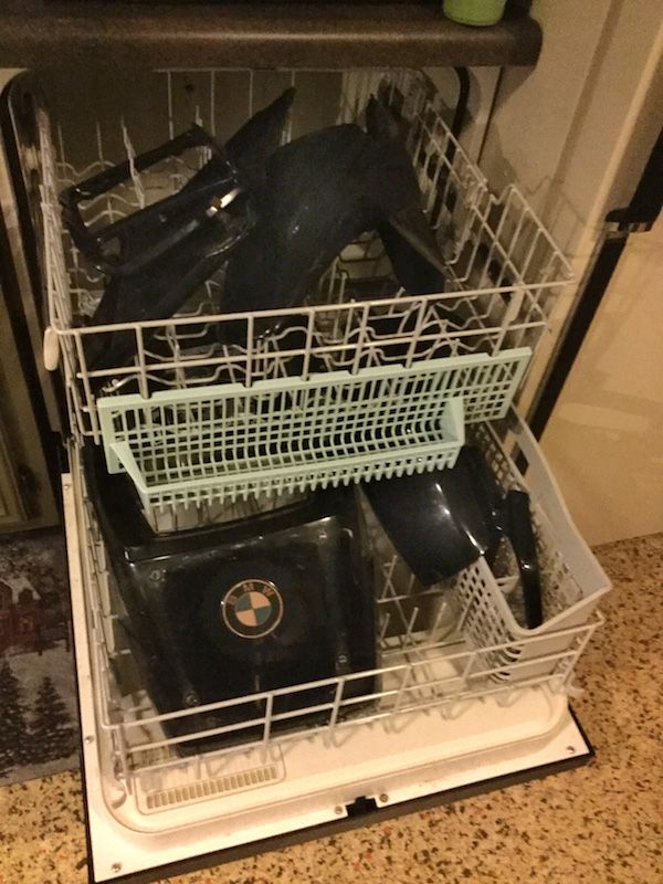

« Reply #184 on: January 23, 2017, 06:40:36 PM »

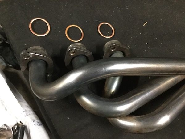

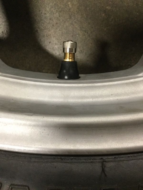

Got the fresh stems installed in the wheels.  I dont have any idea what I was (or wasn't) thinking, not doing them when installing new tires a few months ago.  Is what it is, all good now.
fresh header washers went in.
Cleaning as she slowly comes back together.

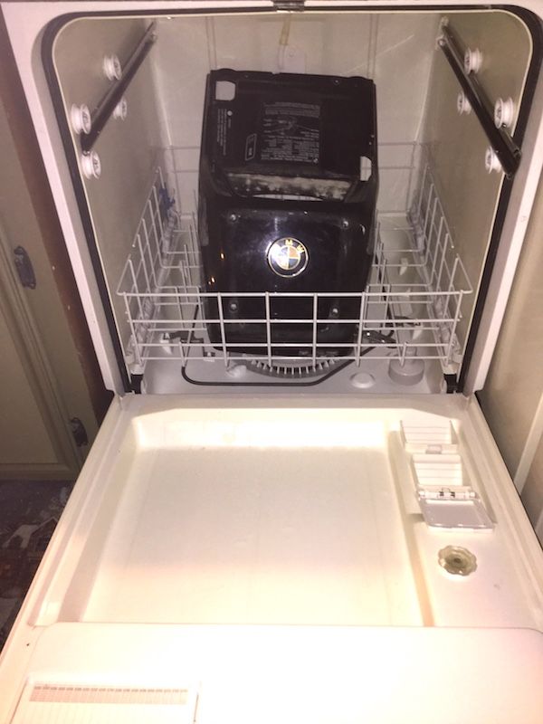

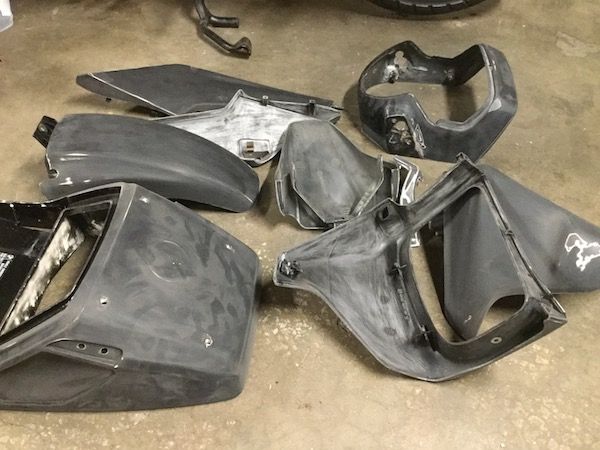

The wife helped me carry and load plastics into the dishwasher.  Had to remove the top rack to fit the tail in.
Once done she said "this will be the last time I put motorcycle parts in her dishwasher/oven."  What up w that attitude?
Spot free complements of Cascade w sheeting action!  Ready for an acetone wipe down then strip/sanding for paint.

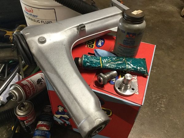

Re: 87 K75C Prepping for paint

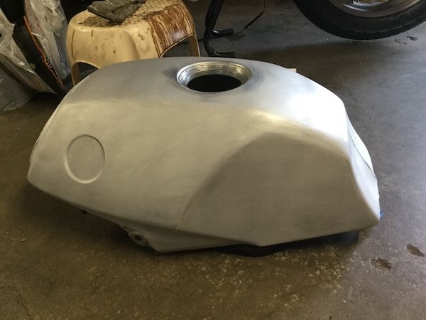

« Reply #186 on: February 19, 2017, 05:30:59 AM »

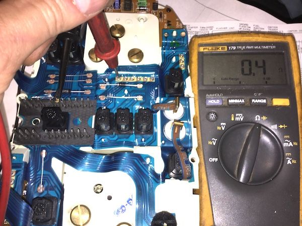

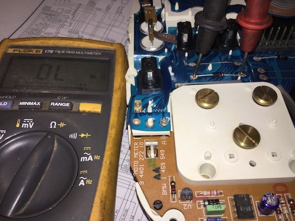

« Reply #187 on: February 23, 2017, 06:15:03 PM »

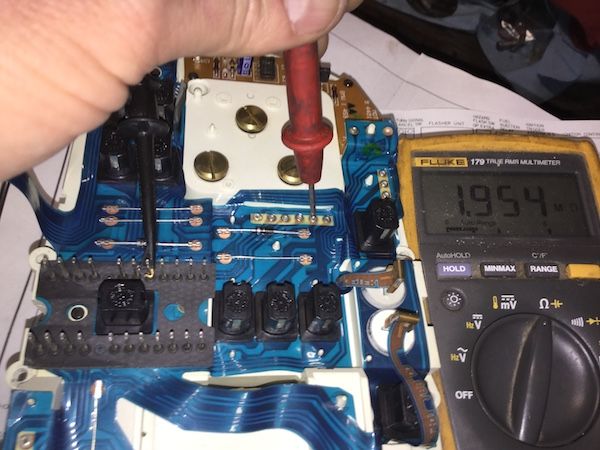

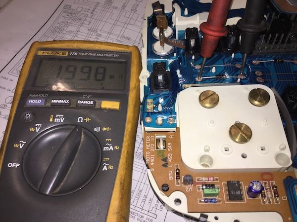

Ive run into a voltage drop issue.  Tank is off bike so fuel pump and sending unit unplugged.
Battery is new and fully charged.  Odyssey 680.
My starter relay picks just fine w the clutch.  12.5v
It does not pic w the neutral circuit.  Dropping 2v somewhere.  Only getting 10.5 to the starter relay coil.
Ive got 12.5v up to and in the instrument cluster.
Gear pcb feeding new gear switch 11.5v to ground on all three leads at the switch connector.
The gear display and neutral light both working fine.  Opened up the cluster, cleaned the pin connections to the gear selector pcb.
checked the ribbon cable and diode.
Reading 1.998 meg on diode, not sure what it should be?
Any help you can offer would be appreciated.
I also unplugged the load shed, fuel injection relays and the 12pin connector at the cluster not associated w the gear selector pcb.
  • Illinois
  • 87 K75C
  • Posts: 11645
Re: 87 K75C Help needed hunting 2v drop.
« Reply #188 on: February 24, 2017, 10:52:42 AM »
It does not pic w the neutral circuit.  Dropping 2v somewhere.  Only getting 10.5 to the starter relay coil. Ive got 12.5v up to and in the instrument cluster.
You've probably tracked down the problem by now, but maybe it's in the wire connecting the cluster to the right handlebar combo switch connector or within the connection's components.
Thanks Laitch, Its looking like the issue must be one of the components in the gear selection board.  Currently working w rbm to figure it out.  So long as his patience w me holds out.

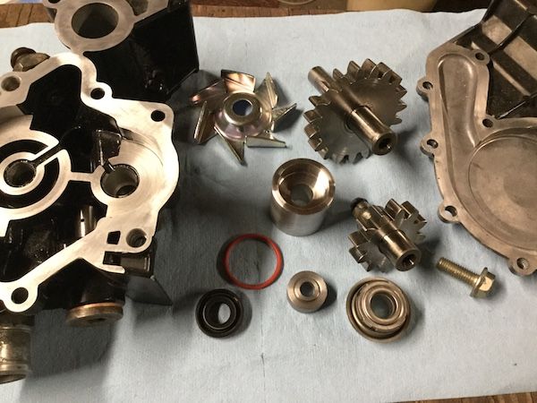

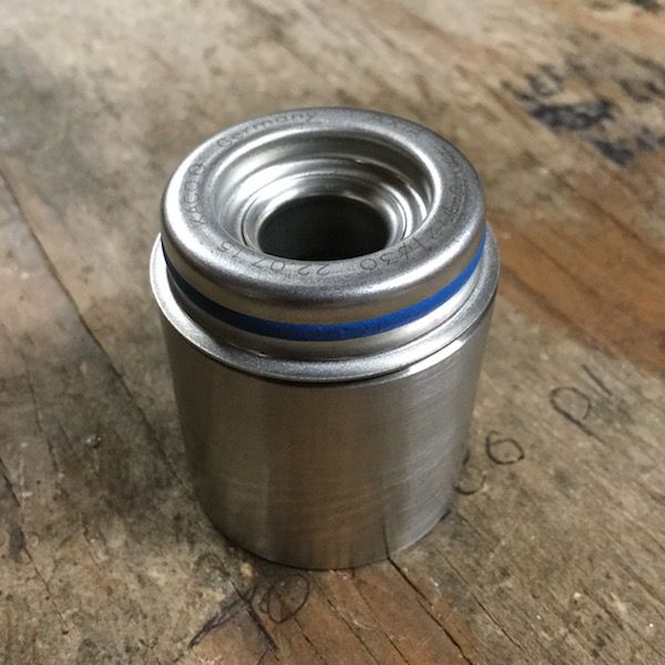

Re: 87 K75C "Proper" pump re-re-build 2.0

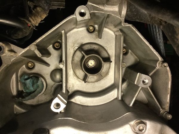

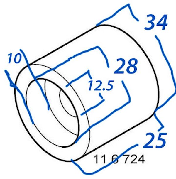

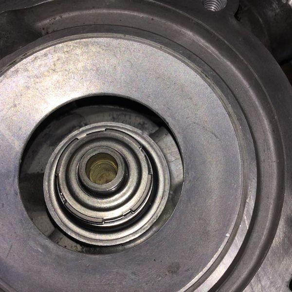

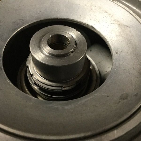

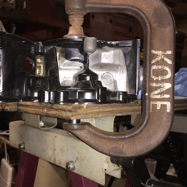

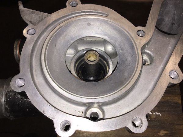

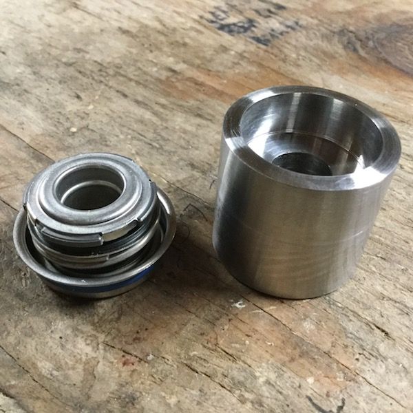

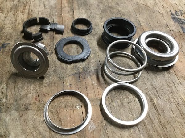

« Reply #193 on: February 25, 2017, 07:22:22 AM »
After rebuilding the pump I found out the old cast impeller cant be used w the new seal.
Also, after the first rebuild.  The pump wasnt leaking but I didnt feel very confident about using sockets and a hammer to pound the seal onto the shaft.  (youtube "DIY" vids)  So asked my buddy to make me a proper installation tool.
So rebuild 2.0.
Upon disassembly I tore the seal apart to see how it was made.
As suspected I Found it is a VERY fragile thing.  Its made up of 9 separate components.  A ring inside actually appears to be nothing more than a brittle, soft compressed graphite like material.  Its soft enough that I can write with it like a pencil.  And crack it to pieces w my fingers.
Probably easily damaged under percussive shock of using a hammer to beat it onto the shaft.
Installation tool.  The OD of 34mm is bare minimum.  It can be up to 40mm OD.
I lubed up the oil seal and shaft w 90w and installed them.
Then thoroughly cleaned and dried the shaft w acetone.  So the coolant seal wouldnt be prone to spinning on the shaft once fitted.
Rather than pounding the thing w a hammer.  Or, fumble farting around trying to turn it onto the shaft using the bolt.
I used a C-clamp to gently press the seal onto shaft and into housing at the same time.
This method worked out GREAT.  I am really confident about the job.
Filled the small space between the seal and shaft w Permatex water pump sealer.
Torqued to 33nm and ready to go on the bike.
Dont know if its for the best.  Maybe threebond would be better.  But, Using Ultra black to seal oil pump/engine surfaces and waterpump sealer on the cover side.

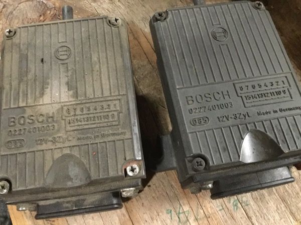

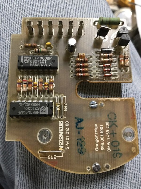

« Reply #194 on: March 09, 2017, 06:59:06 PM »
RBM saved me!  Thanks to his patience and willing to share knowledge.  He hung in w me.
Replaced the Gear Selector board and Ignition control unit along w a new stock starter relay.
  • Illinois
  • 87 K75C
  • Posts: 11645
Re: 87 K75C GSB and ICU gone bad.
« Reply #195 on: March 09, 2017, 07:30:31 PM »
Thanks for the update. Any understanding why the gear selector board gave up the ghost?
Offline trek97
  • Posts: 200
  • The Anti-Cafe racer
« Reply #196 on: March 09, 2017, 08:31:15 PM »
rbm believes both issues were EMF caused by the collapsing field from the unprotected Trombetta starter relay I had installed.
Who am I to argue w that?  ha.  Im just a relay logic guy...not the solid state sort.
