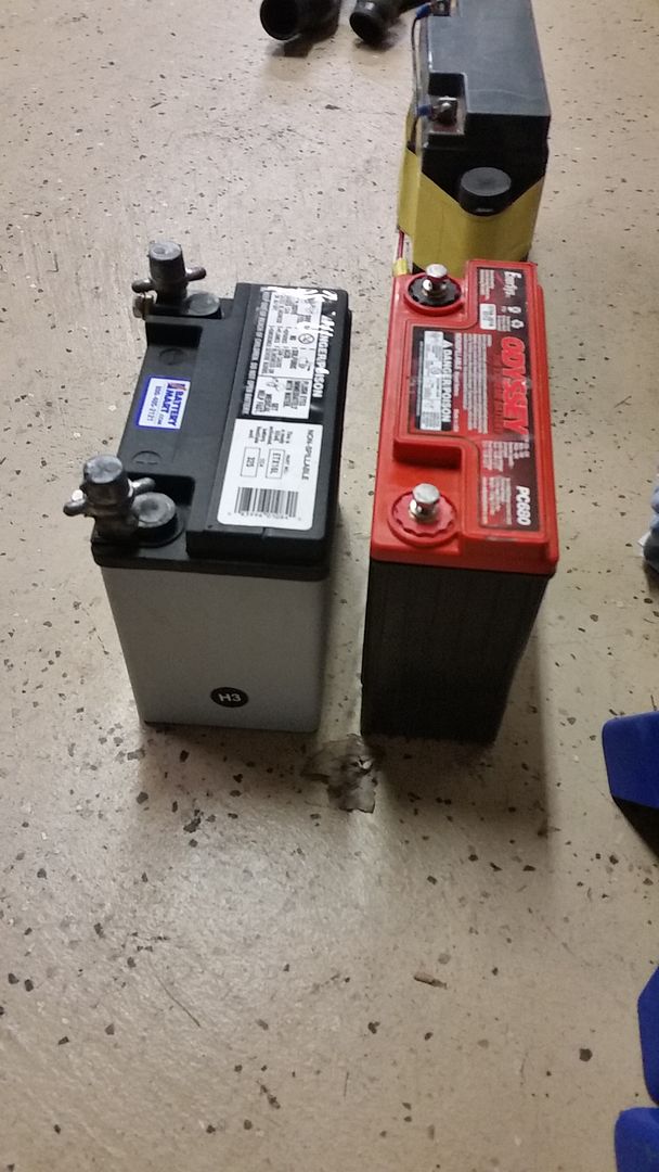

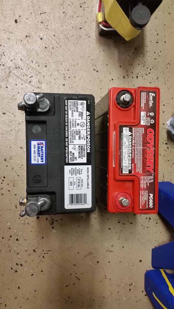

agree with scott.  you need a new charger, and a single new battery.  there is no reason to have two with the quality of AGM these days.  smaller, lighter, sealed, don't fade when stored like wet cells do.
pic of the two candidates i mentioned above.  i use these batteries in my race cars too.  no issues spinning a high compression 2.5l engine.  both fit with no mods in a brick.
I agree with Marshall except pick the one with the black case. A white case lowers resale value, unless the bike's white, of course.
