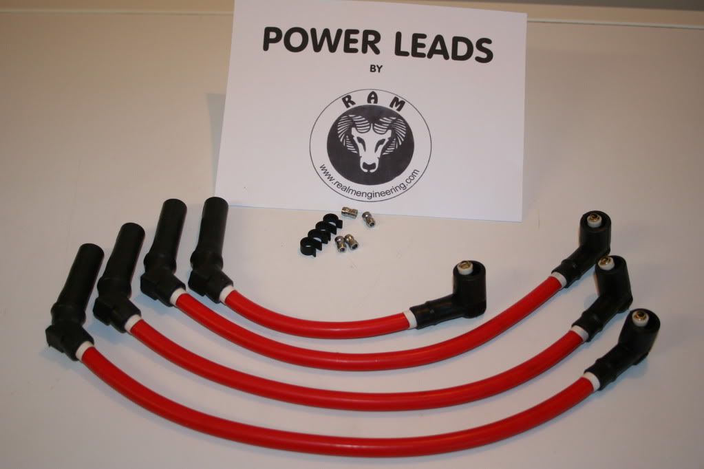

Ignition wires are one of those items - like shox - that get generally ignored when maintainance time comes around [ out od sight ??? ] HOWEVER - they don't last forever and a simple check as to their general condition is to remove the plug cover in darkish conditions and run the bike. Every one of those arcs and flashes is power that's not getting to your plugs !
The RAM wires were developed especially for the Kays in an effort to get quality product at a resonable price. Forum members get 10% discount - tell them TJ sent you.
These are 8mm Hi-Po wires and come with factory fitted terminals.
And a bit of deja vu here - spot your bike !!!! [ No prizes ]

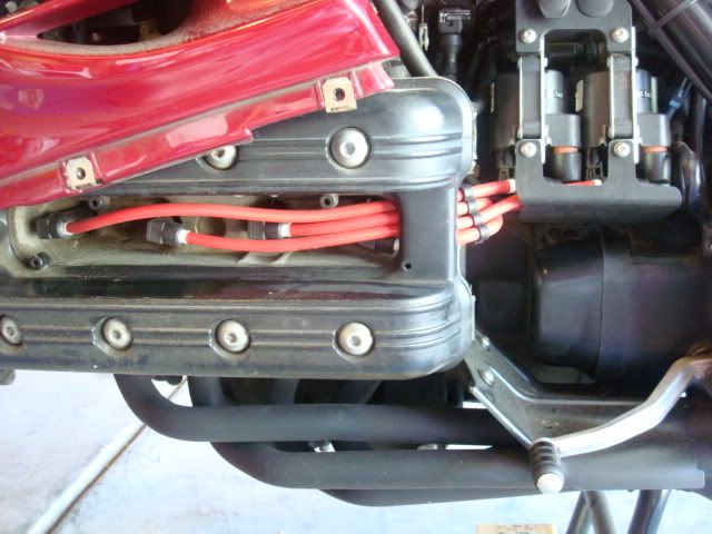

Actually that's Steve's '93RS that he sold a couple of years ago.
Here's mine.....
I also have the Red wires on my red bike, but I don't have any pictures....
Offline beachcomber
Here's mine.....
Thanx for the ident Scott .................
Somehow I prefer the Yellow - back to the old Hot Rod days I guess.
However .... The only colours now available are Red / Black. Black was originally made available in 7mm only for those who wished  to keep an "original" look. Now available in 8mm, same as Red.
Wires all trimmed to correct length and numbered - even I can get it right !!
Neat installation BTW - did you find the pre-set lengths worked OK ??
Wire seperators and plug nipples still included in kit.
Thanx for sharing.

Beach, the lengths were just fine. I did only seem to need 1 of the wire separators.
No more yellow? that's a shame. I like how it stands out.
