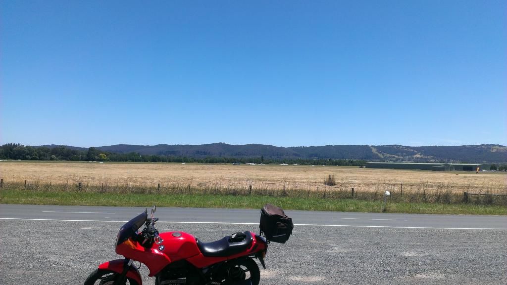

Today my brick saw the light of day for the first time. Club plates on and beautiful skies.
What did I do? …. I rode it !!
