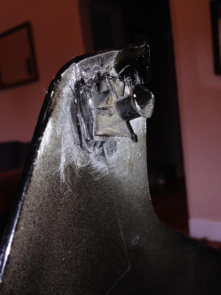

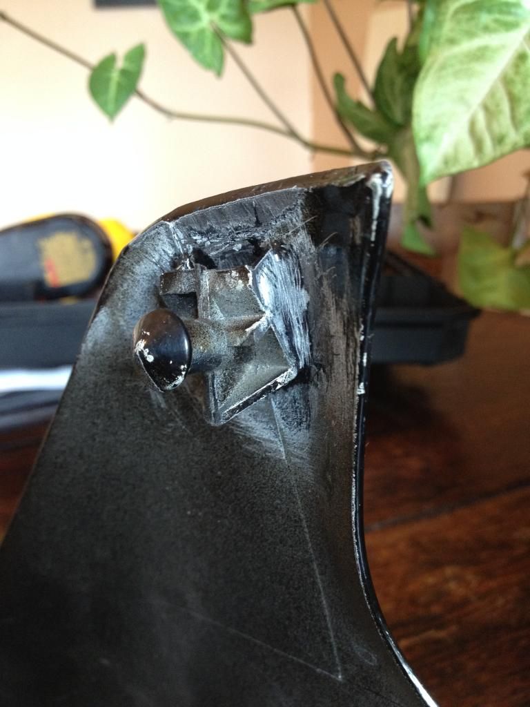

I tried to repair the broken boss on the radiator trim.
Tore off the fiberglass repair attempt leftover from previous owner.
1. Sanded area well on boss and on panel.
2. Cleaned with soap and water.
3. Wiped down with rubbing alcohol just cause it was there.
4. Mixed some plastic epoxy and applied to boss edges and panel.
5. Ran a bead around the edges and let it dry a day.
6. Went back and sanded again.
7. Applied another layer to try to get wider contact patch.
8. Let dry a day and installed.
We'll find out if it worked next time I pull it off!!   :dunno2:
