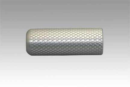

« Reply #366 on: May 07, 2012, 06:38:59 PM »
Made a new shift lever for my K75.  I already have one on my K1100RS and like it.  It's a K1100 shift lever with an Ilium Works shift lever extender:
I suspect the diagonal hatching on it might cause more rapid boot toe wear so I covered it with 1" heat shrink tuning.

« Reply #367 on: May 07, 2012, 11:20:44 PM »
I suspect the diagonal hatching on it might cause more rapid boot toe wear ...
It does, I have a similar cover on mine.  Good call on the cover.
