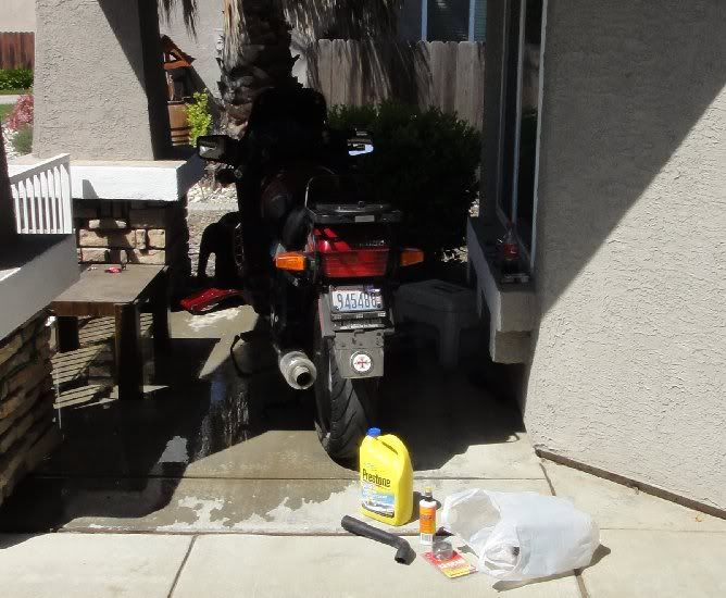

BUT when I hit Carmel the hose from the radiator to the water pump blew about a 3/4" gash in itself and peed out most of the coolant.  I made it to Santa Cruz until the dreaded Motronic overheat light came on so I pulled into a parking lot and was forced to do something about it.
I called the two BMW dealers that were within 25 miles of me but my bike made the mistake of blowing up on Monday, when all of the dealers are closed.
Fortunately, I found a shady parking stall and there was an auto parts store only a couple of blocks away.  The radiator hose repair tape they had was complete shite but I was able to effect a temporary, though still somewhat leaky, repair with that and some zip-ties.

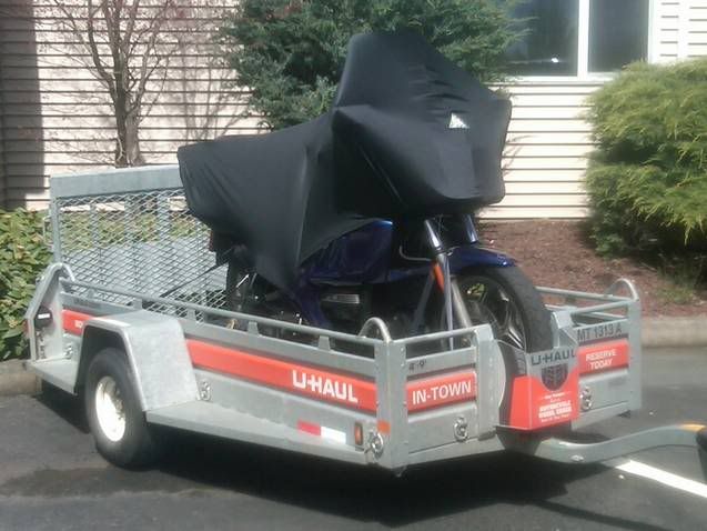

I called Roy S. and asked if him if he could put me up for the night if I were able to limp to his place.  Being a true morobricker he said no problem.  Once I had things together and some coolant back in it, I hit the road. With a little experimentation I discovered that the speed which balanced the heat generated by the head against the cooling of the wind rushing past to minimize the stress on the cooling system was about 70mph.  If you have a crippled bike that needs to get somewhere 165 miles away then 70 mph is a good thing. :2thumbup:
I made it to Roy S's place a little before six.  He was already taking the low seat off of his recently purchased K75RT so that I could use it to retrieve a new hose from A&S in the morning and wouldn't be cramped riding a low seat but put a Corbin Dual Tour on instead. (Fingers crossed that they had one in stock.)  Not only that but he'd gotten me some fresh Heineken which was coolly waiting in his garage fridge and very much appreciated.  Roy certainly has earned Motobricker of the Week/Month/Year for how helpful he was to me. :mbird

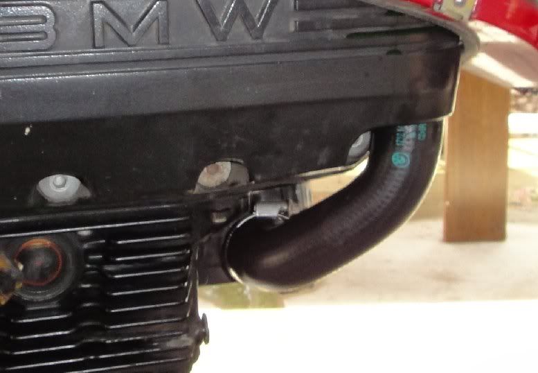

And then I installed it.
