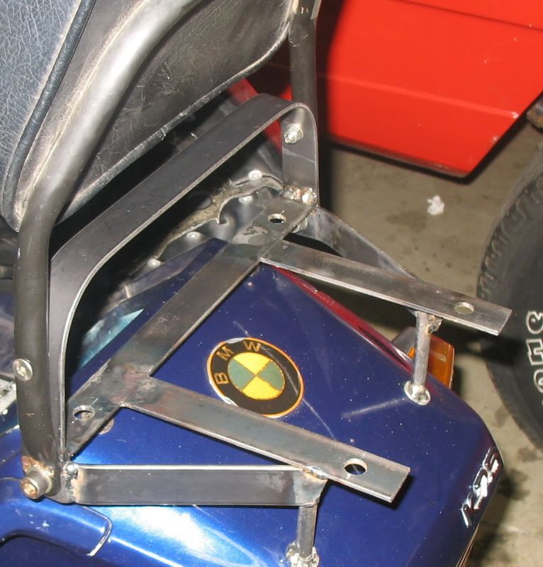

I built a tail rack that mounts to the stock rack mounting holes and will hold a Reynolds rack back-rest.  Quite strong but as is usual for me, not pretty.   :laugh  After I paint it, I'll mount a 12" x 16" x 1/8" aluminum plate on the rack for holding whatever soft bag I decide to use.
Confused of WHY one would ever hack up a perfectly good Reynolds flat rack ?  Possible your flat rack is a different design than mine.
Quick release mounting plate is the way to go.
Please explain the back rest further. It only mounts via the front holes.
Reynolds flat racks are ANIMALS for strength due to the underneath strut support engineering.
Ha, watermelons, cases of bier,HUGE CRT computer monitor,etc., have been transported.   :bmwsmile :bmwsmile
My bad, you fabricated a DIY flat rack. Good job, as I was under the impression it was a Reynolds with the curvature. Sorry about the misunderstanding.
The 4 OEM mount holes are for a bracket that fits to a BMW topcase.  Did you already have the holes or DIY  drill ?
I whipped up a custom "shelf type" luggage rack for the GS.
IMHO, BIGGER is always better for flat racks.  EASY to covert back to the standard top case/tour box arrangement using shorter bolts, as the top case mounts with side flanges instead of underneath latch points.

« Reply #241 on: April 08, 2012, 11:46:58 AM »
This is not a cut-up Reynolds rack.  I have one of those too (still in one piece).  It will mount the Reynolds _back-rest_, which was a design requirement for this rack.
I used the holes from the factory rack as mounting points.  I can mount this rack to either of my K-bikes or any other K-bike I purchase in the future (assuming it has the factory rack).
As I indicated I will mount a piece of aluminum plate to it.  In theory, I could mount any size aluminum plate I want.  12x16 should be about right.
I had several reasons for doing this.
1) The Reynolds rack is large, heavy, a pain in the ass to mount/dismount and you're left with the holes to cover/fill.
2) The factory rack is not flat.  That has always irritated me.  The rack on my Triumph Tiger was flat, I just mounted an aluminum plate to that, no problem (I also built mounts for the Reynolds back-rest that I could attach to that setup too).
3) I thought I could build a rack, using the factory mounting holes where the load would be carried slightly forward and lower than a load on the Reynolds rack.  The rack would be lighter than the Reynolds rack.  And, since I'm using the factory holes, I'm not left with something to cover/fill.
4) It seemed like a fun project, where I would end up with something useful.  IOW, it seemed like a good idea at the time.  Building stuff beats the hell outa watching TV.
My youngest son and I are planning a  (~4700 mile) moto-camping trip to CO this summer and the "back-rest" on the 22 liter case leaves a bit to be desired.  Not to mention that the 22 liter case just isn't big enough for two-up camping.  So I was going to either have to mount the Reynolds rack or build something else.

« Reply #242 on: April 08, 2012, 11:50:13 AM »
Where did you get the "shelf" for the rack in this picture?  Did you make it?
I like the lip on the trailing edge.  It looks nice and I'm guessing helps hold a soft bag in place while tying it down.
Tom
  my opine:
*once a Reynolds flat rack is mounted, it staying there permanently. YES, it is a royal pain in the ass to install.
* confused about it's NOT flat terminology, mine is, various brands of top cases, all with the same quick release mount on the bottom, have been outfitted over the years.
* far stronger using the OEM one piece struts.
* trailing edge flat rack for the GS was hand fabricated, versatile, works well.
Did you spot the motobricK bling on the rack ?  (K 75 spark plug cover)

« Reply #244 on: April 08, 2012, 02:23:54 PM »
  my opine:
Yeah, my K75 had the Reynolds rack "permanently" mounted for many years.
The factory (K-bike) rack is not "level" may be a more accurate description.  That has always irritated me.
Over the years I've found that I prefer soft luggage on the rear.  It can expand and contract and is, in general, a more flexible device.  So, I'm not looking for a place to attach a hard  bag.  I'm looking for a platform for tying down a duffle or some such (I have the mid-sized moto-fizz bag from Rider Wearhouse for example).  Something very similar to the rack in the picture on the back of the F650GS is what I want.
I'm not sure what you mean by, "far stronger using the OEM one piece struts".  Strength was a concern for me, especially using the tail section to carry the load (the Reynolds rack does not but they were selling a commercial product and I'm not).  I've run the 22 liter case full of water bottles and it managed w/o any issues.  I'll keep an eye on it for a while, going on shorter trips w/ less weight to start.
No, sorry, I missed the K75 spark-plug cover in the picture.  Is it the "handle" on the top of the side-case?
As an aside, another design I considered was to take an aluminum (or a thinner piece of steel) plate and cut and bend the edges front and rear such that they fit into the slots in the factory rack.  I abandoned the idea (which I still think would be a good (light weight) way to go) because I had the requirement of mounting the Reynolds back-rest and I could not see a "good" way to do that.  The back-rest has to be mounted sturdily enough to rest ones back on.
Tom
