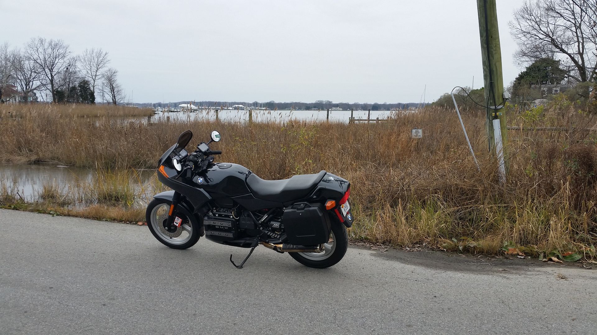

Went out to the shop and started up one of the bricks.  Warmed it up on a 100mi ride along the MD shore.
