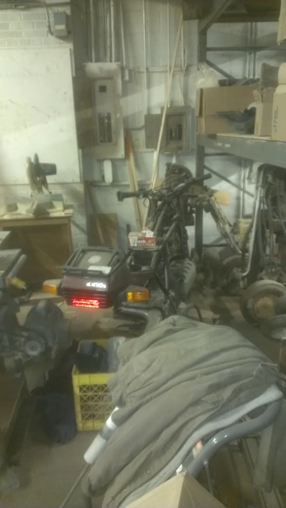

bike is currently stuffed against the wall surrounded by power tools

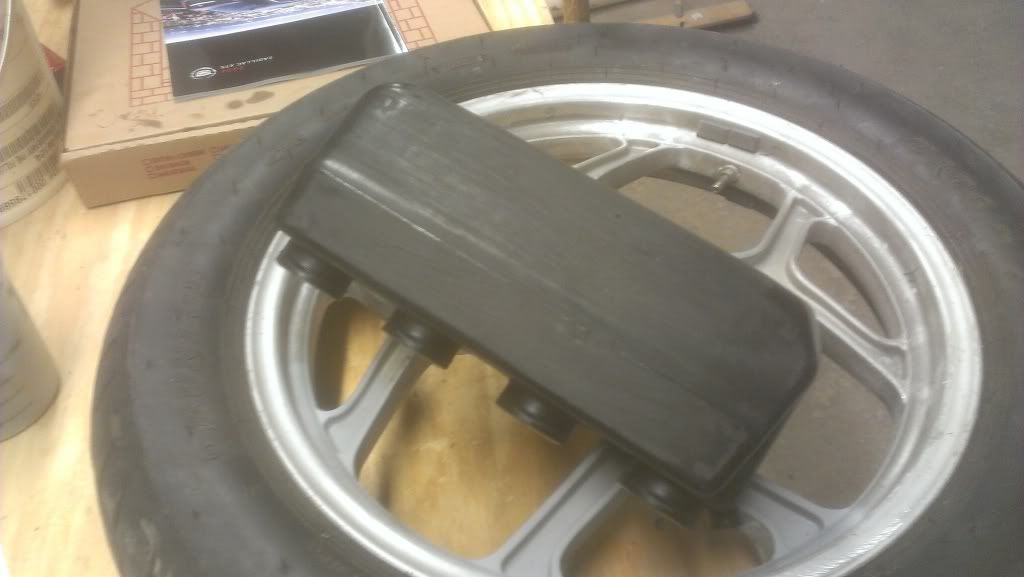

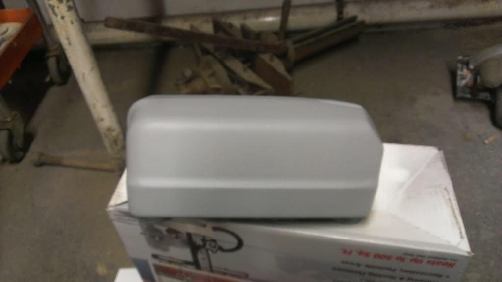

sanded the airbox
primed it

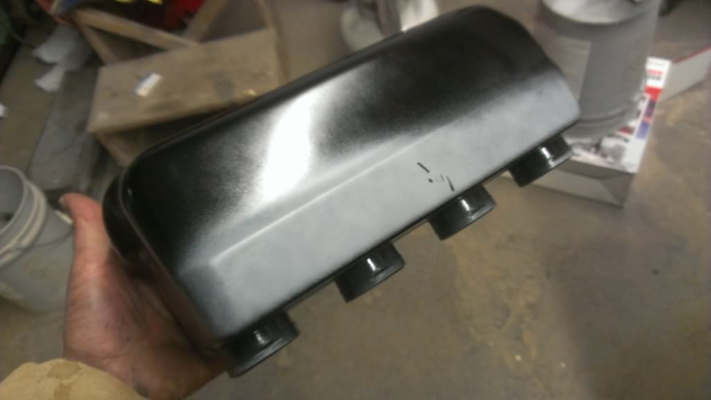

painted it
went to put on one more coat, grabbed the wrong can
got pissed and went to put it away, smacked it into something else on the shelf and jacked the paint

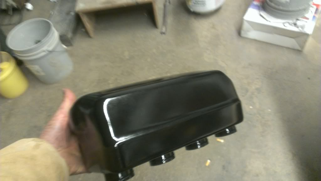

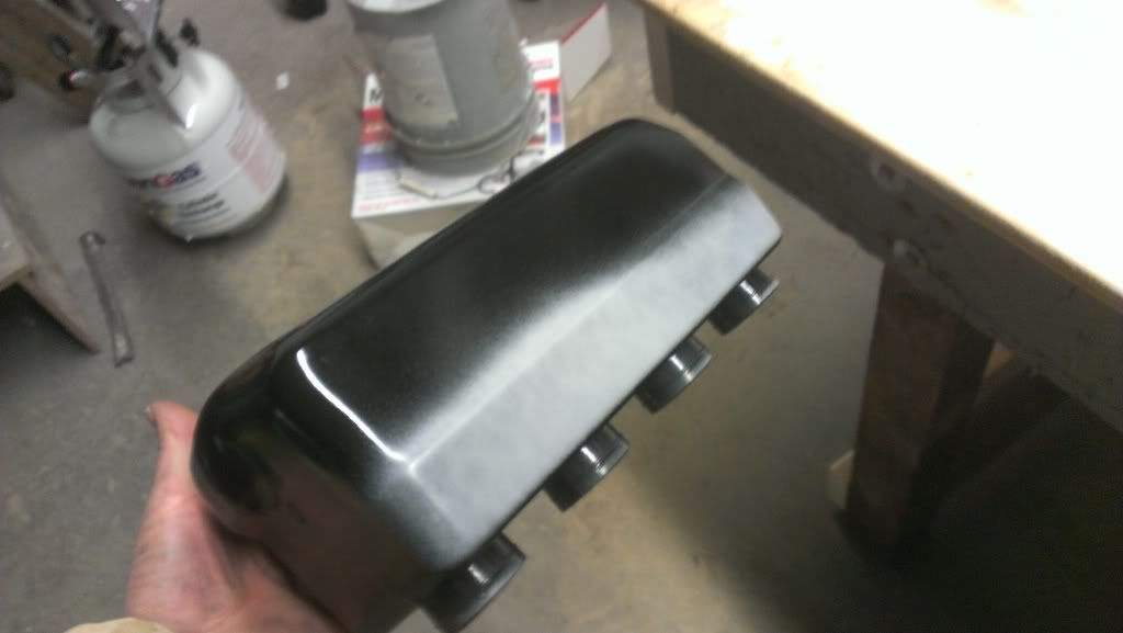

also finally got a GOOD coat of paint on the intake plenum
