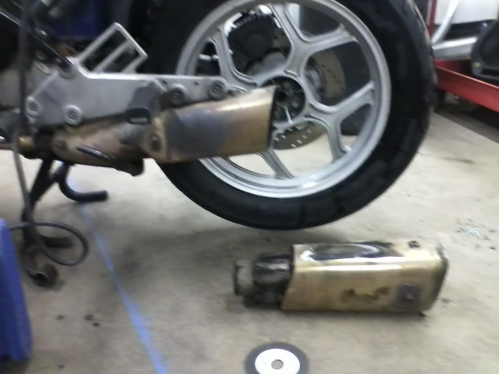

Took a leap, cut down the exhaust to display the single sided swing arm, and because i want to experiment w/ the exhaust note. The stock muffler also has a Heavy coat of rust transfer from the old heat shield AND has mild steel mounts welded on for said shield. It would never be pretty again anyways ...
I have a love / hate relationship w/ the current exhaust note.
I plan on welding the original muffler cap back on in a shunken form, along w/ some of the removed baffeling ... we will see how that works out.

Quote from: HotRodKid;3466931
Primed fork legs
Painted block
pulled teh frame off, painted it and the folk legs
Painted the trans case
Starting reassembly.
Cleaning up the muffler. 2 heat sheild mounts were poorly repaired and need to be patched w/ stainless wire. Final step will be to sandblast the muffler and pipes to hid all the surface inperfections.
cleaning the TB's
