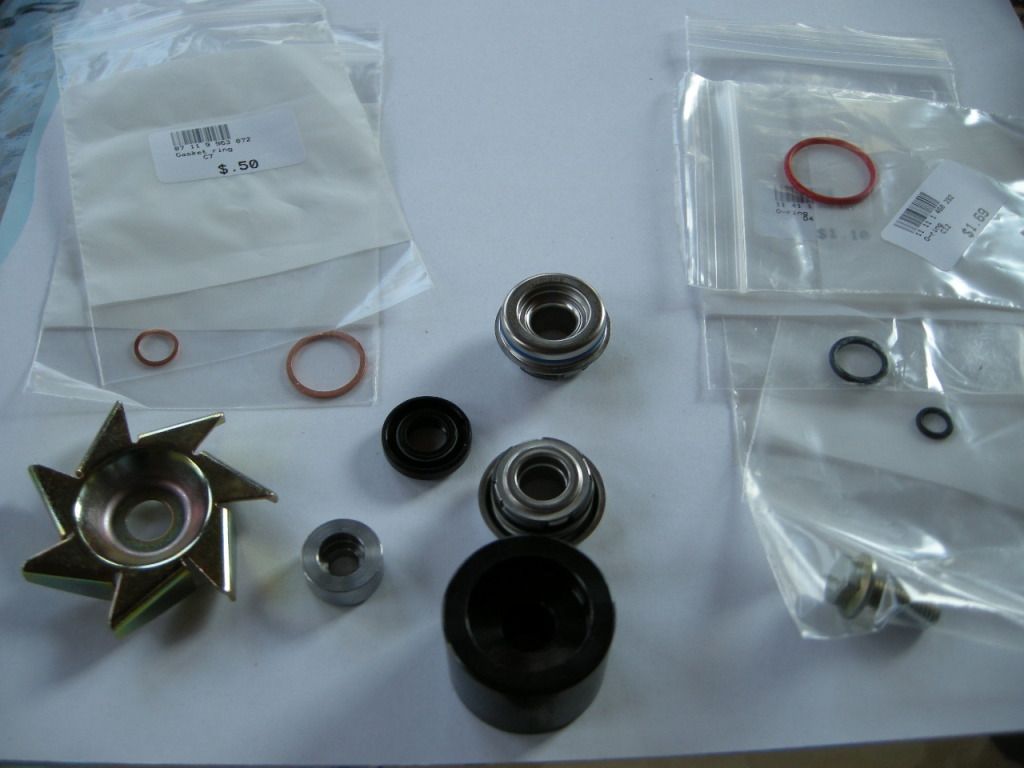

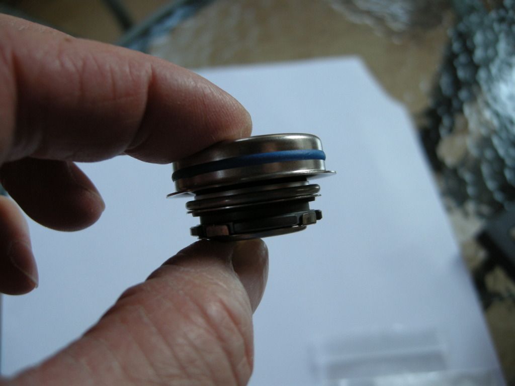

« Reply #31 on: April 29, 2012, 12:20:22 PM »
I just received my parts from Max BMW (I have to admit, they are very proficient and proactive to helping those novices like me).
Since BMW parts are much much more expensive in Canada, I ordered some crush washers and a few extra seals just in case. I also ordered a spare Slip-ring seal and purchased the BMW Press-in bushing tool; Slip-ring seals are almost $40 in Canada. I will tackling this job next weekend, time is at a premium right now.
There appears to be a different type and amount of "blue colour" on the Slip-ring seal I received. Here's what I have on standby for this job:
93 K75S Mystic Red
IBA #9469
Do you mind if I asked what the total package ran you?  What parts did you order for the job?  I know it's on my horizon, so I am just curious.  Thanks!

It would be a pleasure to assist another fellow rider, that's why I posted the picture. The entire order was $111.47 + shipping/handling. I ordered two Slip-ring seals and the tool. I don't even know if I need the rotor and screw, but I don't care at this point in time; it's only $14.26. The big ticket items were the rotor, spacer bushing, shaft seal, slip-ring seal and press-in bushing.
Talk to Rusty Gill at MAX BMW, he was very helpful and professional. He sure knows his stuff.
