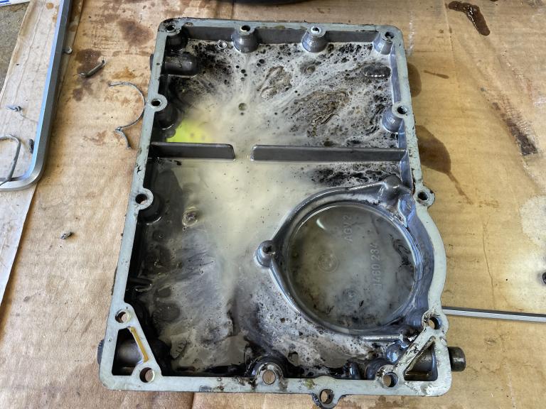

This morning I dropped the oil pan while investigating the pump, and yeah, that ain't so great.
* 20260906_182359645_iOS.jpg (88.31 kB . 768x576 - viewed 136 times)

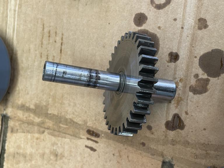

Still not sure this is the smoking gun, but the pump drive shaft is damaged, though not terribly.  Anyone have experience?  The weep hole had a blob of sealant in there, but wasn't attached and didn't seem like enough to block drainage.

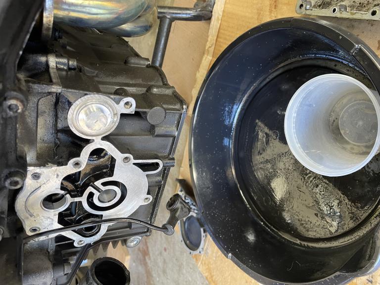

I also found a thread this morning where someone was getting large amounts of coolant into his engine and he apparently had a cracked block.  https://motobrick.com/index.php?topic=11379.25 Figured I may as well try and eliminate that as a problem so I turned a plug to fit the block, disconnected the radiator hose on the left side and poured a liter or two of water into the radiator hose.  The plug doesn't seal perfectly so I put a cup in the catch pan to segregate it from any real problems and went in to have lunch.
* 20260906_193809174_iOS.jpg (83.31 kB . 768x576 - viewed 132 times)
So at this point, the engine had compression, it runs well, but it's getting a lot of coolant into the oil.  Is it possible the pump rebuild was done poorly and it really is the issue?  The only thing that looks iffy so far is the pump shaft and my desire to spend $200 on a replacement part, not to mention $50 for another rebuild kit.

Re-reading the initial posting, and looking at all that water in the exhaust gas and the sump, I'm leaning towards the water pump repair being a bodge job. I think you are on the right track with that. Someone here who has done a water pump overhaul before should have the necessary know-how on that job.
Will the pump shaft polish up to remove the damage, or is too far gone? Did the seller say who'd done the pump seal work - them, or a bike shop?

I don't believe the water/oil pump can introduce coolant into the engine oil system.  If you will notice there is about a 10mm gap in the cavity between the waterpump seal and the oil seal inside the combined pump.  That cavity is where the coolant or oil leakage past those seals drains from at he bottom front of the oil pan.  The only place I see where that can happen is through the head gasket or a cracked block as mentioned before.
