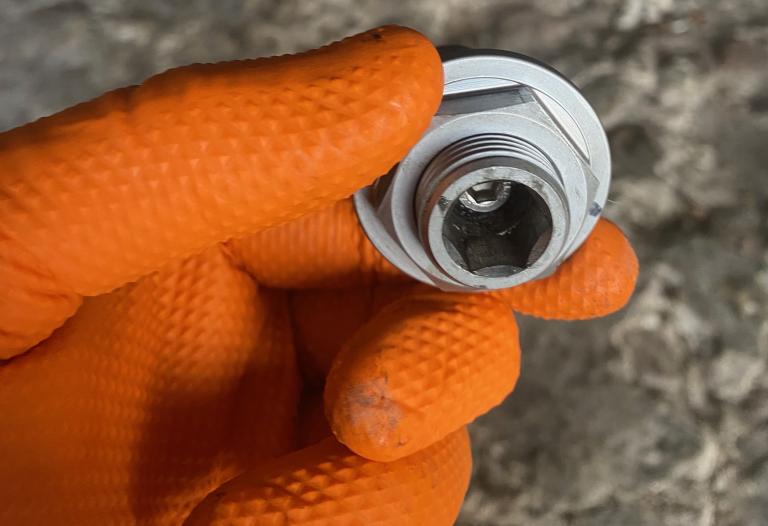

Was that flange nut being used on the pivot pin in the photo before this repair?

Hi Laitch,
It's not a flange nut, one side is a fixed pin and the other (the side you can see) is adjustable).  The pin on that side it tightened up relatively loosley, so the final drive is almost supported,  then the ring nut is torqued up tight.  I've upgraded to a set of motorworks' bearings which are easier to grease, but the only torque spec is "don't over tighten", hence why I've marked it to make sure it doesn't loosen off.

That's called a flange nut over here, anyway. I guess we're still separated by a common language.  :laughing4-giggles:
I didn't recall that aftermarket assembly, but it seems popular with those who have installed it. Anyway, I'm more accustomed to seeing an OEM plain nut locking the pin. It's frustrating to finish a job and have a glitch like that. If it isn't the bearing associated with that adjuster assembly at the root of this, more disassembly could be necessary.

Hi Laitch,
The nut is similar but there's no flange, just a symetrical flat ring nut.

Thanks for the photo of the nut. The prior photo looked like it was flanged.

Hi Laitch,
It's all back togeteher again now, looks like I got the shim from the old part and the replacement mixed up.  They look identical, though having now learned the importance of the thickness, I measured them both and it turns out there's a 0.2mm difference.  I disovered another method of testing the preload, the "drag method'.  I thought that the drive should just spin free but apparently there should be 1.1-1.8NM drag.  Once I put the right shim back there was some resistance when I tried to turn it, but not too much. Now it's back together and there's no knock.  I'll call into my local bike shop and get them to test it properly later this week as I don't have a torque meter that can measure that low.
Also, I must apologise.  I discovered that it is indeed a flange nut on the bearing.
* IMG_1721.jpeg (40.69 kB . 768x526 - viewed 534 times)
I'm guessing they've added this because the new bearing doesn't come with a pre set torque, just says "don't over tighten". The original pins had to be torqued to 150 and 105Nm.  I've torqued the new pins to 80Nm and marked them to show any loosening.  Maybe the flange is to give a greater reistance by having a bigger surface area?
