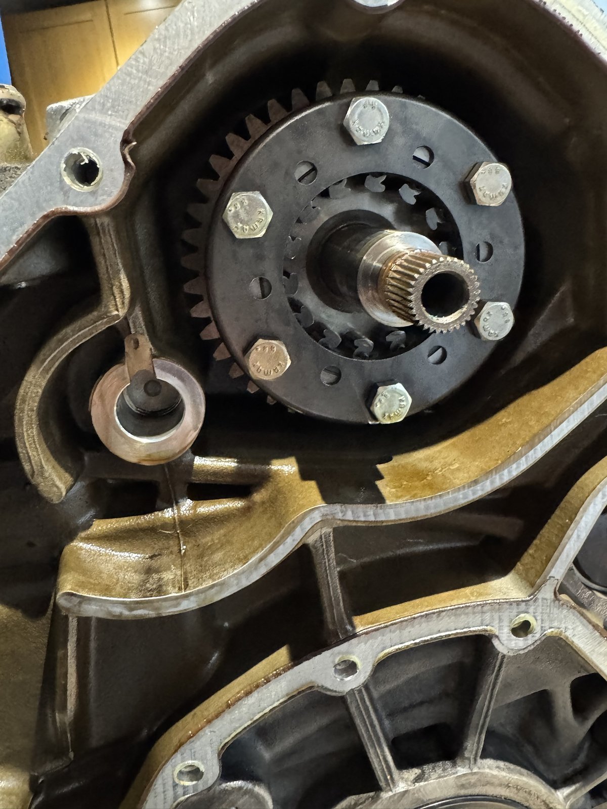

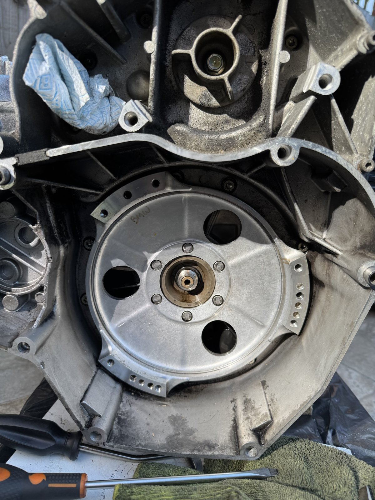

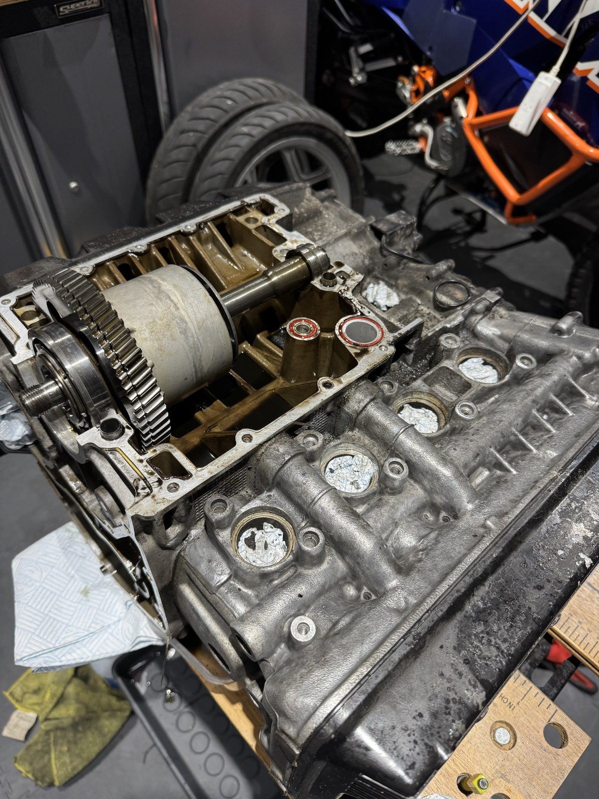

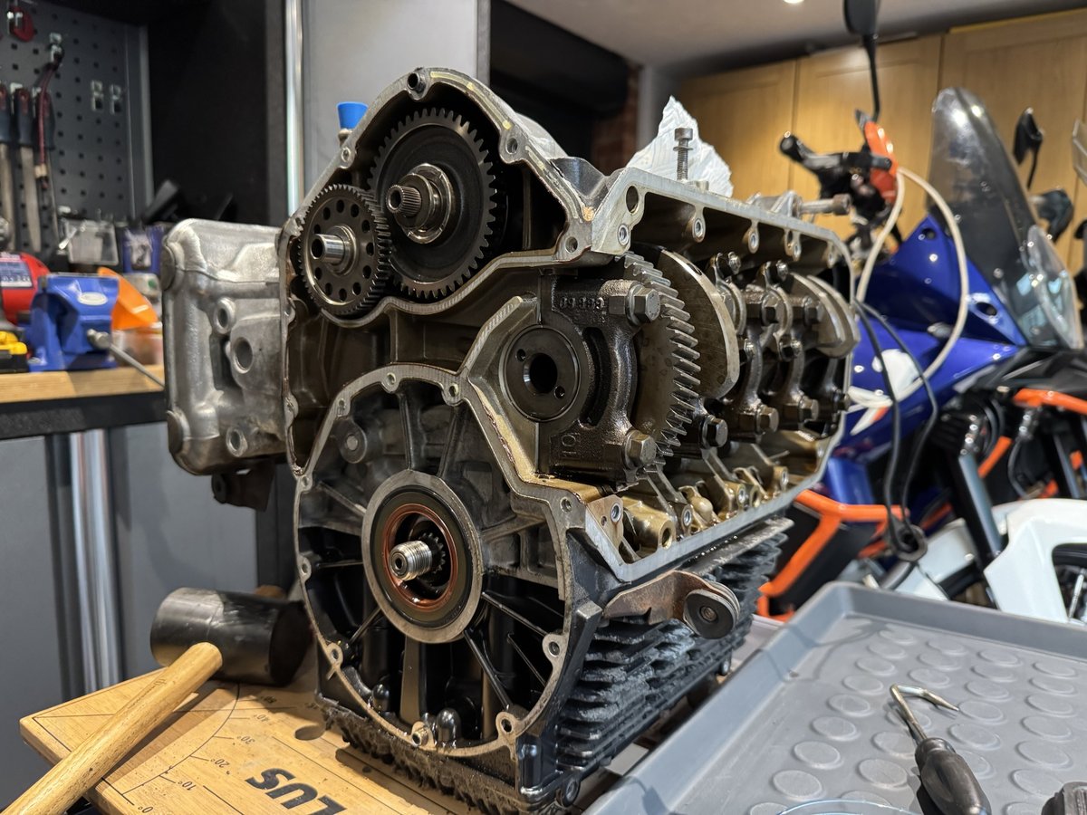

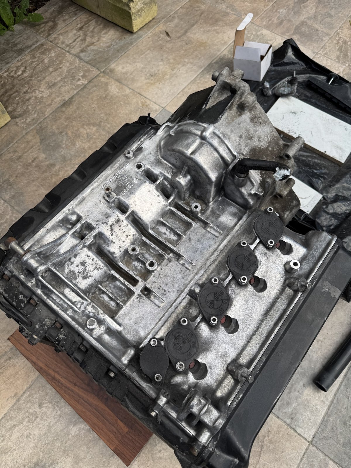

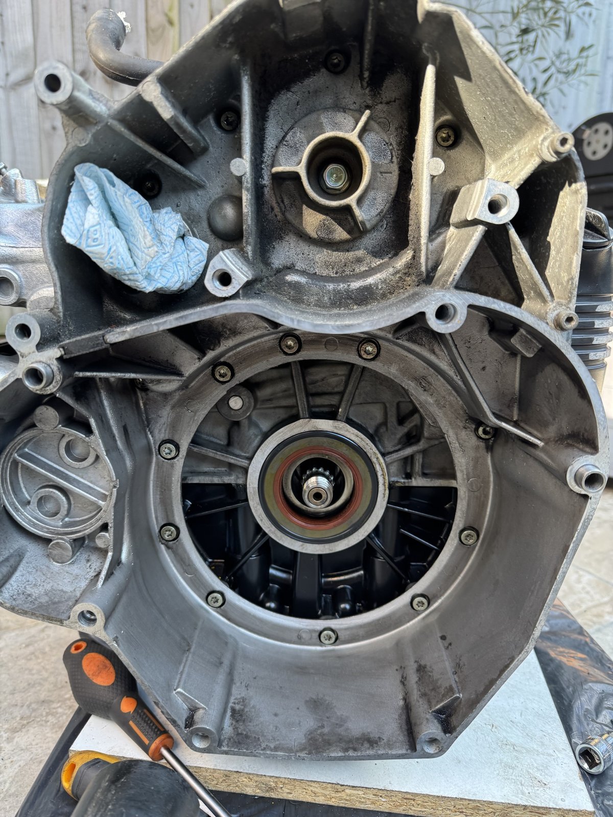

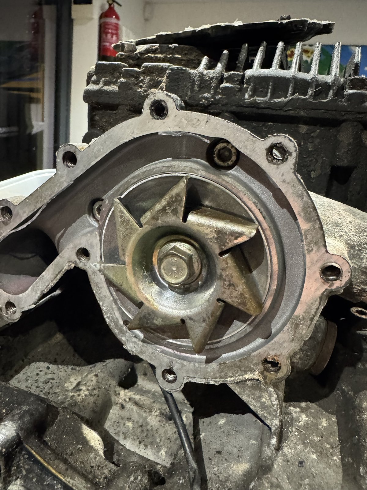

Well we're into the nuts and bolts of the thing - literally :)
I'm trying to clean up the motor a little in order to paint soon - as once the cases are split I don't want to have dust go into the motor
The rear main seal is definitely leaking (this was cleaned up a little)
Sprag looks good

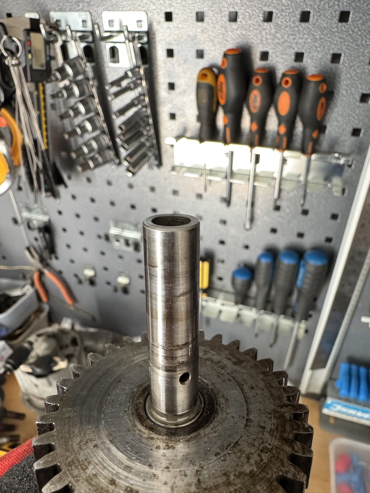

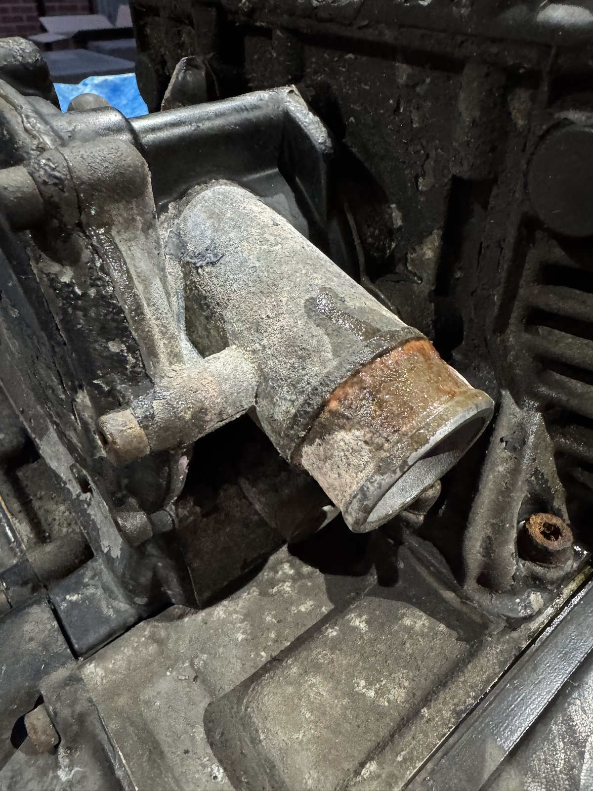

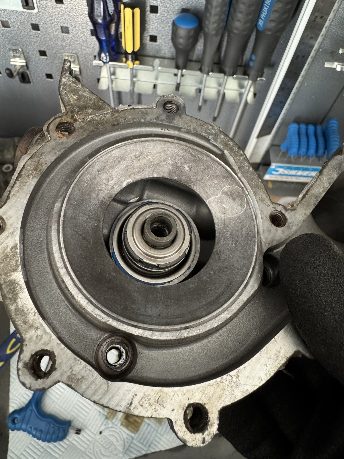

Opening the waterpump - I was just hoping the shaft was okay. Well, turns out everything was okay - but in order to prepare and paint it I need to strip it anyways. It was a real pain getting the cover off / break the seal.
Shaft is fine - the marks are superficial.

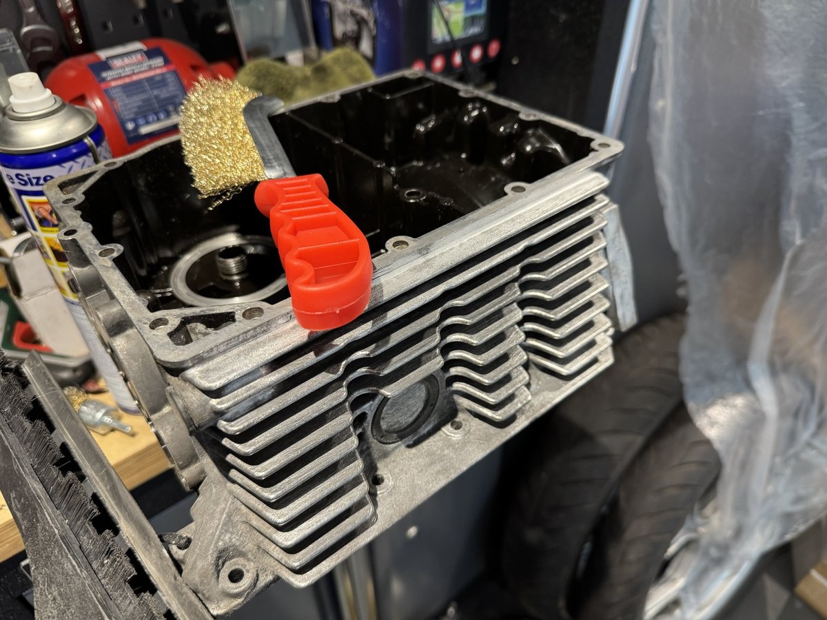

What exactly are you using to get results like that? I feel like an idiot, after hours and hours of work prepping for paint this is the state mine is in, any tips at all? Especially getting down in all those crevices.

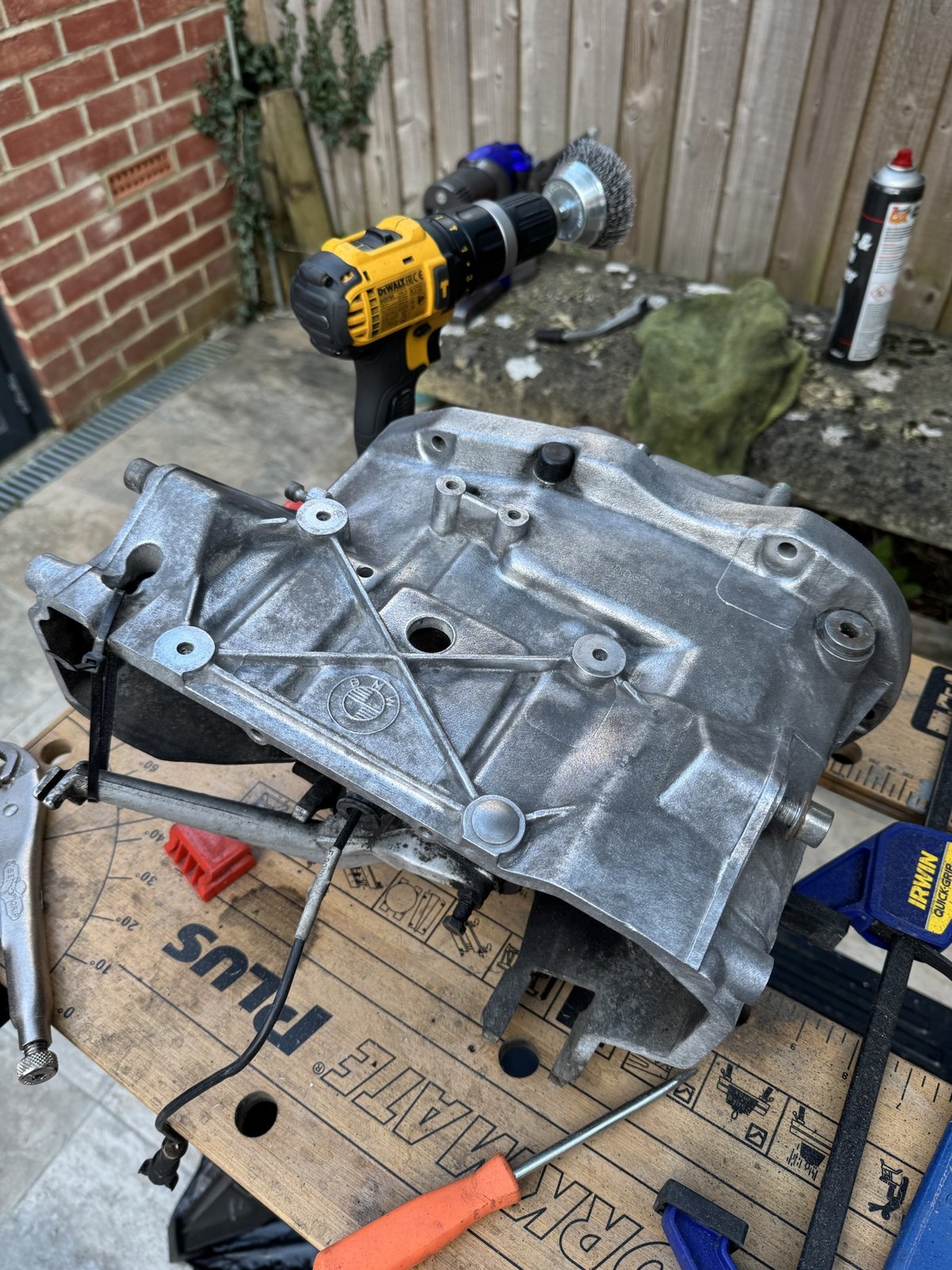

Wire brushes on drills - several types and sizes. (see one in this photo)
To get into the tighter spots I have a selection of wire brushes for my dremel too. Its a fine balance between not just spreading oil around - early on it works just to go mad with the wire brush. Brass apparently is even better - but as I'm painting soon I dont really mind a bit.
I think i need to just bite the bullet then and get a proper dremel instead of the cheap tiny plastic crap one from halfords, do you know the brand of yours or where you got the little brushes from?

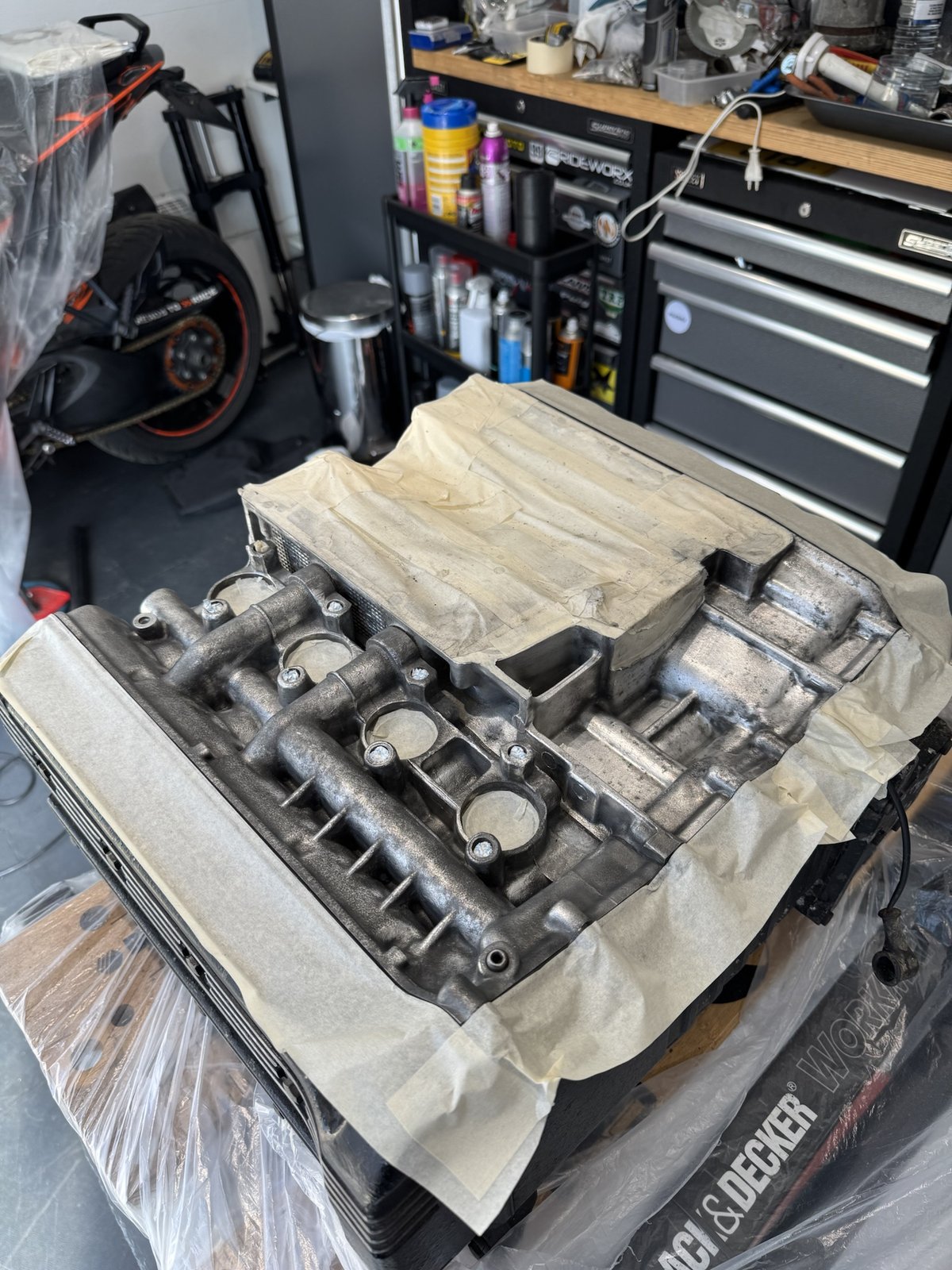

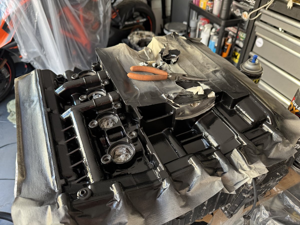

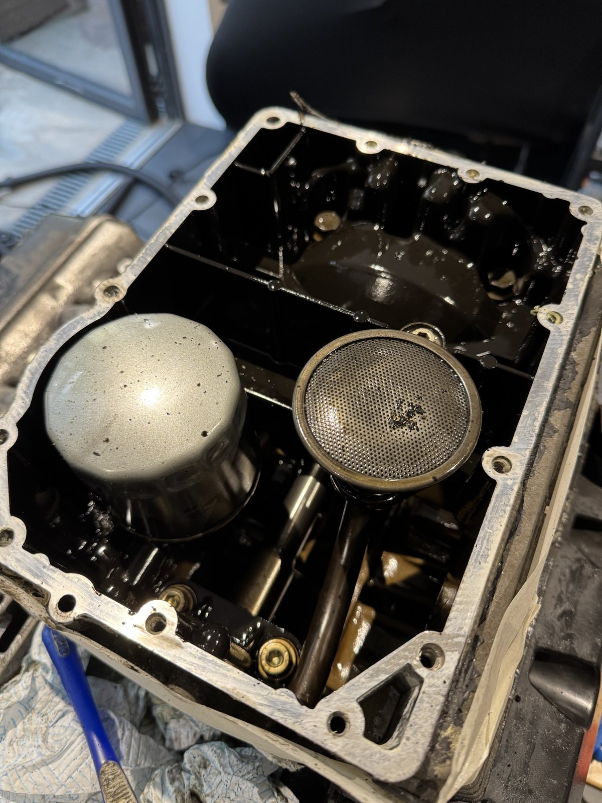

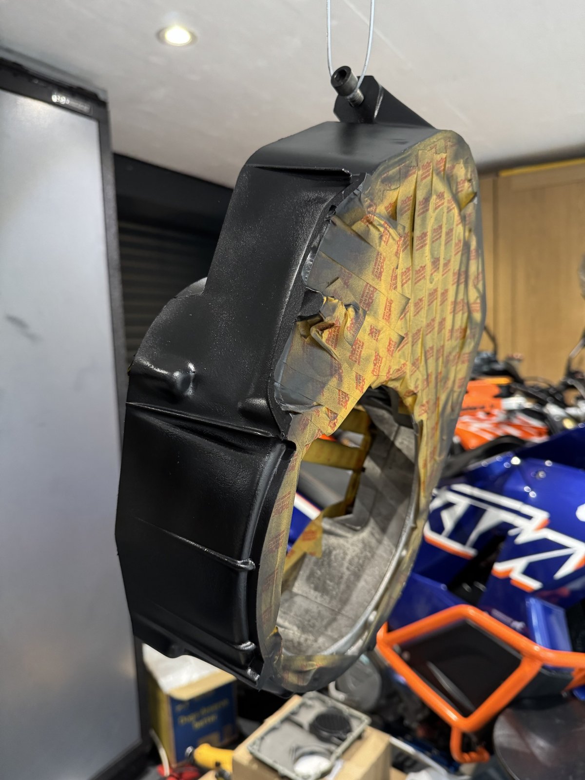

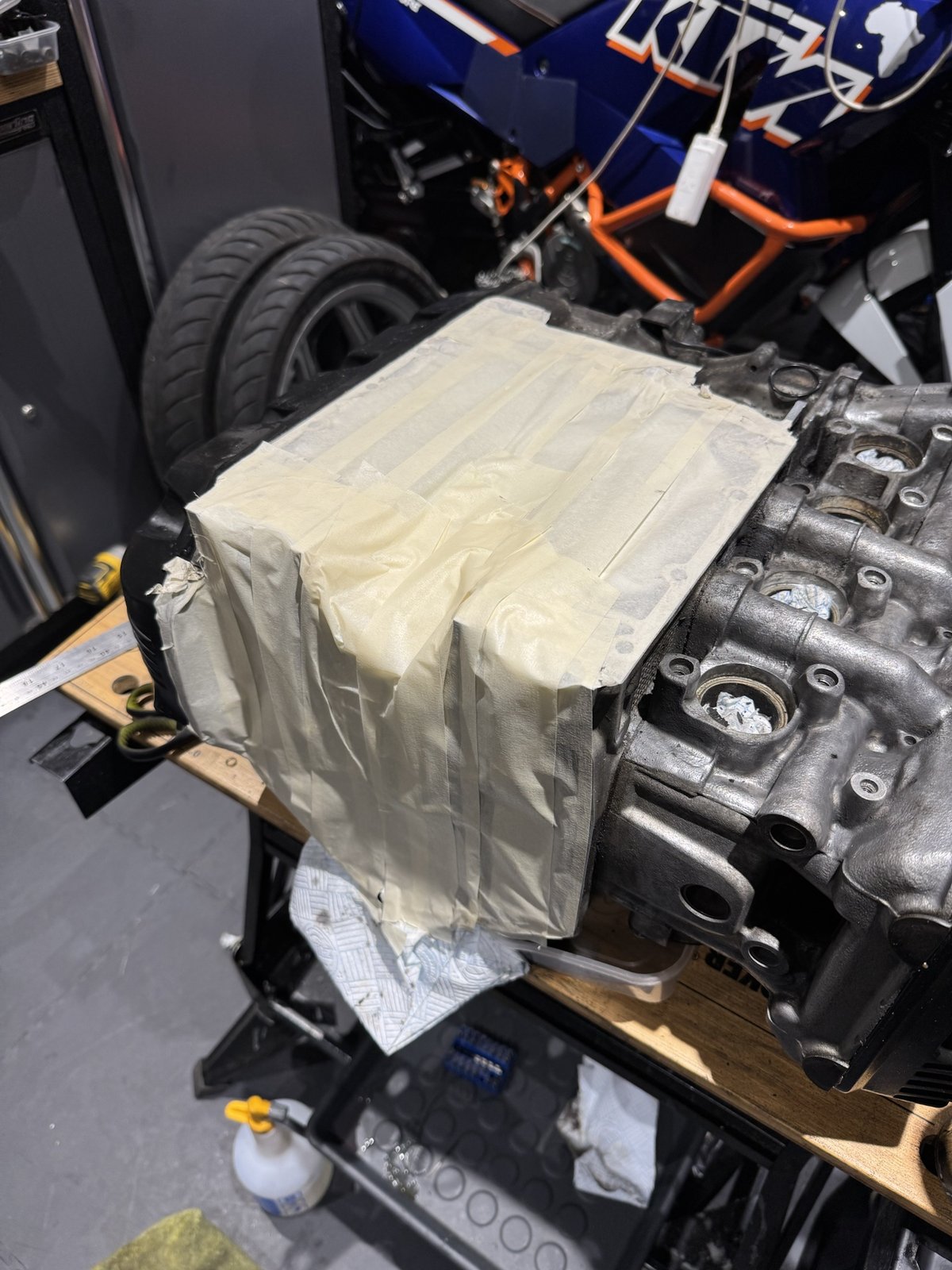

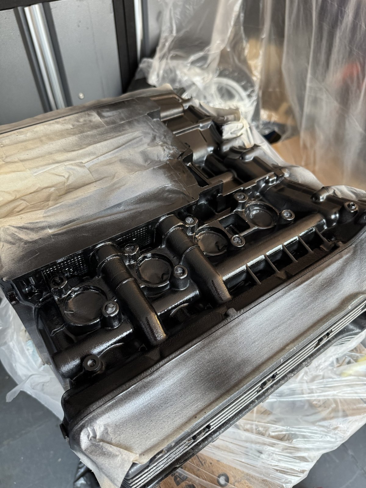

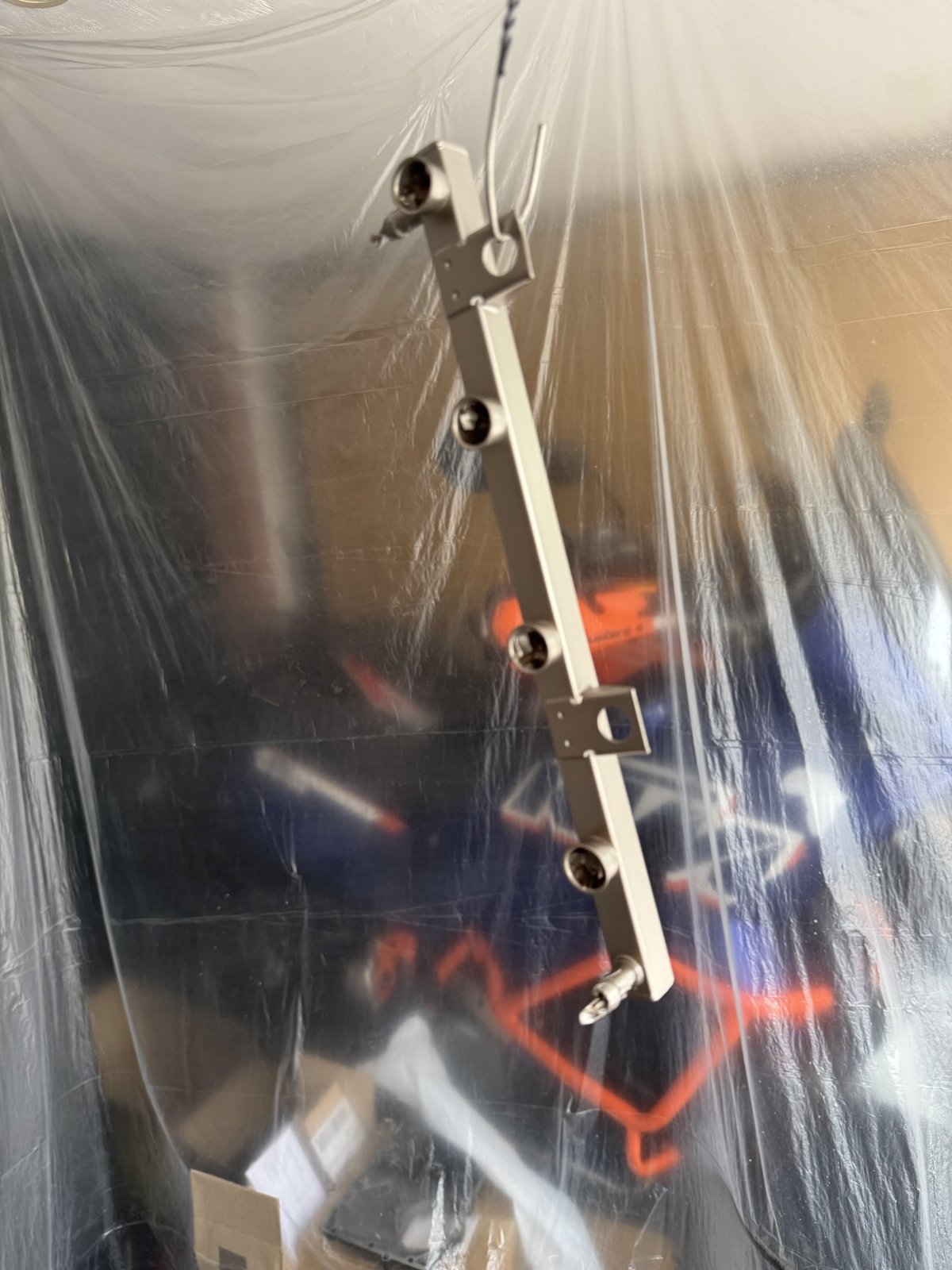

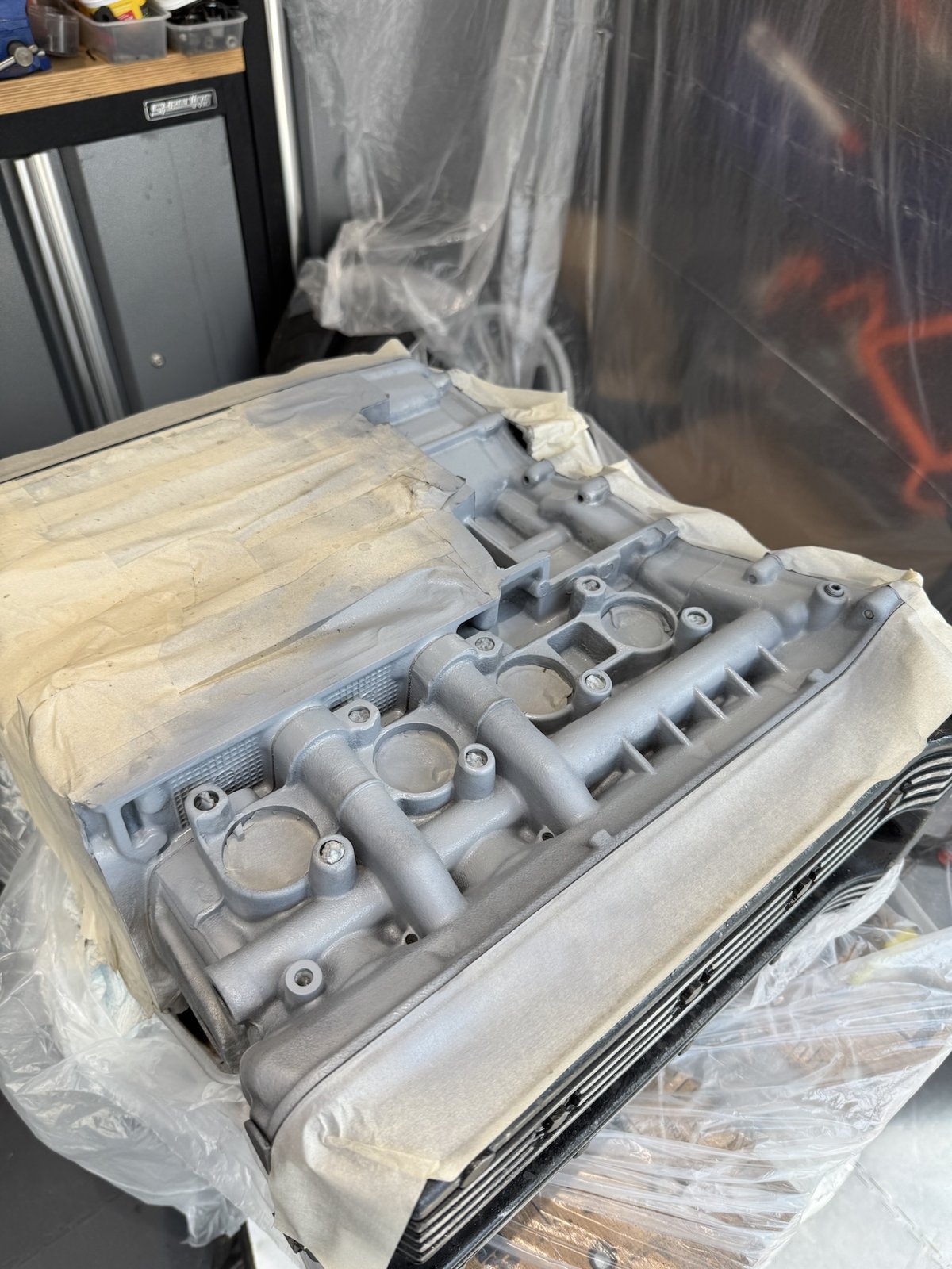

The bottom of the motor is the worst paint/corrosion wise. I also dont have much space and I'm too anal about making an oily mess that I'm doing the motor in 3 parts.
My plan is to do the 3 covers last - as they can be done easily independently. So lets start with the bottom - I've ordered all the bits needed for the rebuild (seals, bearings etc), flipped the motor and torn it down. The counter shaft 2 bolts and 2 hex bolts we incredibly tight - I was extremely worried about stripping/breaking them - but they eventually came. I'd feel better about replacing them - but see they dont seem readily available. Anyways, I'm over thinking things I'm sure.
The normal oil pickup silicon.
Masked it all off
Went to town with cleaning it - including dremel etc
Now on to paint - this is experimenting a little - I've gone with VHT - SP148 primer, SP124 Gloss Black, and SP145 Gloss clear lacquer.
A fair bit of learning here - the hardest was the recesses and corners. This is where it looked the best, but in corners and hard to reach places it was a bit light.
Overall - I'm happy with it
The only issue is I dont know what I'm going to do to "cure" it. Its supposed to sit in an oven at 200 degrees for 20 minutes - well, this wont fit. So I may try a heat gun for a bit, but its going to be another month plus before I can run the motor to cure it.
Just thought I'd report back that I did try some brass dremel brushes as well though they don't seem to work nearly as well as the steel, all I managed to do was transfer a brassy gold finish to the still oxidised block.

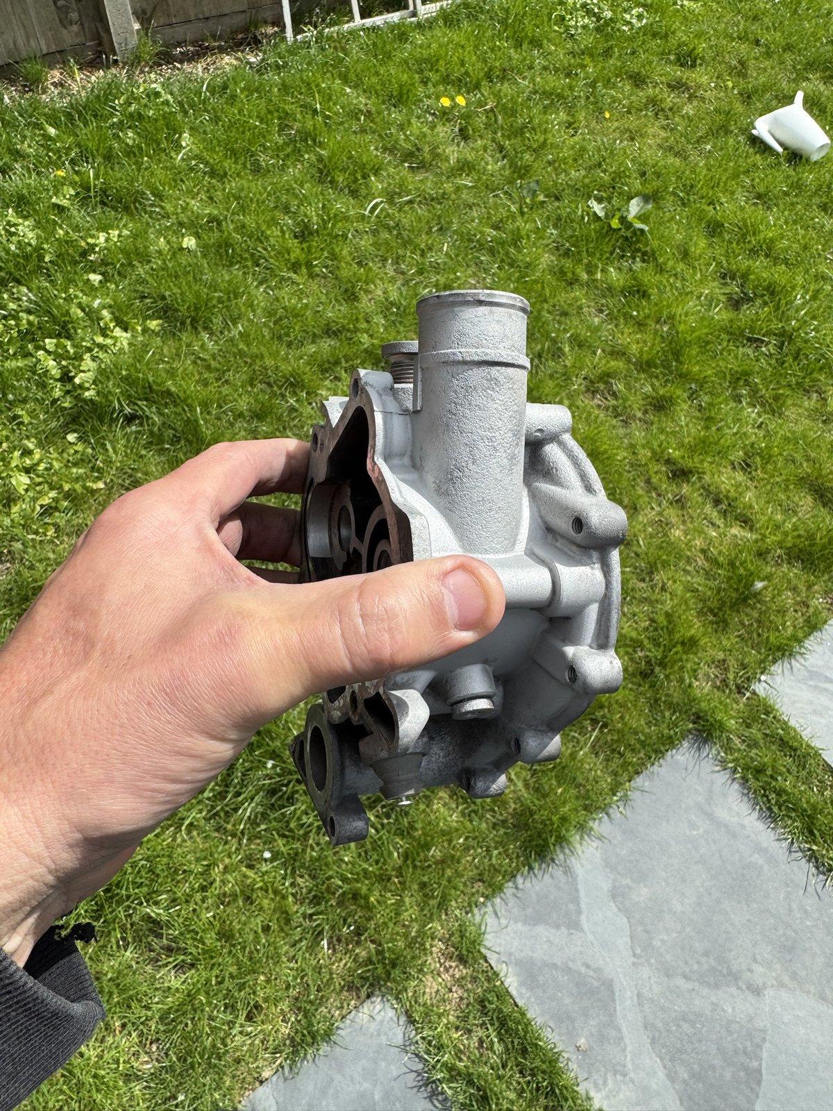

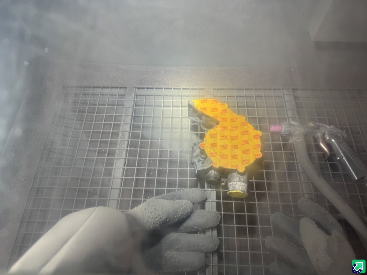

I think you need to get a selection of things.
This is hands down the best and fastest set of brushes I've got https://www.screwfix.com/p/norton-straight-shank-preparation-brush-set-3-pieces/380jf
But they do not get into corners and gaps very well. The brass set is actually smaller and helps. And then the dremel just to clean up the bits that they cant get to.

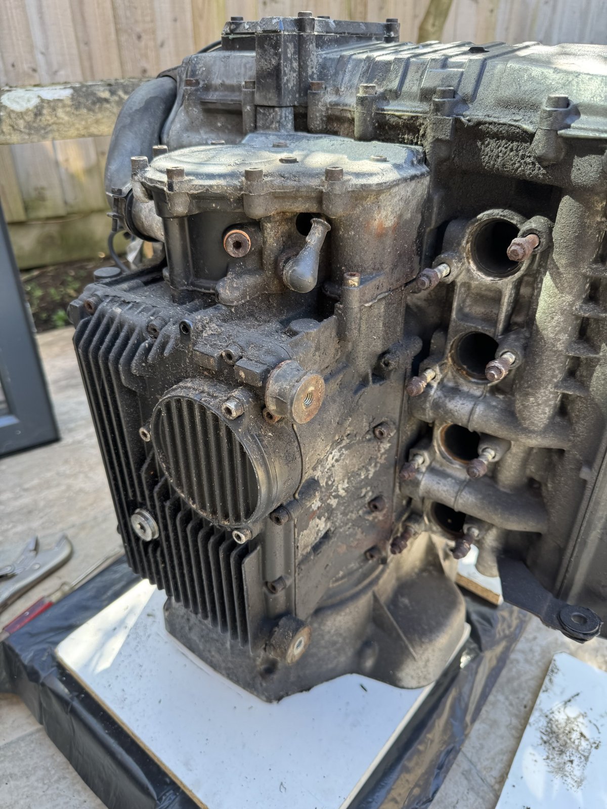

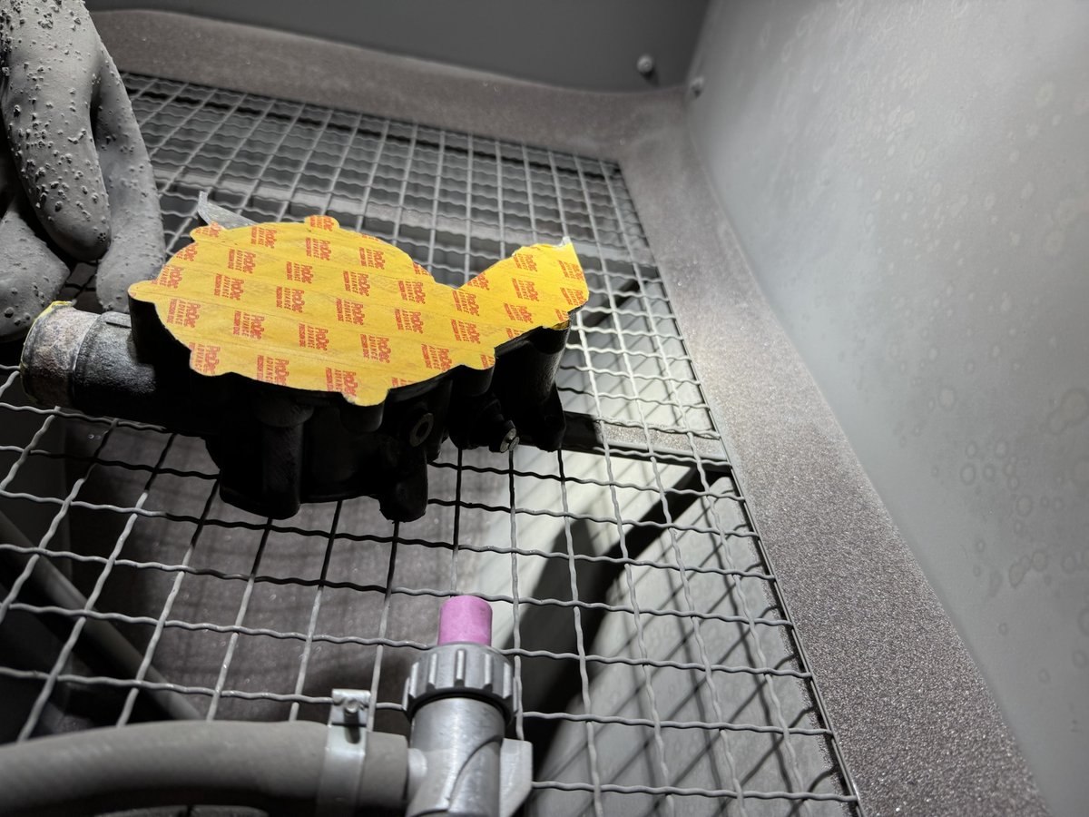

But I've now found something all these were struggling with - the fins on the sump - because its deep. I went and got some of these https://www.screwfix.com/p/forge-steel-wire-brush-set-2-pieces/132xg and its helping get into the grooves.
And then stuff that fits goes into my mate's sandblaster. This is more effort than I ever thought it would be.  boohoo
But its paying off.

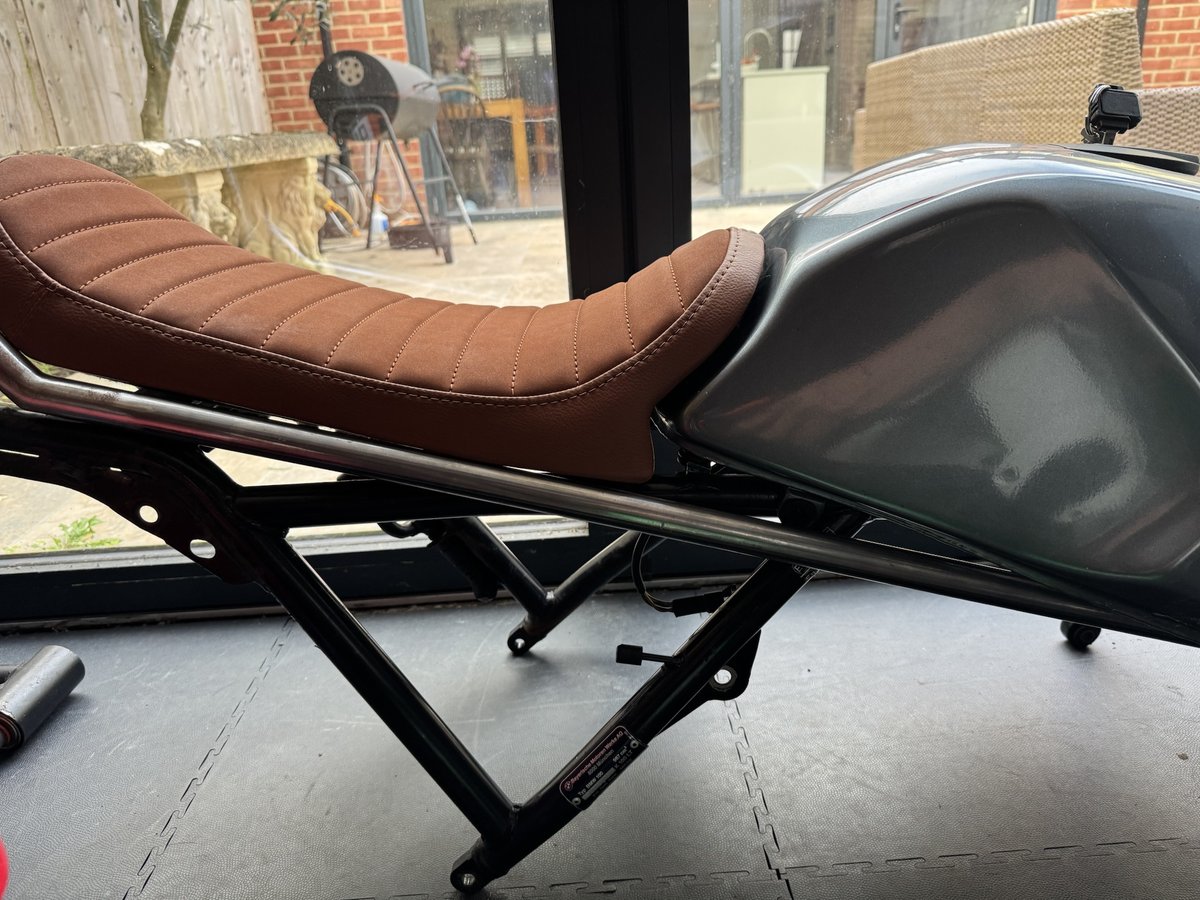

On a side note - my custom stuff arrived!   103123
Its a bit of a cheat - but I think it sorts the weird frame hump at the rear I'm not a fan of.

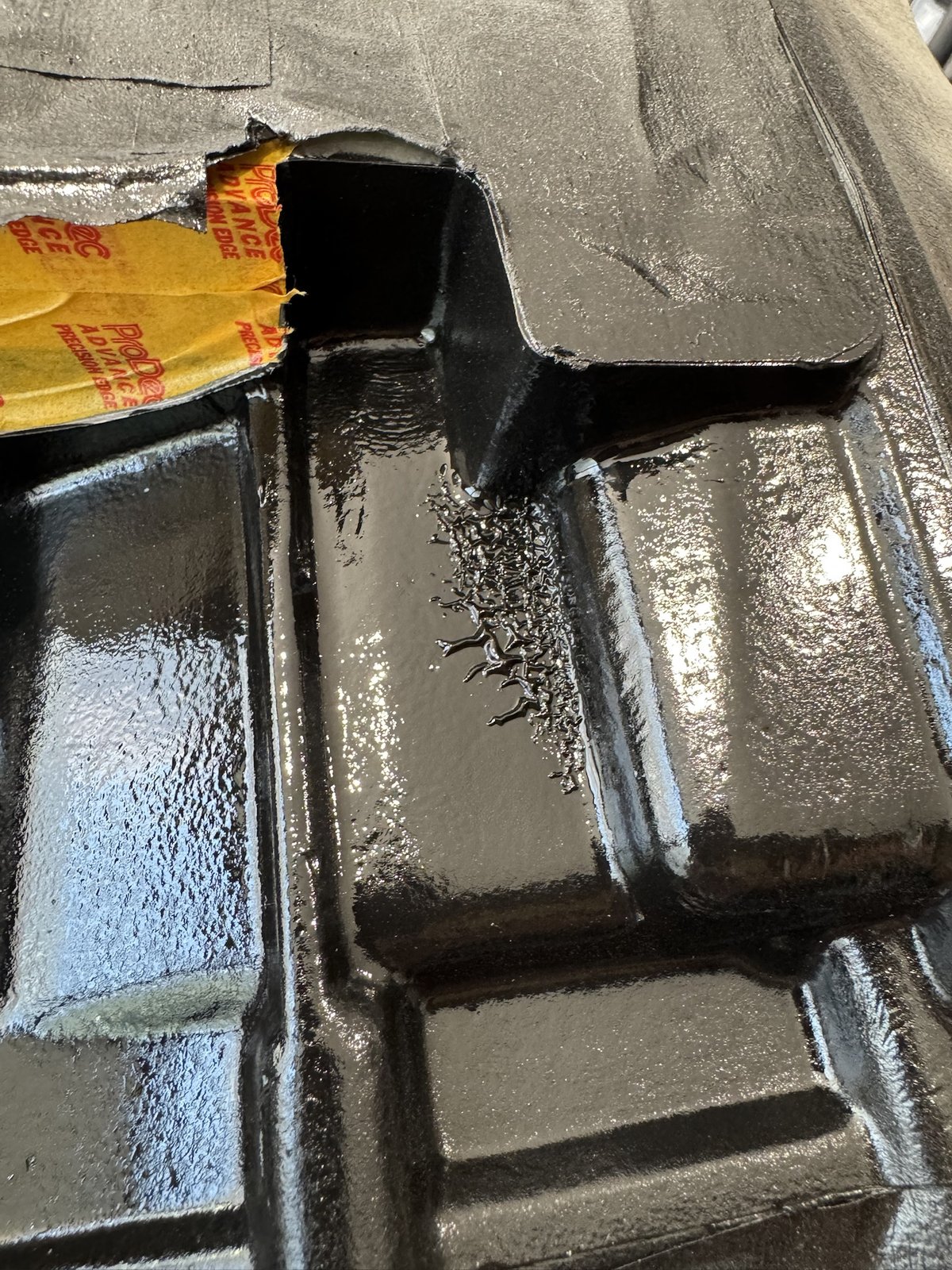

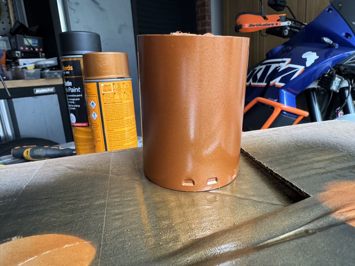

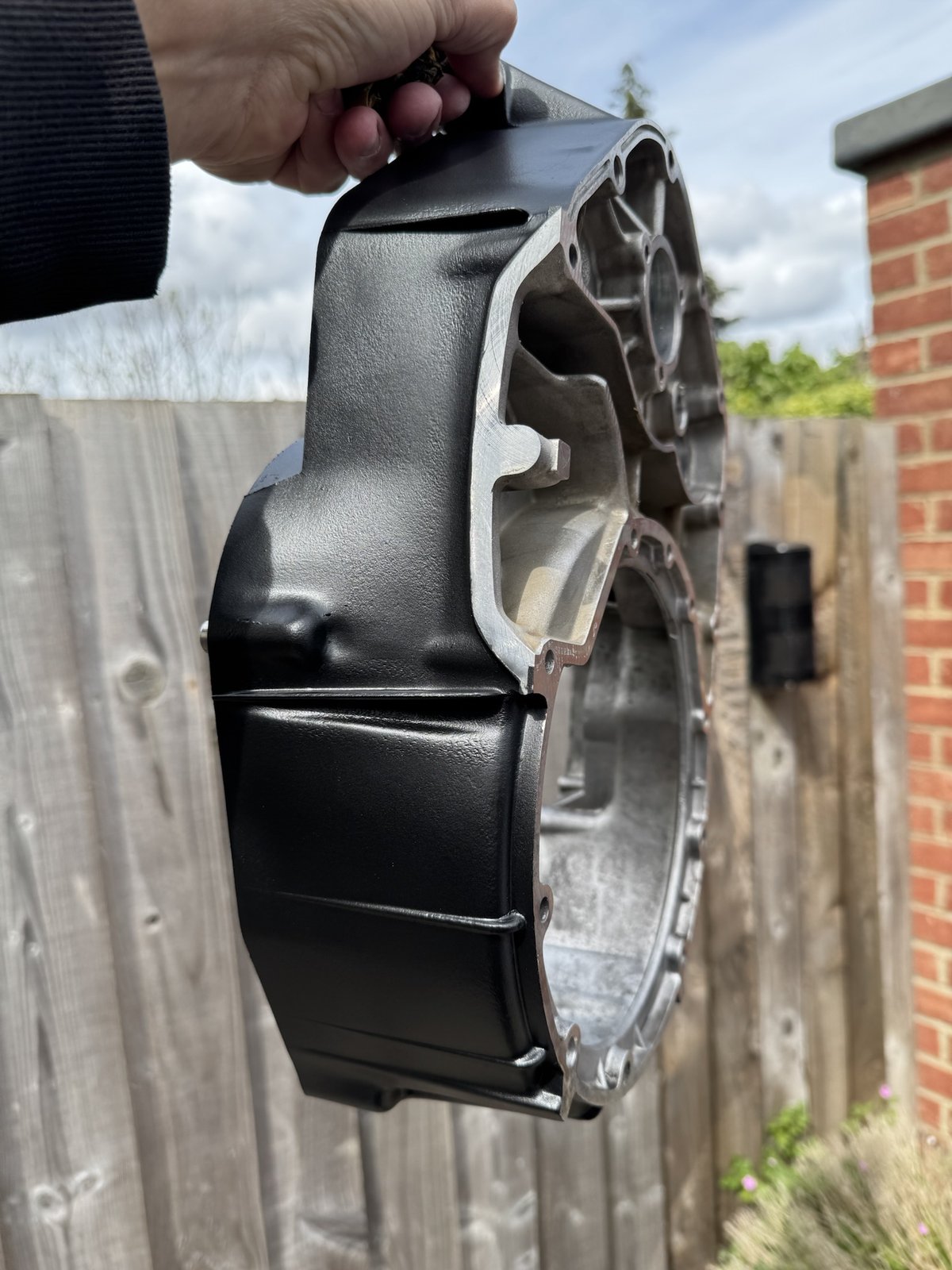

Well price turned to absolute heartbreak. The VHT can recommended SP145 GLOSS CLEAR ENGINE ENAMEL - so I got some - and applied it a week after the original engine enamel was applied.
I didn't think I coated too thickly on the first 1/2 quotes, but I suddenly noticed this.
 :johnny
I scratched it and it flaked off afterwards.  (╯°□°)╯( ┻━┻
There are other small spots that this happened - but well hidden in groves etc and this is the underside of the motor. So the question is whether my OCD wins and I re-do this all.
In the mean time - I decided to apply the very widely available Simonez to the gearbox housing - sooo much easier and simpler - and I think it looks great! As there is not primer its not as smooth, but I actually like the semi imperfect finish - more of a matt feel too. I think it wont work for the engine covers as you want those to be smooth - but the rest I think its going to look awesome - aaaaand it will be really easy to touch up any scratches/issues as they happen.

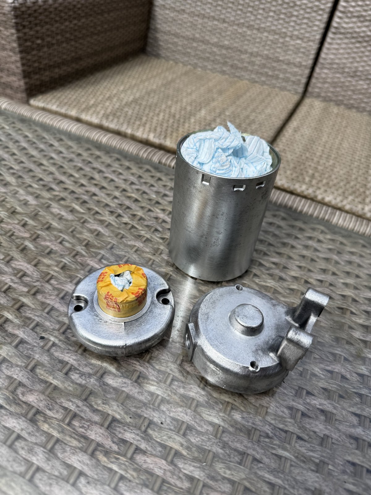

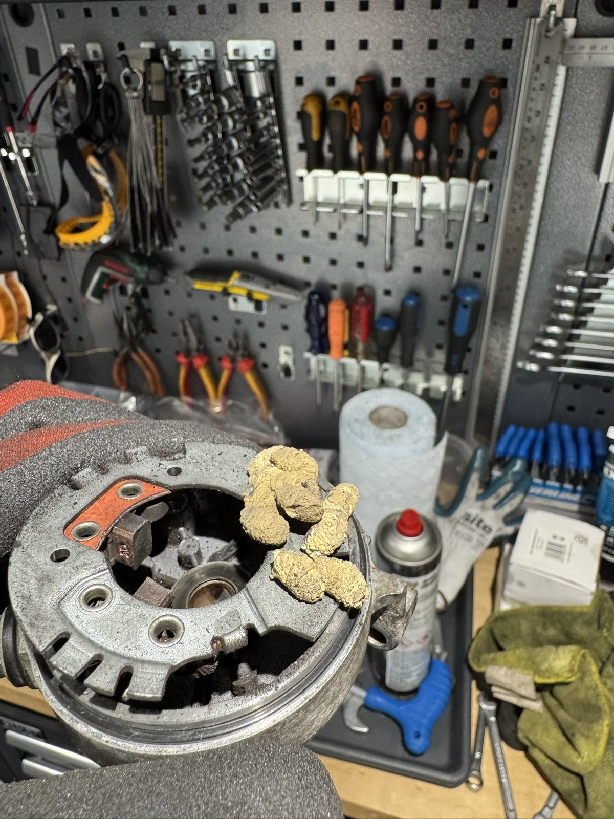

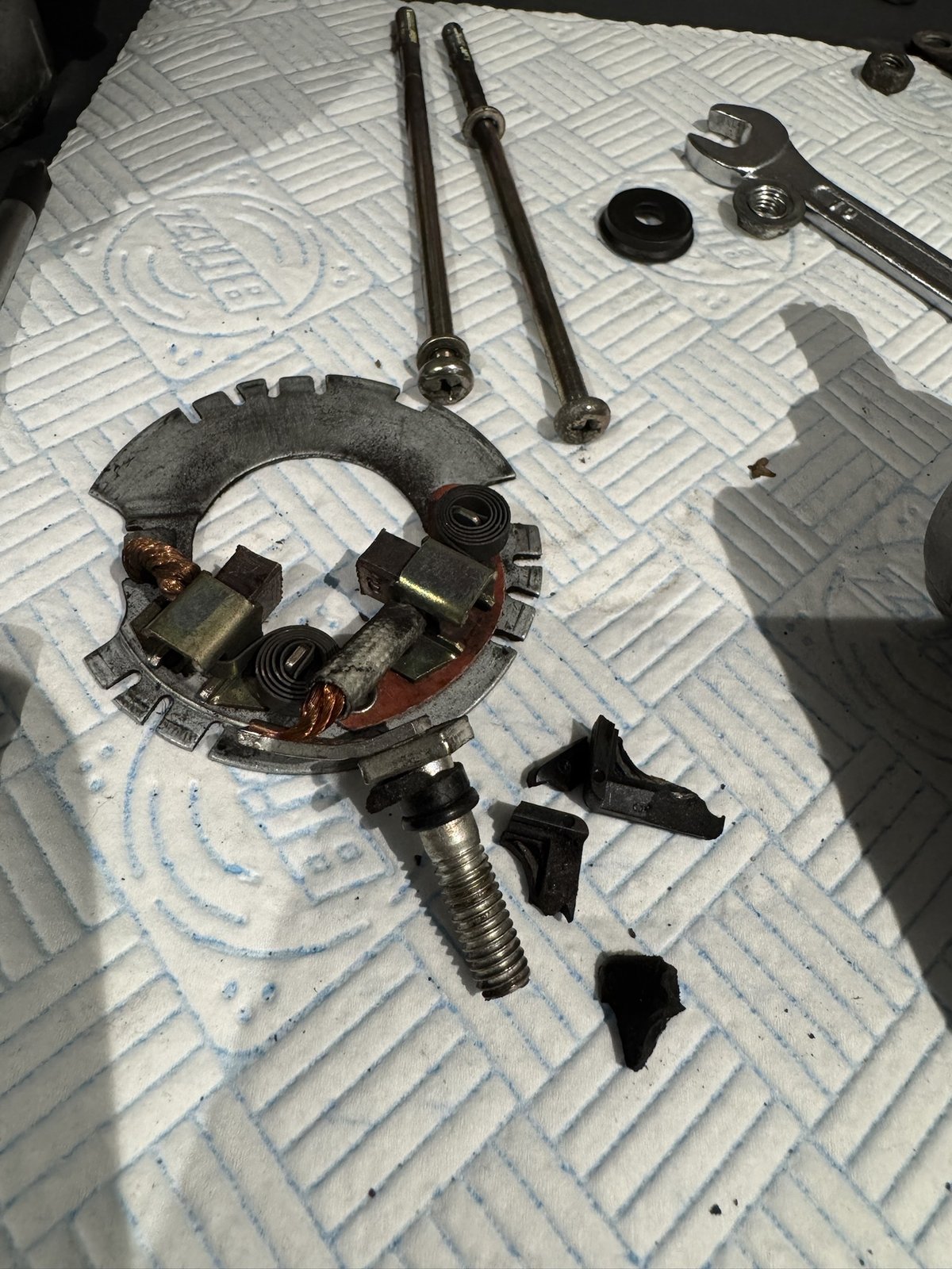

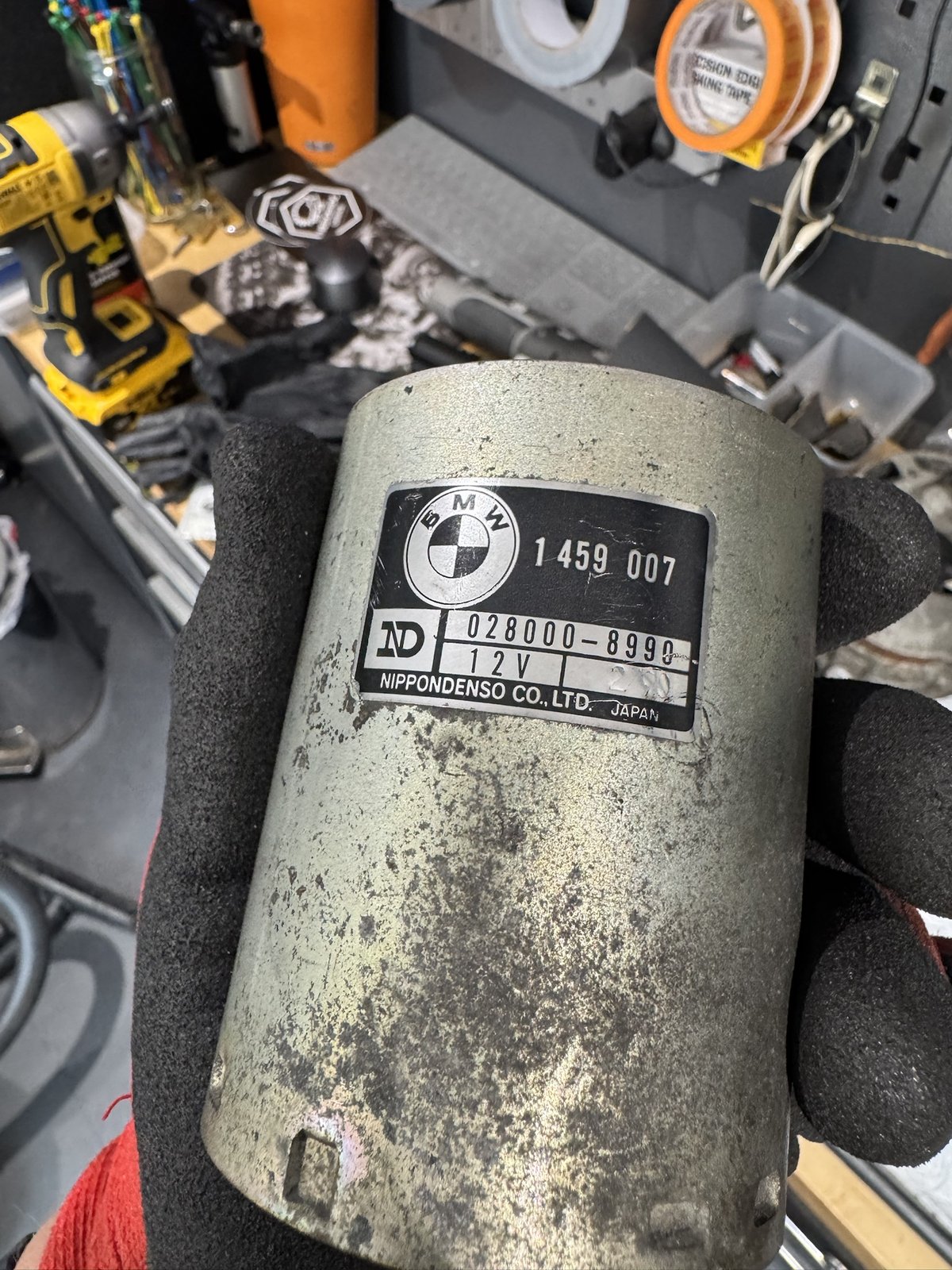

Decided to turn my attention to the starter & alternator. I'm a little scared of the alternator - but as this bikes only got 44k miles it will be more for painting and less for brush replacement.
The Starter - although the positive cable to the starter was to tight when trying to undo it it moved the power post - well, opening it up there were 2 surprises.
The starter is home to some unwanted guests - not sure how as this is nearly a sealed unit.
Here is whats left of the plastic brush guide thingy
Does anyone know if you can buy them separately? Rather a waste to part with £20 for that (comes with a brush)
So cleaned up and ready for paint!

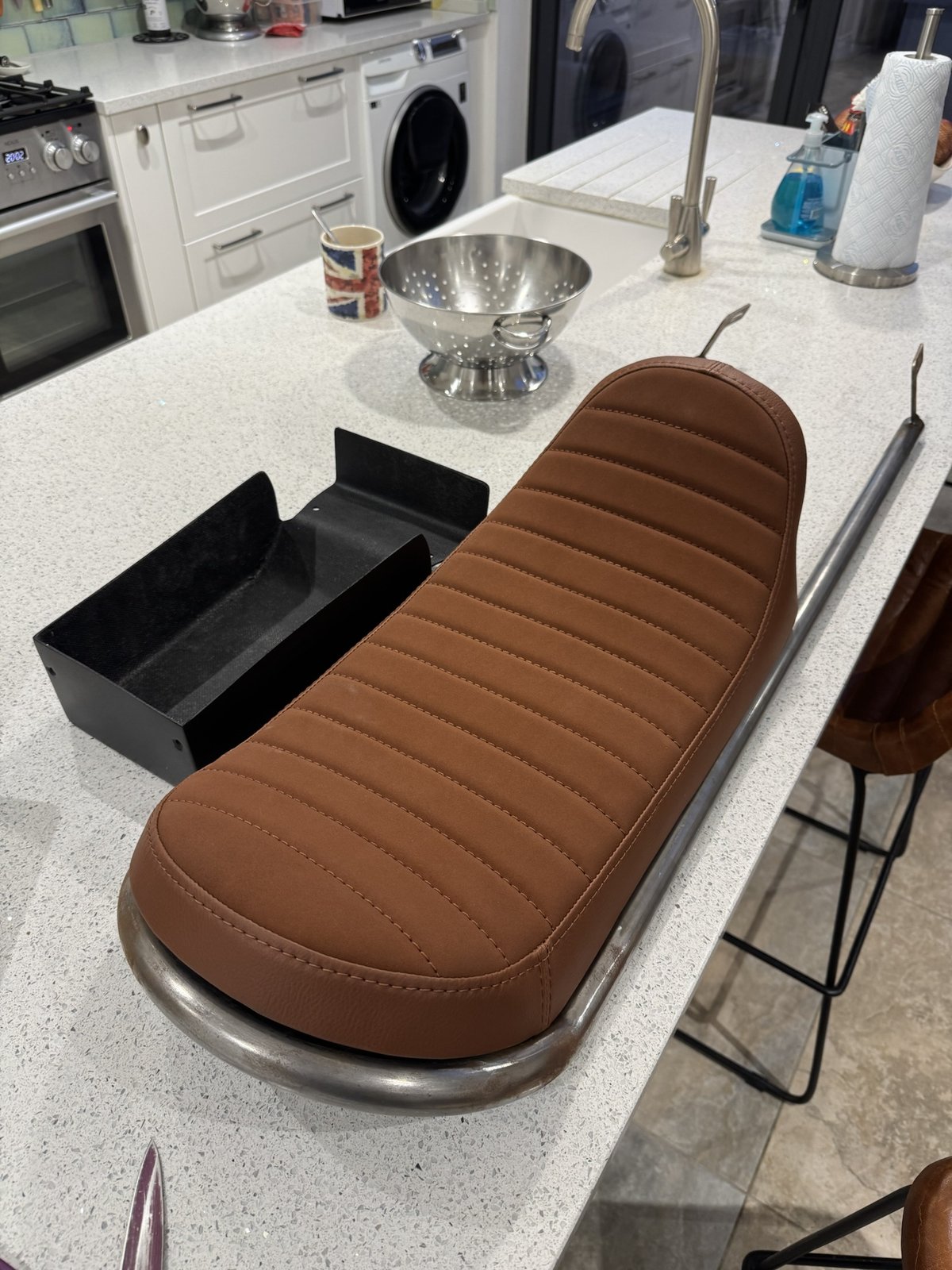

You are about 3 months ahead of me so it's really interesting to see the choices you make and how you overcome the problems.
Do you mind me asking where you got the seat and rear hoop ? They look great - I was toying with whether to try to straighten the line of the top of the frame / tank out as it bugs me.
  • Hampsire UK
  • FTR1200, K100RS 83, MT09
1983 K100RS  Vin 0001126
Offline RustyK
  • Posts: 63
Re: Rusty's K100 Scrambler (lets try that again)
« Reply #42 on: April 15, 2025, 03:14:09 PM »
It's from Riot in Spain - https://riotmotor.com/seat-bmw-k-series-model-6-for-subframe-loop-long/
Really nice quality - although they are not very responsive on communication so you just need to wait a LOT. Also, import to the UK was just crazy money so I had it shipped to mate in the EU. Thanks Brexit!
Those brushes look absolutely ideal for the fins, definitely picking some of those up after work.

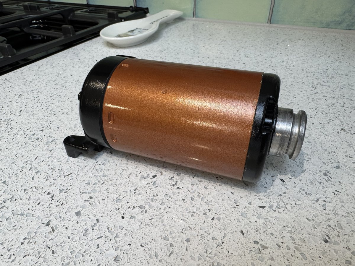

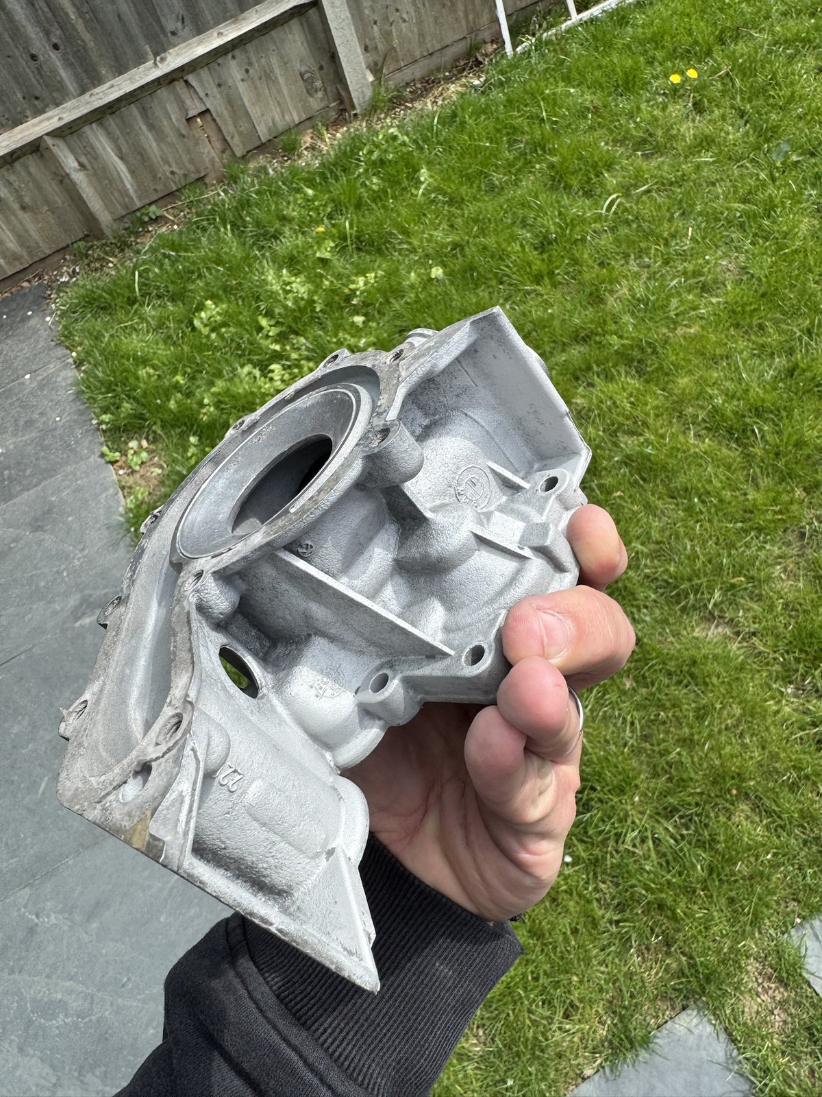

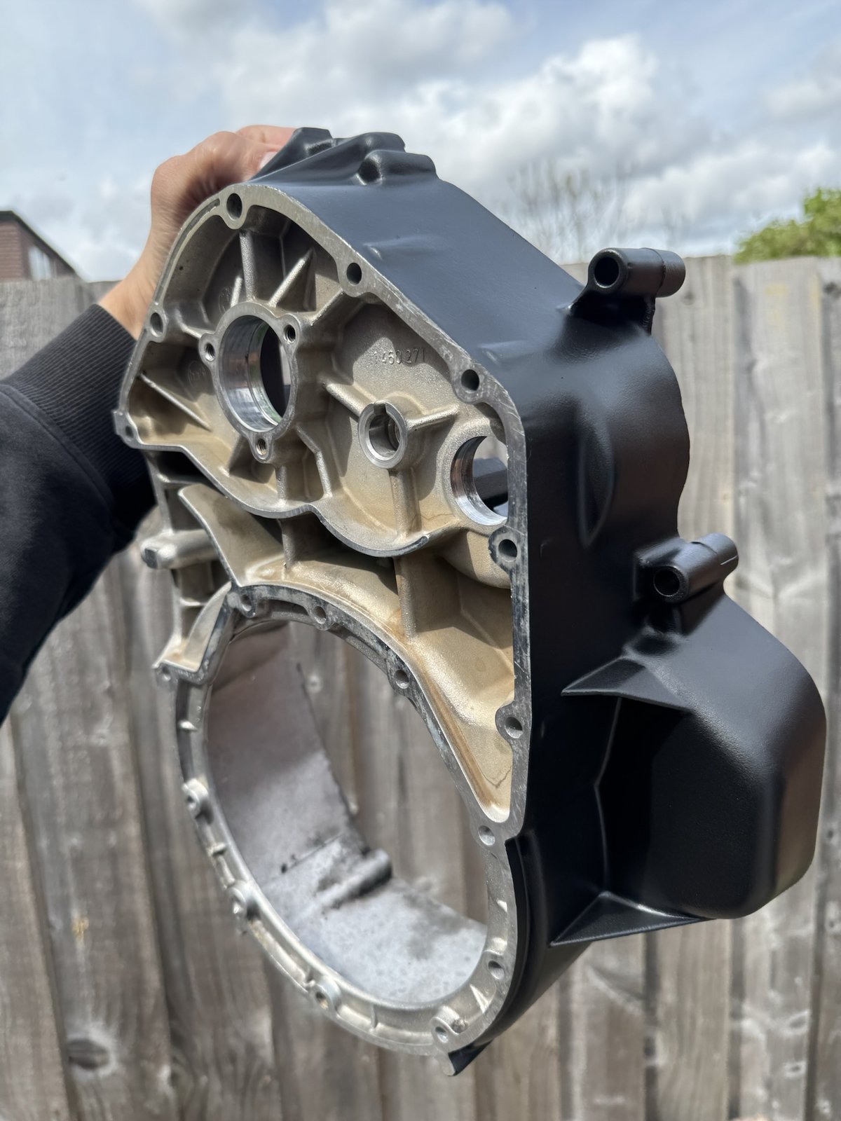

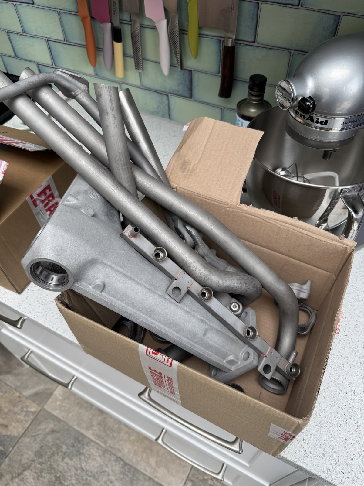

Spent some more time making brand new 35 year old parts! Popped over to my mate with the sand blasting cabinate.
Cleans up well - but its fairly pitted.
He's done the heavy lifting on these parts - they look like new!

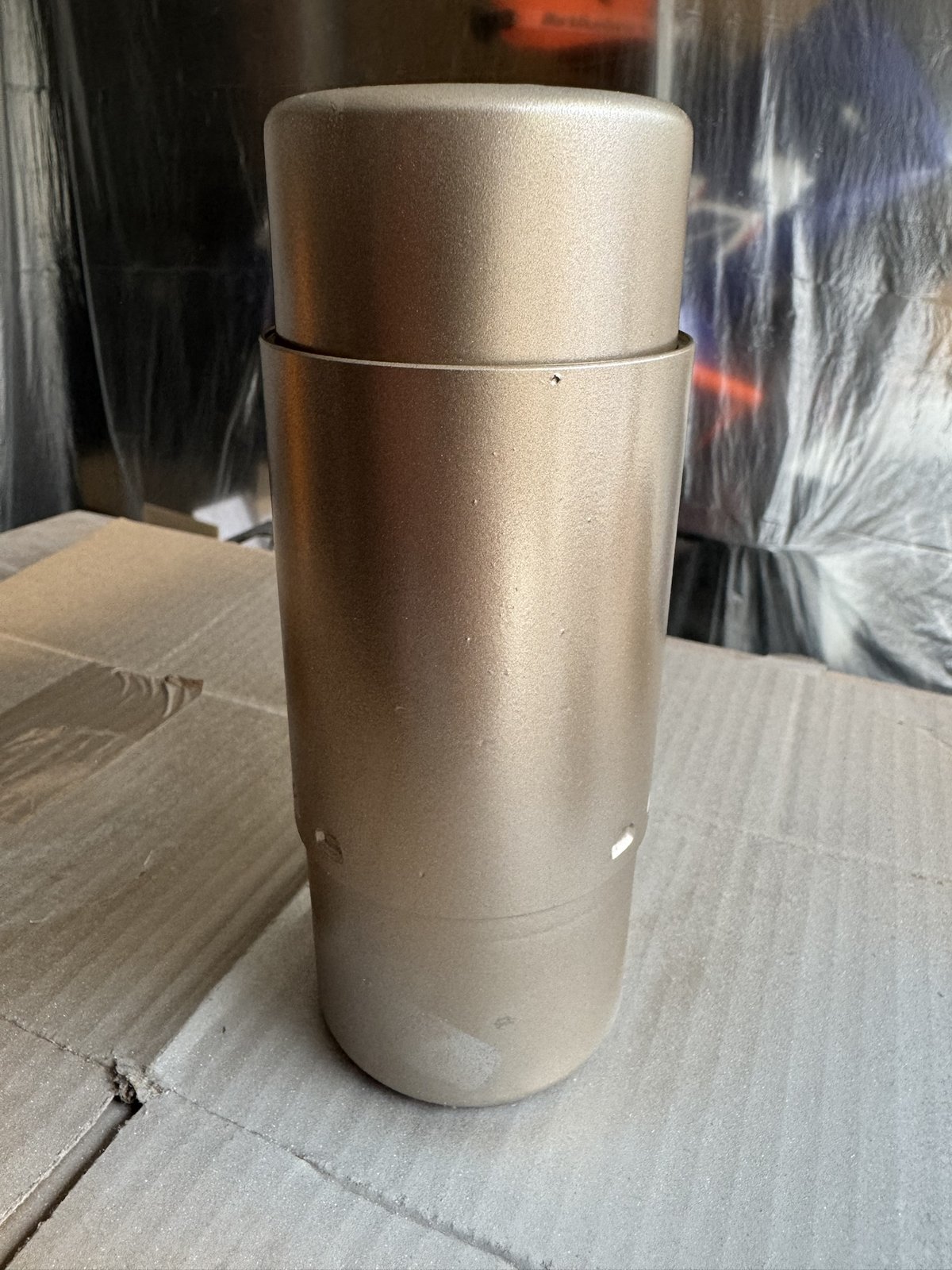

My first view of my colour ideas was .... not what I expected. :(
Got the missus' input and the new color looks a lot better

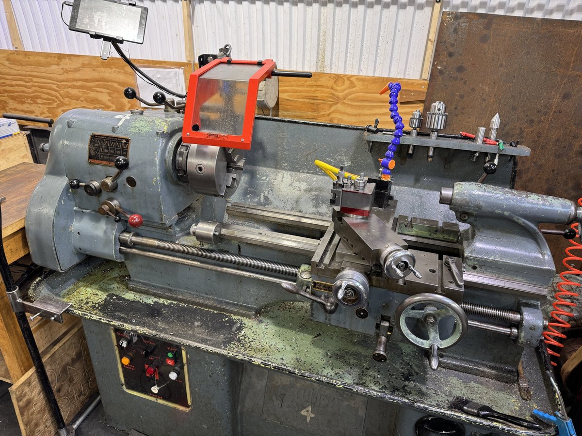

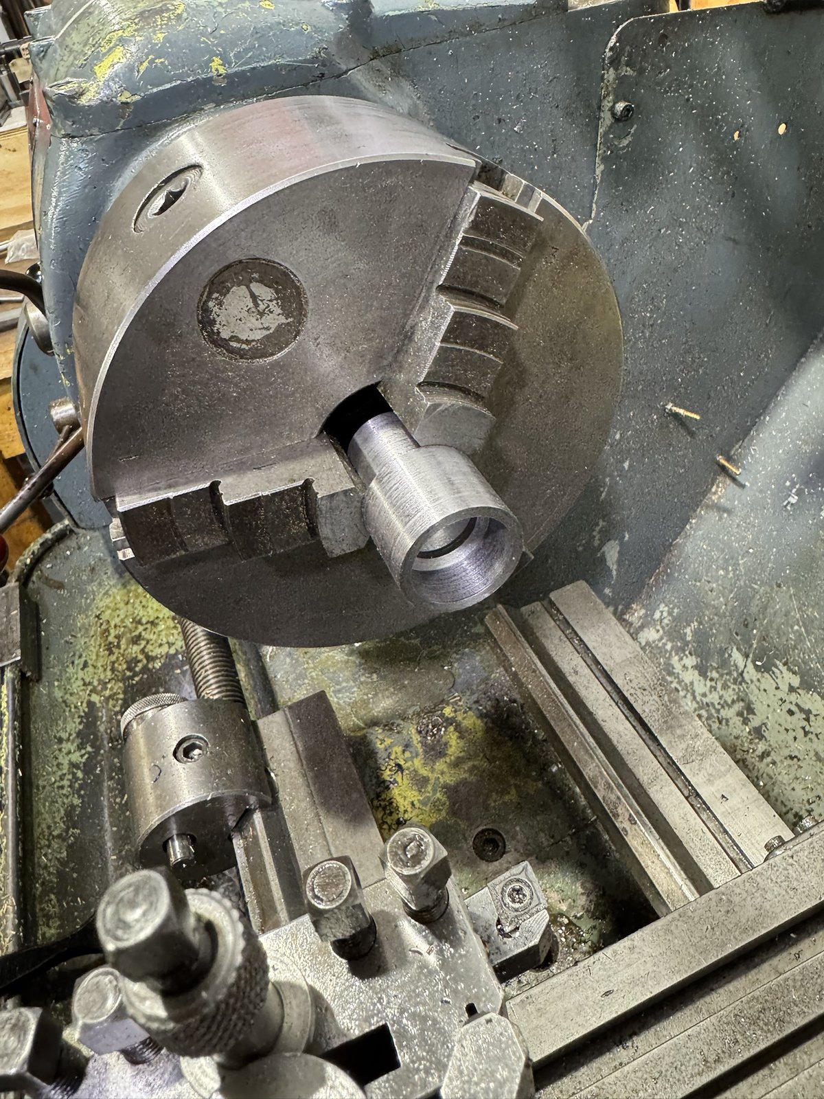

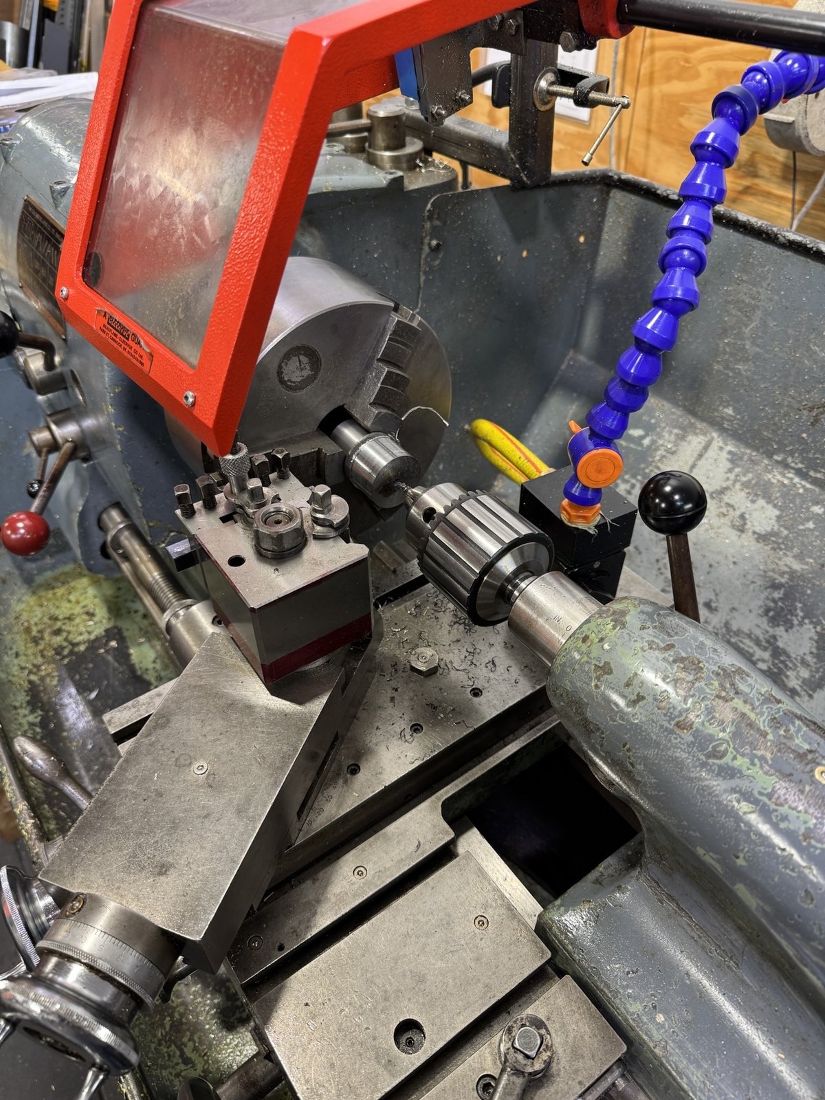

I also did a lathe induction at our local community workshop - and the first thing I did as my solo project was the waterpump seal driver.
I'm now aware this will only work to drive the seal in - I didnt have the depth/height to make it work with the actual shaft - I'll have to use the bolt and washer method (unless someone can actually meassure that up for me :) )
I actually really like that deep copper colour
« Reply #48 on: April 22, 2025, 10:46:22 AM »
I think the camera is kind to it. I think that would have been fine in small doses, but I want the wheels to match and I dont think it would match the gold shock tubes either.
  • London
  • K100, 1290 SDGT, 990 ADV, RC8
« Reply #49 on: April 23, 2025, 02:44:45 PM »
I love a copper look on a bike. But it wont match gold.
But nowadays everything is fluid, so you could write on it that it identifies as gold or has a golden personality.
I love your work man.
Also Ive been cleaning out the garage, and found a hall sensor with new oem bolts and stuff, a 32t waterpump refurbishing set -new- And some other stuff you mentioned. Shoot me a dm if interested.
