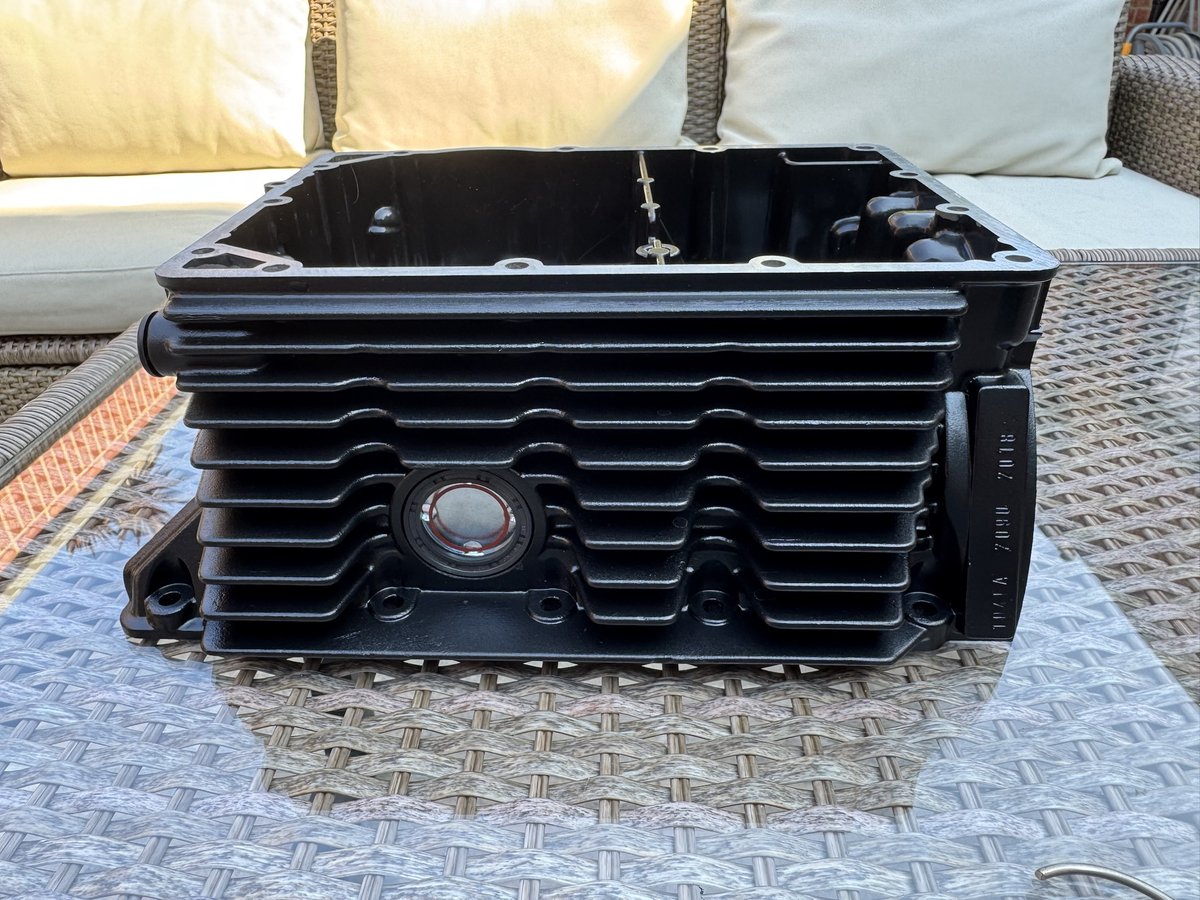

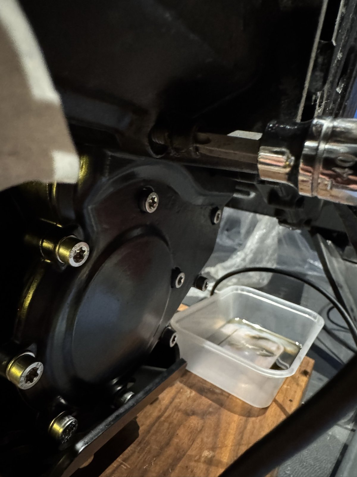

This painting prep phase is doing my head in. This is just taking so long.
So I decided to take a break and go for a ride. Great time to hit the Ardennes just ahead of Victory day.

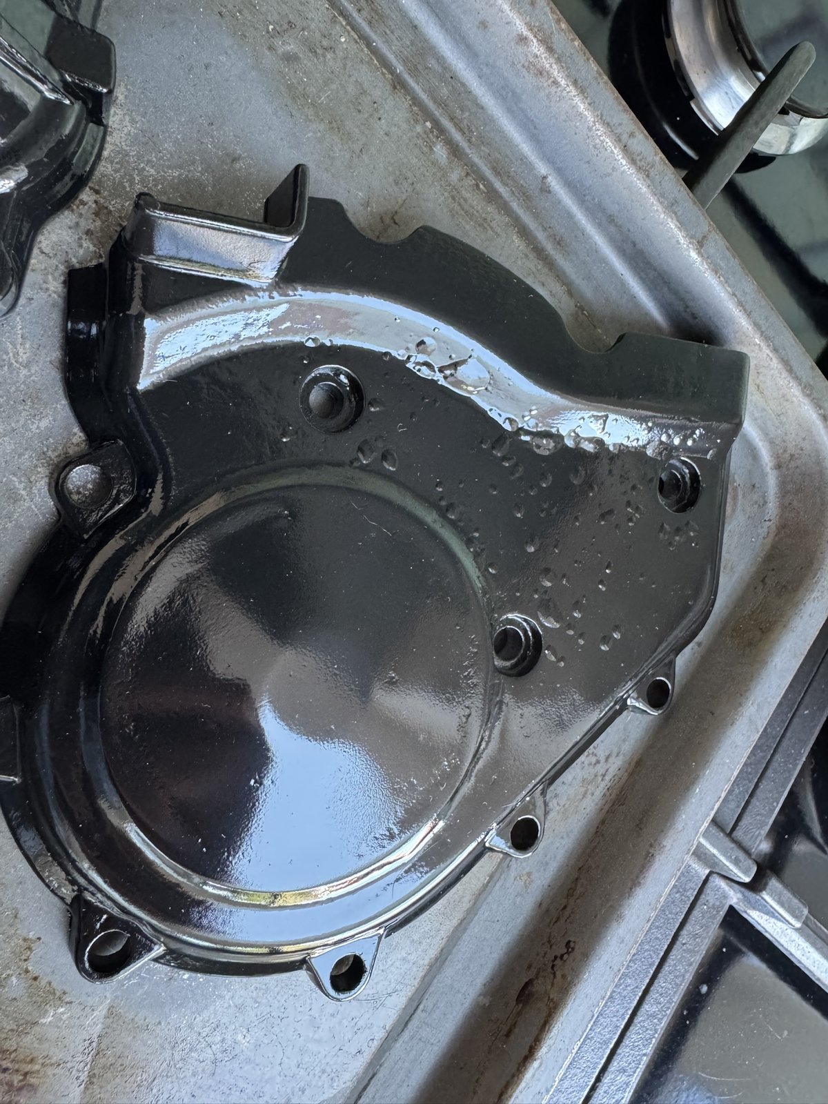

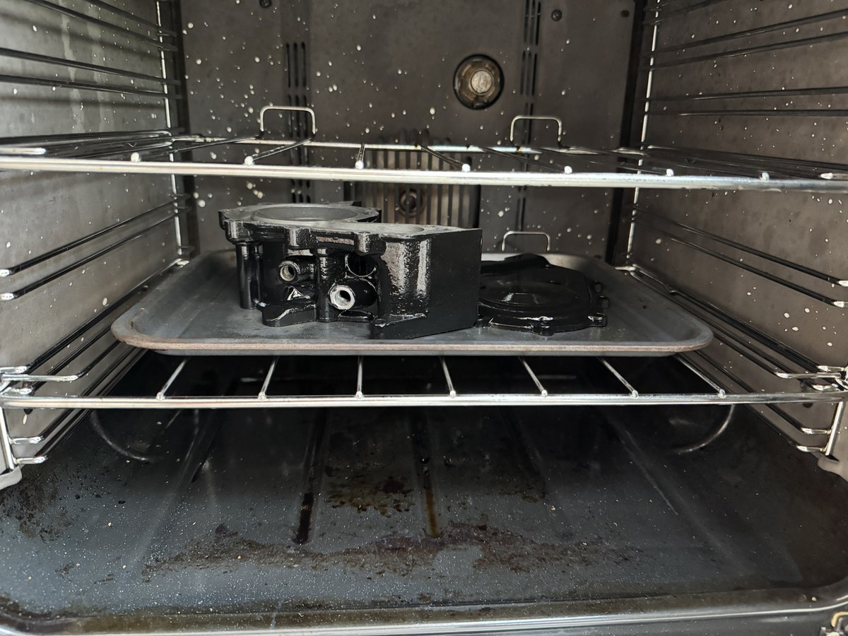

Anyways, back to reality and the paint should have cured by now. So into the oven it went.
However the filler on the pump cover seemed to not like the heat.
And now its back to blasting that again and re-painting. I think the Simonez paint wins, this enamel with a primer is just balls.  :nono2:
Look at how nice this came out. Complete with new sight glass.

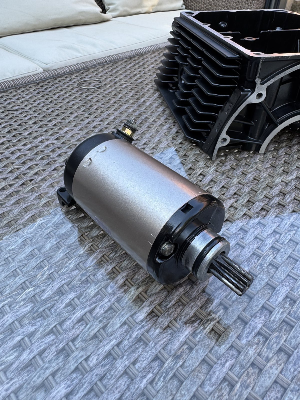

Also rebuilt the starter motor with the new replacement part. Is it safe to put in a vice and "test" by connecting a battery?  :idunno:

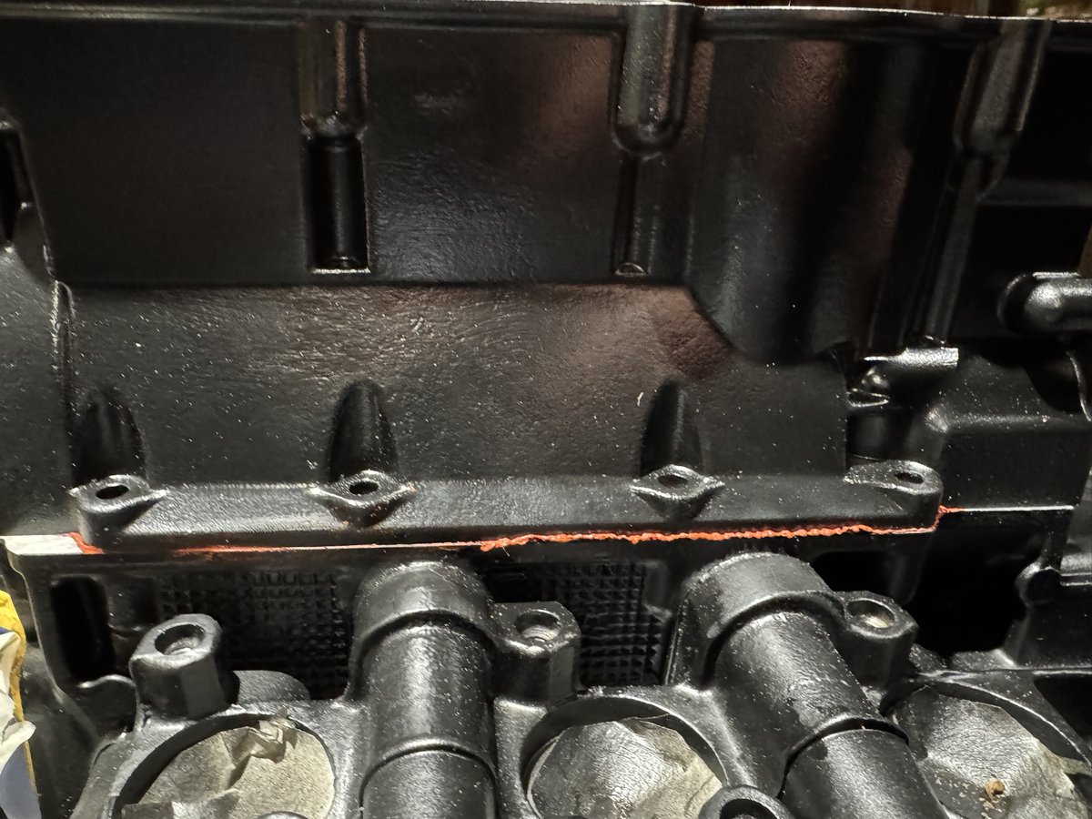

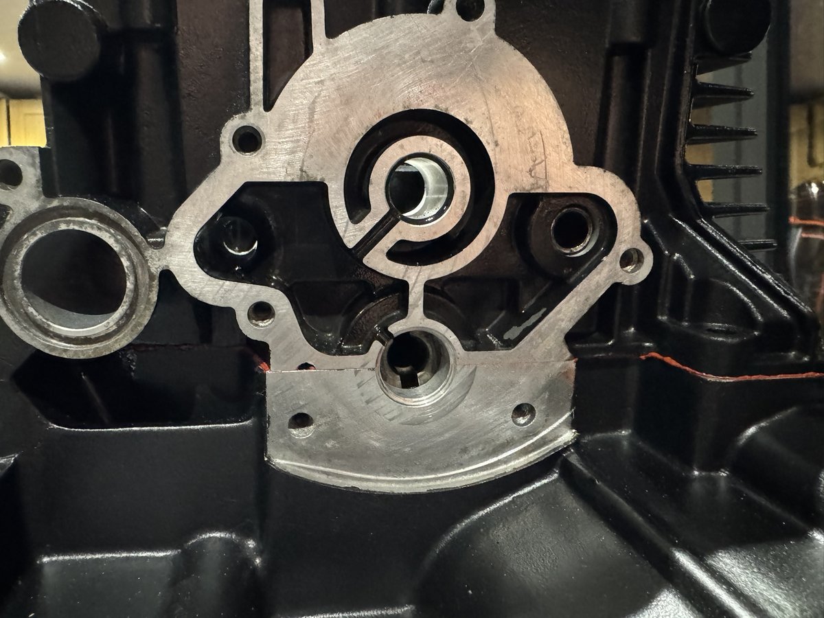

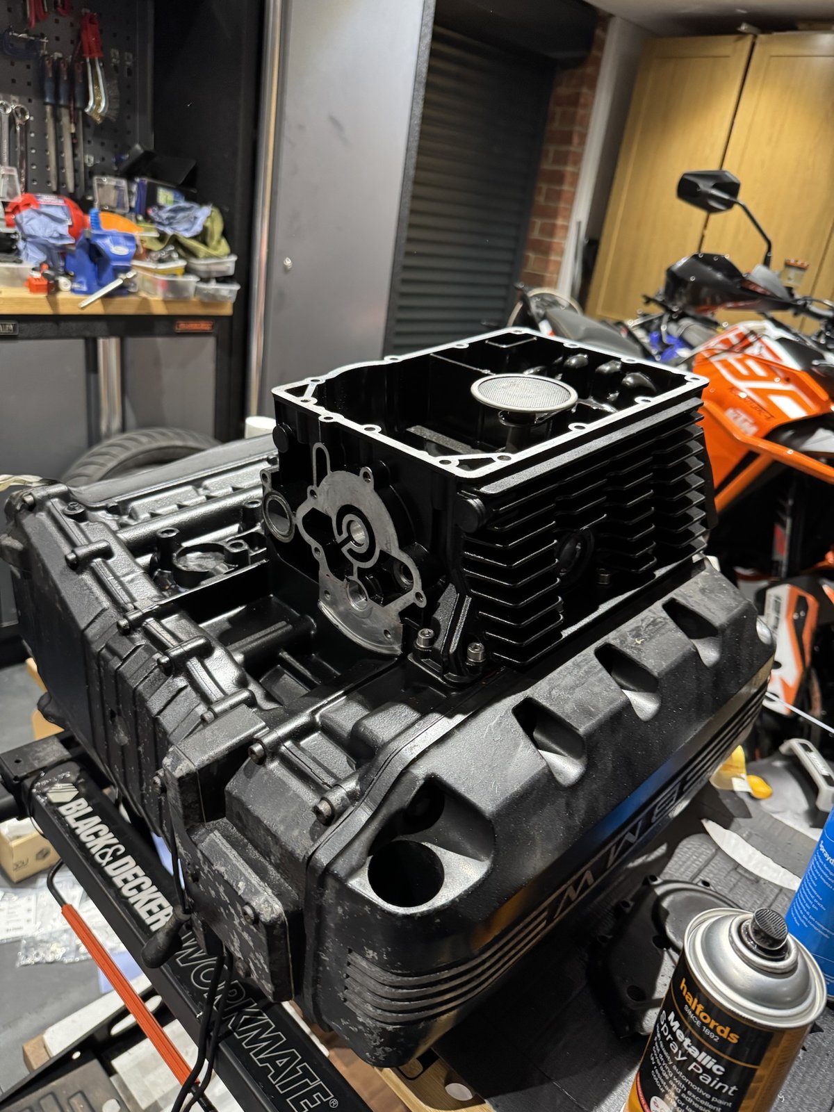

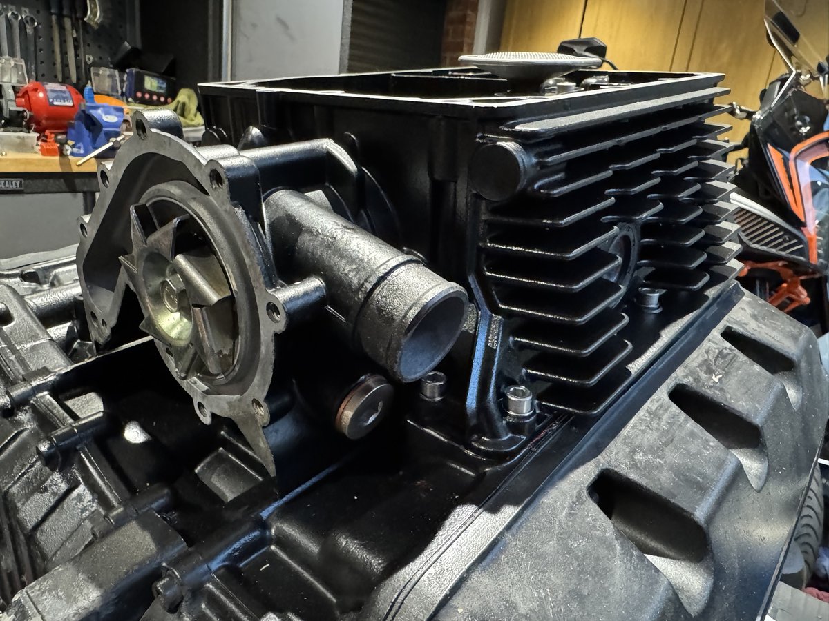

The build has started! After reading all the threads on sealant, its hopefully all in the prep and it holds - I really dont want to come back here because its leaking.
The problem with the red is its a little visible.
But it comes off nicely once set.
Waterpump rebuilt and on.

I have a small confession to make. I did not replace the water pump impeller bolt and the spacer. Am I going to die in a fiery crash? The irony is I actually had a new spacer. But it was very nicely pressed into the impeller and I cant think of what difference it would make.
  • London
  • K100, 1290 SDGT, 990 ADV, RC8
  • Posts: 11611
Re: Rusty's K100 Scrambler (lets try that again)
« Reply #66 on: May 23, 2025, 12:19:30 PM »
You'll find out if it makes a difference, don't worry.  112350

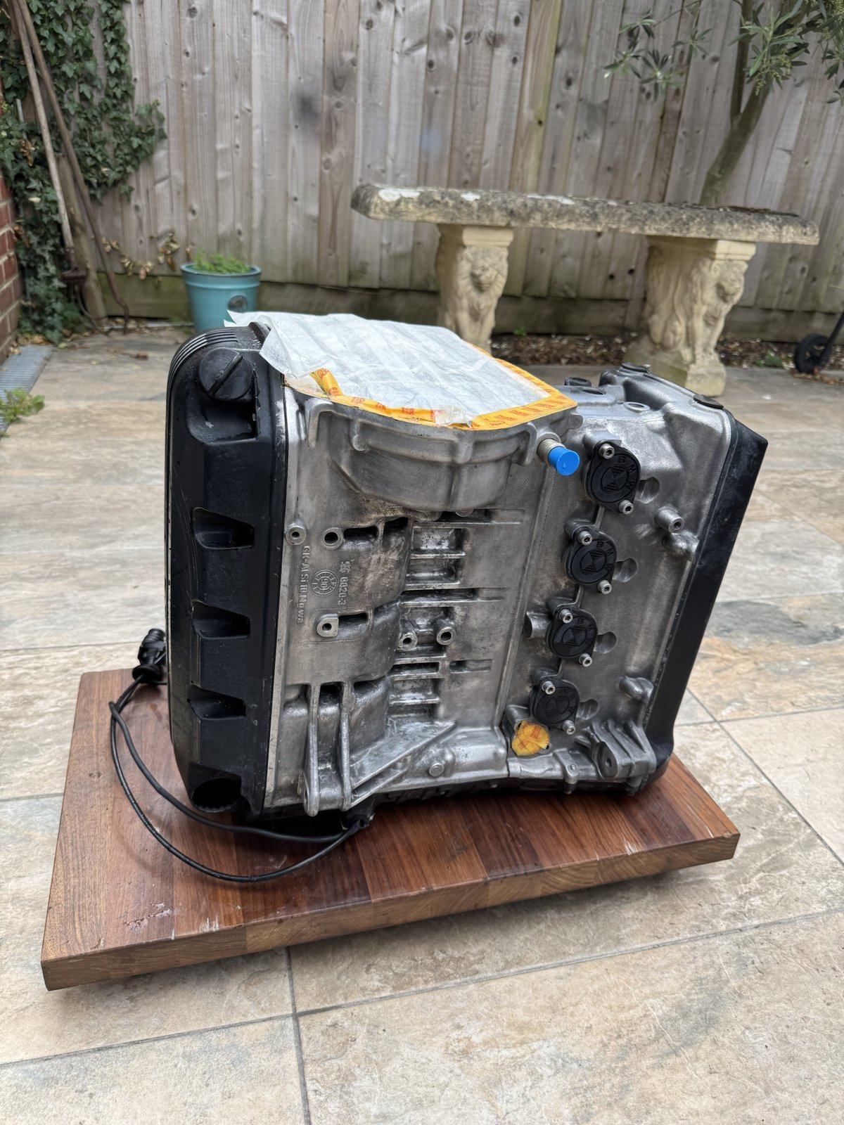

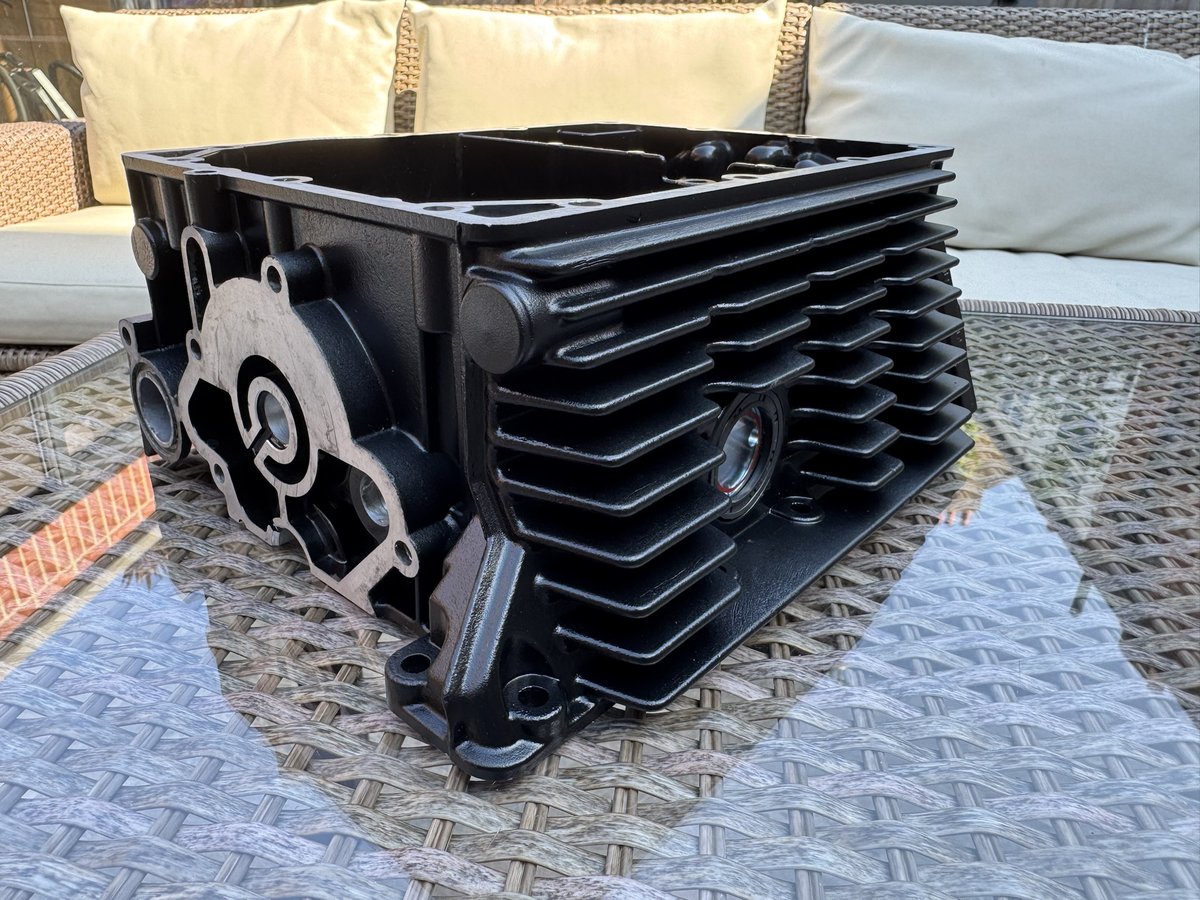

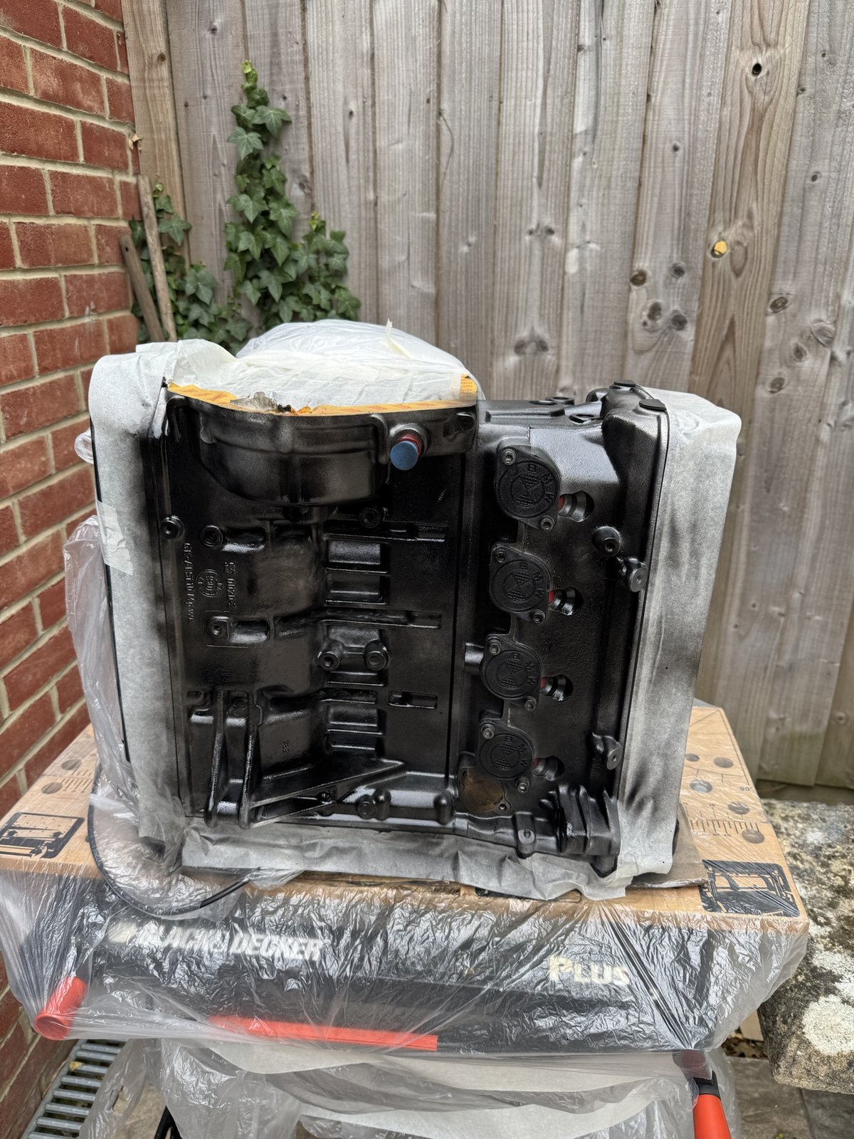

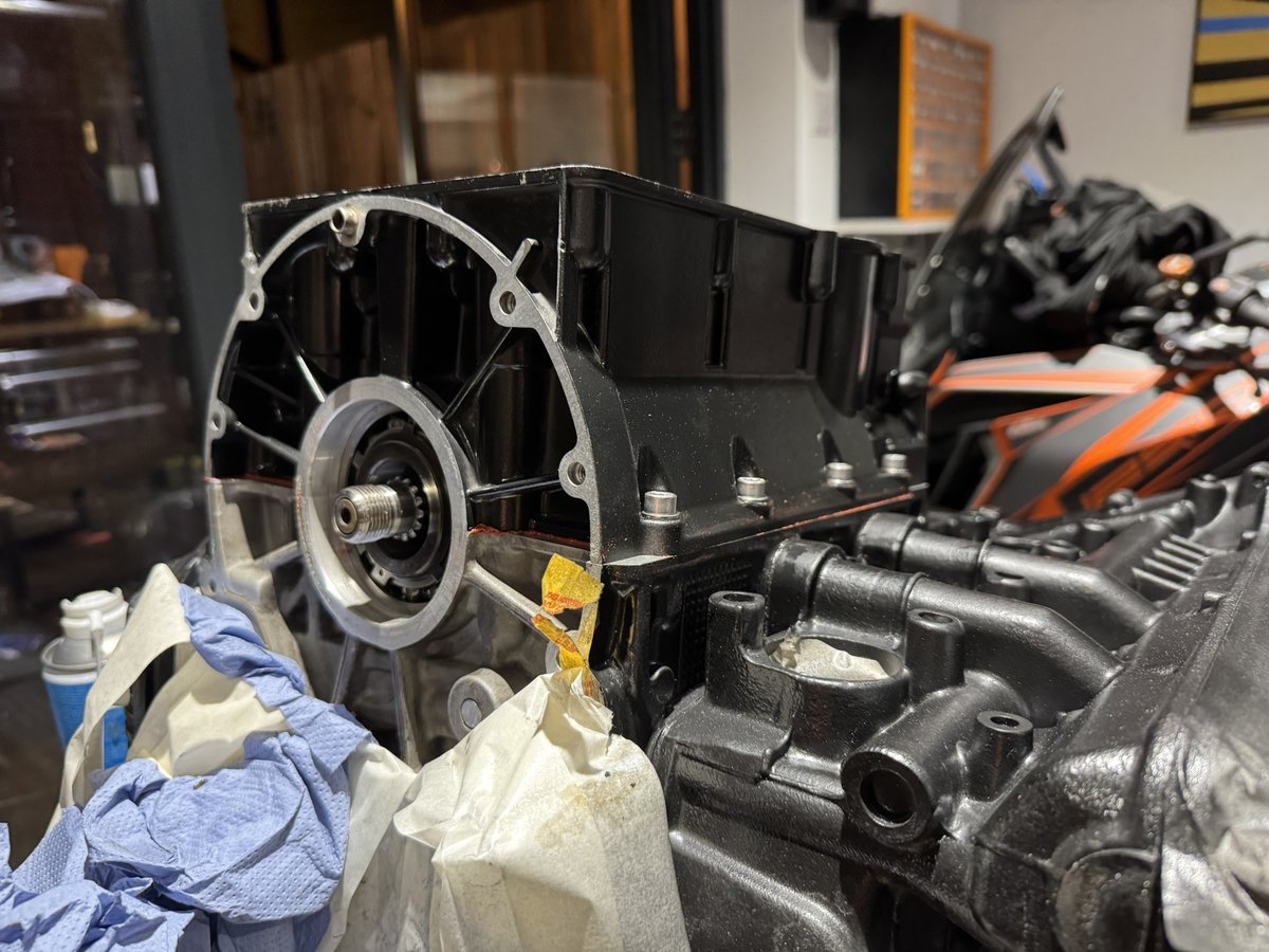

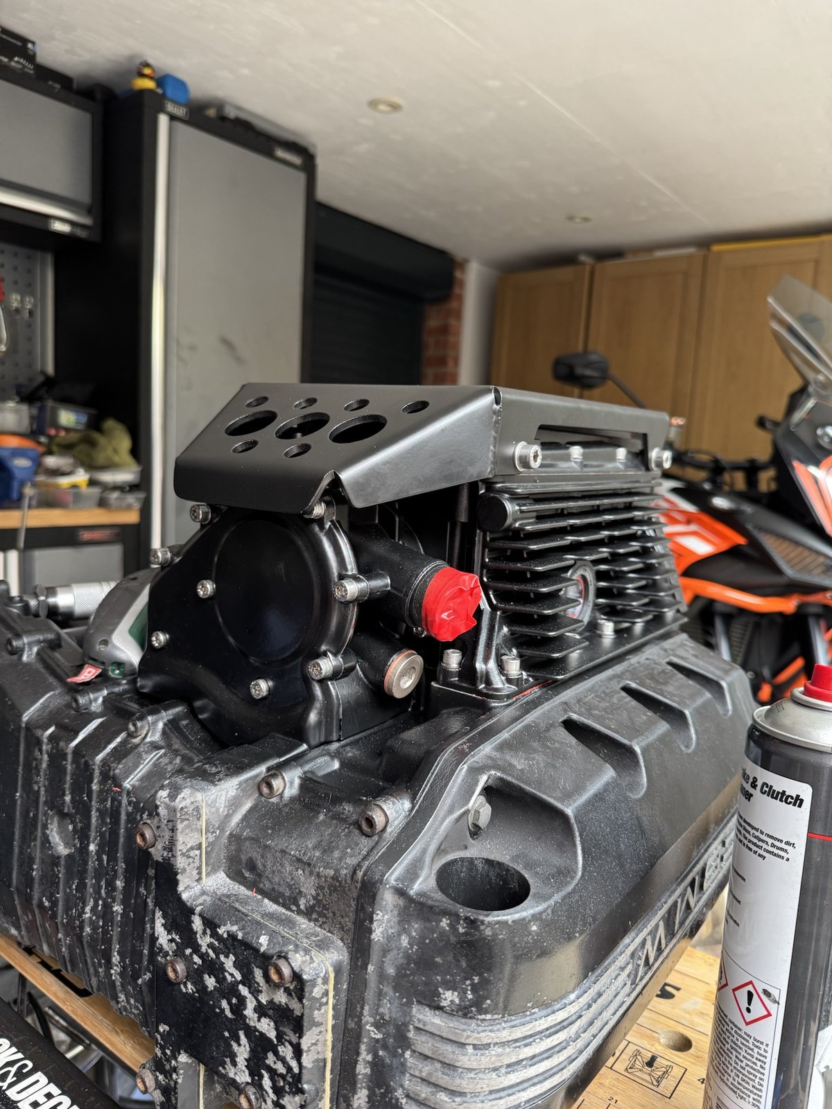

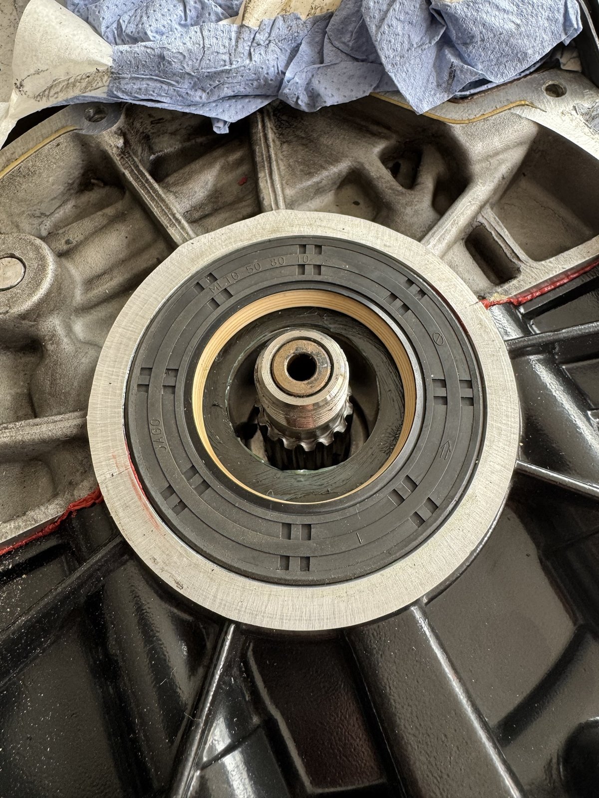

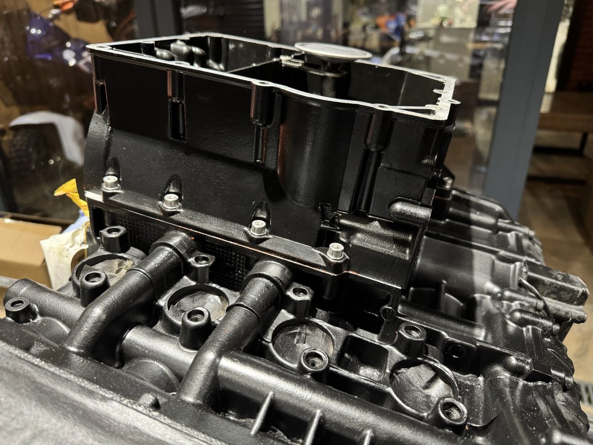

Rear main seal done....
Bottom "end" complete, including my bash plate which I hope will protect my paint a little from the front tire sandblasting.
Now just to paint the rest of the motor.
Now all thats left is to paint the front and side covers. Although thats going to get sand blasted too.

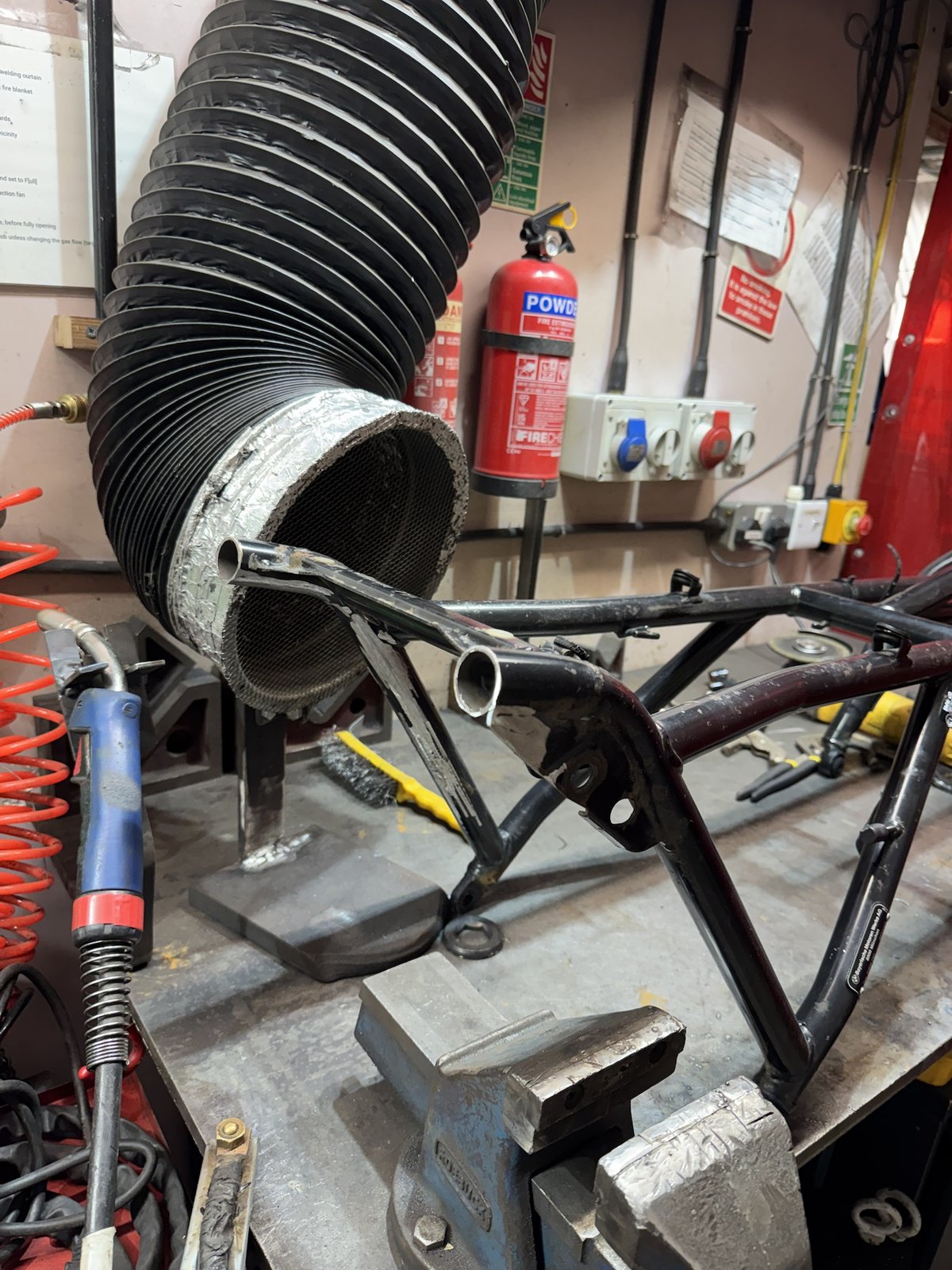

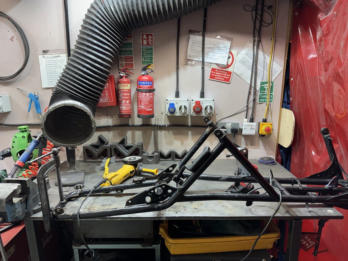

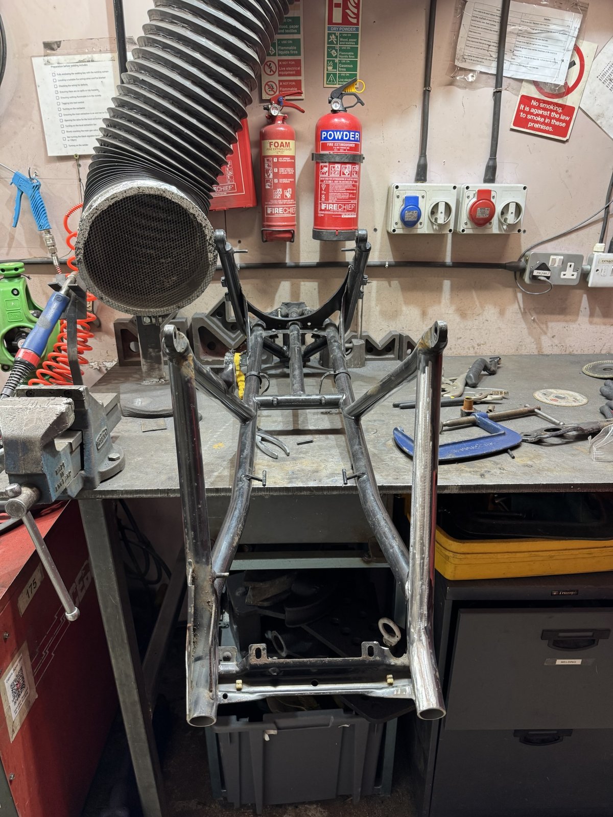

I also popped down to makers and got to work on the frame. No
No going back now.
A lot "cleaner".

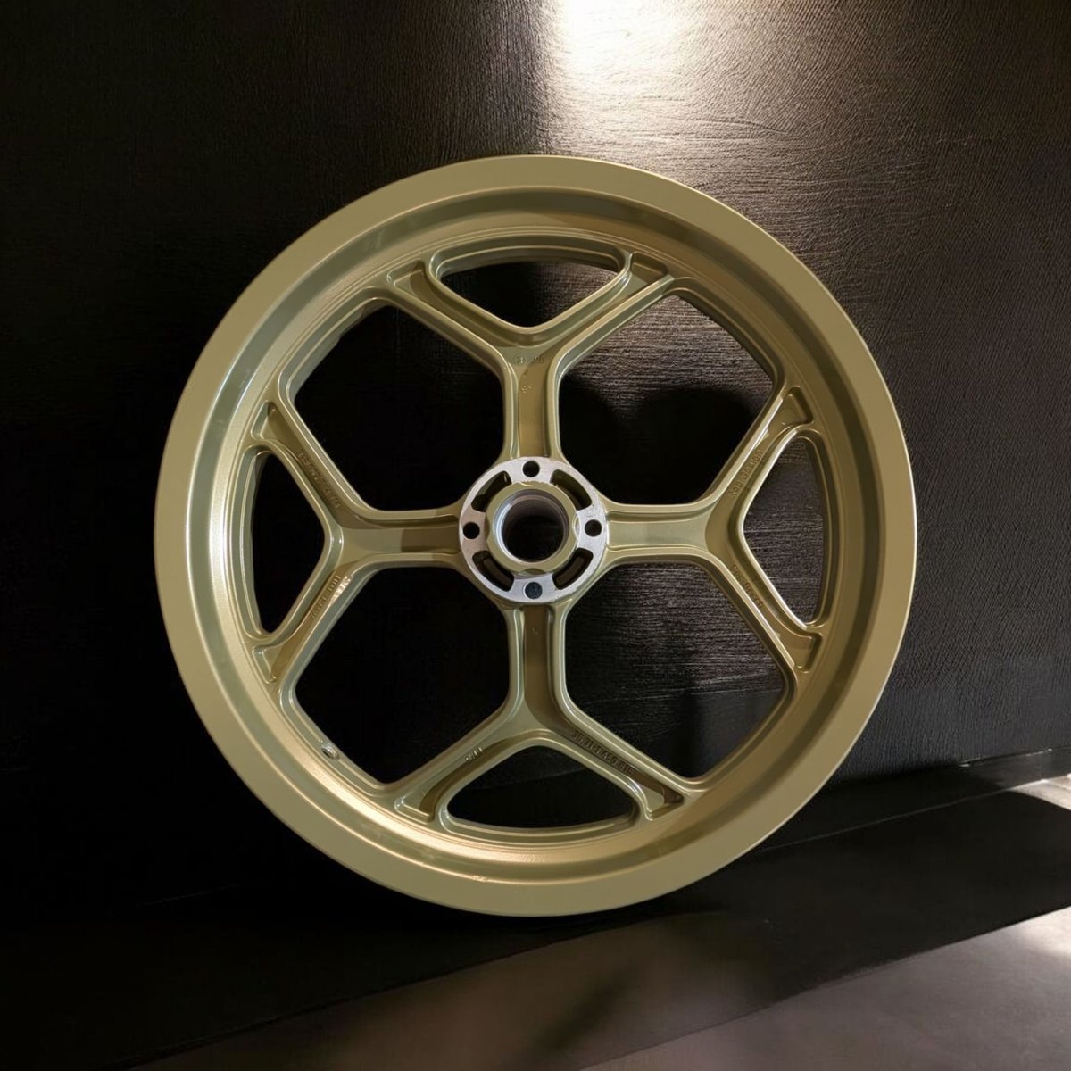

I've had my wheels and a couple bits over at the professionals.
Sneak peek -
I cant tell you what fantastic service this guy gives - could spend hours with him in his workshop - proper enthusiast.
