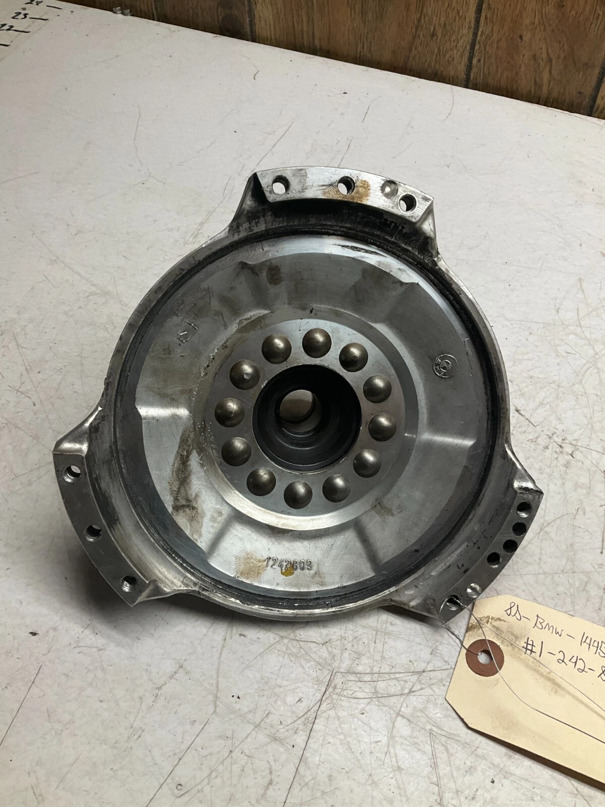

Ok Folks, we have decided to put the old clutch BACK in. The new clutch pack did not have balance marks of any kind. Question, the factory clutch installation ring / housing that came with bike did not have markings. But since I know the orientation, I put it back the same way. The motor and pressure plate have yelllow marks. The finger spring, and outer ring do not. Also the clutch seems to have a brass balance rivet. The new ( not installed ) clutch does not. The two yellow marks available are 120 degrees apart. Why wasn’t the outer ring marked?
  • Ponte Vedra Fl
  • 1994 k75 Standard, 1985 k100 ( BFK 49 states) 2002 Harley’s Dyna, NEW 1999 R1100SA & my favorite 2006 Vespa LX150!
Re: 1990 K75 refresh
« Reply #4 on: June 01, 2024, 11:06:05 AM »
I've never seen a clutch housing with that many holes in it! (They drill those to remove metal to get it balanced.)
Usually they have fewer holes.
  • Posts: 11648
« Reply #5 on: June 01, 2024, 11:21:23 AM »
You can check that off your bucket list! icon_cheers
If the clutch disc was within spec, what was the reasoning behind replacing the whole shebang, Atabeach—money laundering? Believe me; I know how it is down there, but real estate is the traditional method.
It does make sense to put things back the way you found them but each part is individually balanced so it's not a huge deal. BMW also sells the parts individually, not as a balanced set. If it really mattered that much then they would not do that.
I once forgot to mark a clutch when disassembling and just reinstalled it. Worked fine.
Also the manual instructions are odd. It says offset by 120 degrees but not which way.
That's not so odd. What matters to BMW—if not the rest of the world—is that the marks are separated from each other by the legs of the triangle they create instead of being stacked. The assembly is balanced regardless of which way it rotates or which mark is at either end of the triangle's base.
The obsessive among us might consider making one mark across the edges of the coupled assembly in one place before the assembly is removed, then reassemble the pack so the marks on their edges line up.
Failure in accurately aligning the clutch disc during assembly is what should really occupy obsession.  :laughing4-giggles:

I did exactly that. I’m hoping it’s not THAT critical. The clutch itself should NEVER have marks? It rotates independently of the triangle…..being, the motor housing pressure plate and outer ring assembly. Am I missing something?

"Why wasn't the outer ring marked?"
There's a few possibilities. One possibility is that sometimes the mark is on the other side of the cover plate. Have a look for a paint mark on the other side, and it might not be visible until you remove it from the other balanced parts.
The diaphragm spring doesn't have a balance mark for the same reason you mentioned about the clutch, the balanced parts spin independently of them when the gears are changed.

Not marked. Either side. Puzzling. Especially since this is definitely the original BMW install. I guess it may not matter that much….by the way, it never occurred to me the spring spins independently…ergo not balanced. Another puzzling thing the clutch DEFINITELY has a brass weight.

A couple of thought bubbles of how it seems to make sense to me. In the past I've replaced tyres. Removed the old one, removed the balance weights, installed the new one with the balance marks in the correct orientation, spun it up on a balancer, and it's balanced! Where do you put a balance weight if it's balanced first up? You don't! But then it looks like it's unbalanced cause there's no weights on it. Granted that's rare, but it sometimes happens.
The parts for balancing would be placed on a balancer, then a measured amount of steel would be removed, and then checked again for balance. If still out, more can be removed, but if only half a bees dick needs to be removed, re-drilling isn't required, simply a paint mark is placed on the heavy spot. But what if it's perfectly balanced when checked again, where would you place a balance mark? You wouldn't! This would happen more often than we might think because a calculated amount of steel is removed for initial balancing. It's a safe bet that BMW would put these parts aside, so if you buy a clutch pack, the balanced parts would all have a balance mark, or none would. I think it's a safe bet that your clutch pack parts are balanced and can be installed regardless of orientation. If there are balance marks, the three marks should be spaced evenly apart at 120 degrees.
Puzzling.
The cover plate may have been replaced with a balanced, unmarked one. It may have been oil soaked and cleaned by a previous owner who did a Mickey mouse job, removing the mark. Some riders aren't aware there are balance marks from the factory, especially since the repair manual says to mark the parts, and they could be black all over. Sometimes it's a thick blob and chips off with a rough handling.
True enough my description of the diaphragm spring is crappy, maybe I should have said it doesn't have to be synchronised with the balanced parts, which are not symmetrical, or something like that.

Get ready for multiple incoming longshots here. Does the yellow mark on the clutch basket look more like a paint stain where a yellow paint blob used to be? Yes, I think it does.  Looking at a small phone screen here, so not sure. Let's say the paint marks have been scrubbed off. Ok if we look at the cover plate above this spot, or 120 degrees from it, do we see a yellow stain? Yes, I think we do.
In the first photo of reply 17 at about nine o'clock (third bay below the 070 mark) I think I see a yellow stain, maybe you can confirm this, I'm not sure. Anyway this is either above the clutch basket yellow mark or 120 degrees from it. I'll hazard a guess that this is 120 degrees from both the yellow mark on the clutch basket, and also 120 degrees from the yellow mark on the pressure plate.
Bit of a long shot? Yes, but then it's a bit of a coincidence if it's 120 degrees from the clutch basket mark.
