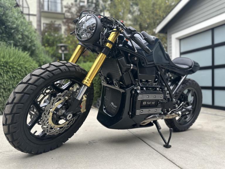

Well she's finished and up for sale.
Wife gave me the green-light to build my dream Porsche but the bikes had to go. It's been a blast learning how to wrench on these amazing machines.
* IMG_1517.jpeg (79.92 kB . 768x576 - viewed 580 times)
Excited for this ground up project 1987 Porsche 911.
* Screen Shot 2023-05-31 at 3.12.57 PM.png (38.94 kB . 768x494 - viewed 572 times)
Safe riding fellas!
-Ian

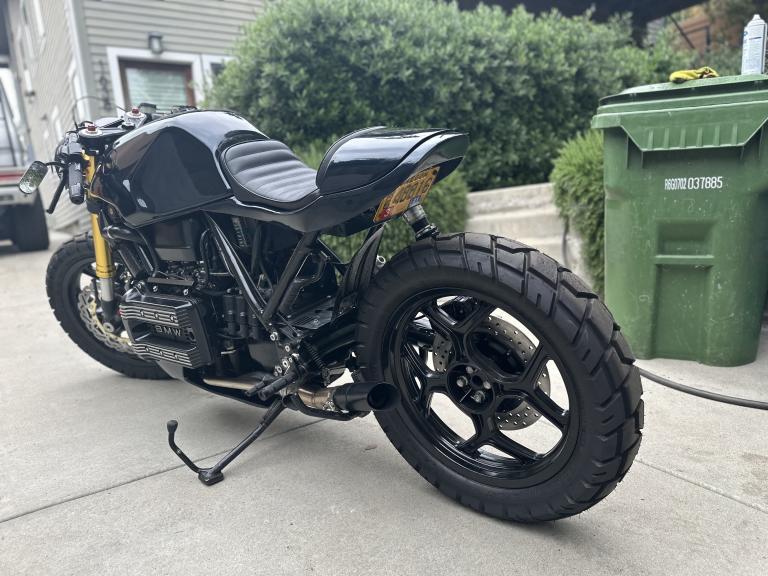

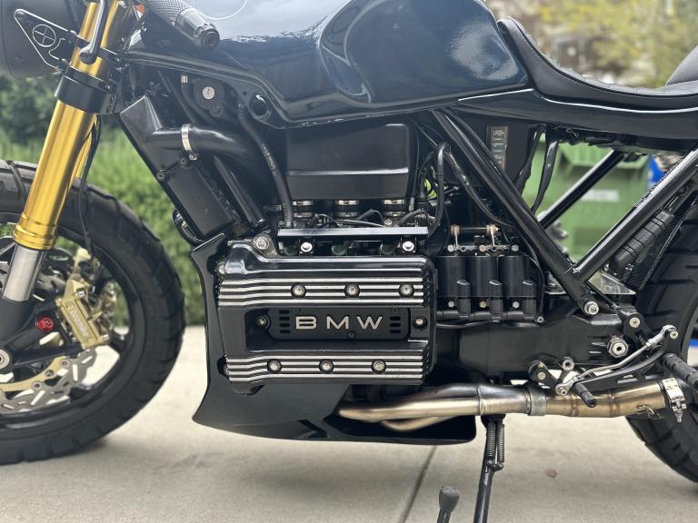

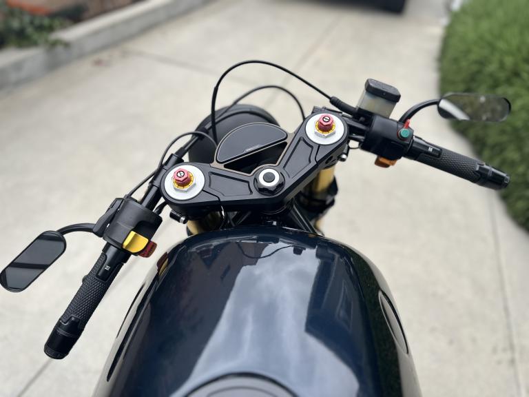

« Reply #9 on: June 01, 2023, 11:40:47 AM »
Ha, the 911 was going to get an LS engine until I found a low mileage car being parted out not too far from me.
I've put the bike up on Craigslist.
https://losangeles.craigslist.org/lac/mcy/d/los-angeles-1995-bmw-k75s-caferacer/7627426095.html
Here's a build sheet (not complete) for anyone looking to build a similar setup, or if anything jumps out
Some more shots as well:
* IMG_1522.jpeg (75.49 kB . 768x576 - viewed 592 times)
* IMG_1520.jpeg (46.6 kB . 768x576 - viewed 613 times)
* IMG_1519.jpeg (76.75 kB . 768x576 - viewed 597 times)
* IMG_1518.jpeg (78.76 kB . 768x576 - viewed 628 times)
Sale comes with new Roland Sands leather jacket, new Ugly Bros Kevlar pants and new cafe style helmet.
