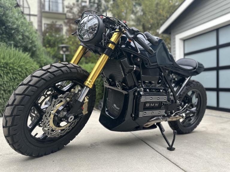

Well she's finished and up for sale.
Wife gave me the green-light to build my dream Porsche but the bikes had to go. It's been a blast learning how to wrench on these amazing machines.

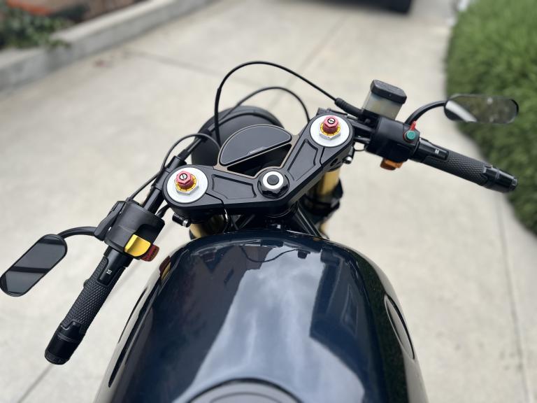

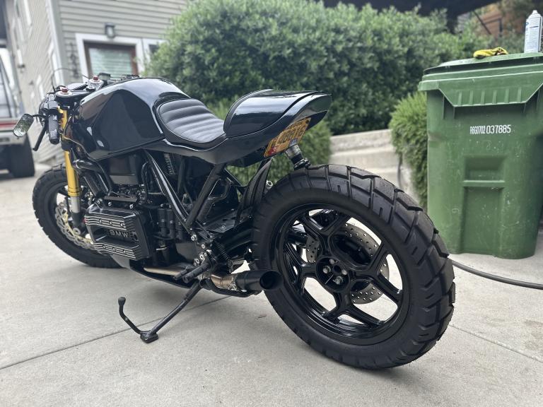

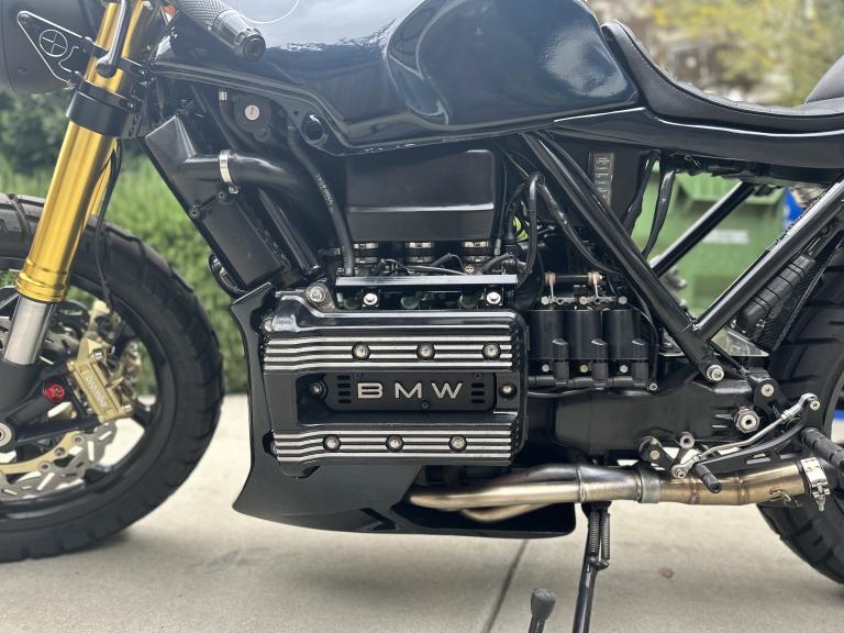

Here's a build sheet (not complete) for anyone looking to build a similar setup, or if anything jumps out
Some more shots as well:
* IMG_1522.jpeg (75.49 kB . 768x576 - viewed 783 times)
* IMG_1520.jpeg (46.6 kB . 768x576 - viewed 818 times)
* IMG_1519.jpeg (76.75 kB . 768x576 - viewed 810 times)
* IMG_1518.jpeg (78.76 kB . 768x576 - viewed 822 times)
Sale comes with new Roland Sands leather jacket, new Ugly Bros Kevlar pants and new cafe style helmet.
BMW K75S Build Sheet:
Front End
The PowerBrick conversion kit
Custom Triple Tree Clamps
BMW S1000RR Rebuild Forks
BMW S1000RR Cast Wheel hub
Brakes Front
Gold Brembo Calipers
Venhill Brake Lines
EBC Double-H Sintered Front Brake Pads
2020 bmw s1000rr oem front rotor hp Titanium rims bolts
Arashi 320mm Brake Rotors
Brakes Rear
Rebuilt Brembo Caliper
New Brake Pads
Venhill Brake Lines
New Brembo Rear Mastercylinder
New Rear Brembo drilled rotor
RearSets
The PowerBrick Rearsets in anodized black
Tires
Front
Shinko 705 Series Dual Sport Front/Rear Tire
Rear
Paint
BMW Black Carbon Metallic
Rear Seat
Cafe4racer custom cafe seat
Custom Upholstery
Electronics
BEP 3.0
Motogadget Motoscope Pro
Motogadget Breakout Box B
NOCO Lithium NLP5, Group 5, 250A Lithium
Headlight
Choice City Moto LED with integrated turn signals
Choice City Moto CNC Aluminum BMW brackets
Choice City Moto CNC Anarchy Cover
Taillights
Radiantz Red LED
Kuryakyn Stop + IntegratedTurn signals
Misc
New Swingarm bearing
New Injectors
New Sparkplugs
New muffler with baffling
Revue Carbon Fiber rear Mud Guard
Custom Battery tray cover
Custom Radiator Cover
Dual HELLA 011225802 Horns
Oil Temp dipstick Gauge
Full oil flush/change
Full radiator flush/change
Custom radiator overflow tank
New Air Filter
Stock Light Relay re-wire for LED use
K75S Radiator retrofit. Bike was originally a K75RT (Larger Radiator hidden under stock faring)
All fuel lines replaced
All Radiator hoses replaced
All clamps for intake replaced
Alternator and Alternator Bushings replaced
New Clutch (Prior to my purchase)
New Throttle Cable
New Clutch cable
New strap-ons
Max-Inc Sportz Black Anodized CNC Machined Aluminum/Rubber Hand Grips
Custom ignition key and alternator warning light relocated under tank
Arlen Ness 13-413 Ness Micro Mirrors
Custom CNC Aluminum fuel cap
Additional with the bike
Custom PowerBrick CNC BMW Tank badges, will let you decide how you want to go here.
K75 Repair Manual
Motogadget Motoscope Pro Manual
Spare ignition Key and Tumbler (Came with bike when purchased)
Original Service Manual / Owners Manual
Binder with all documentation on the build
Stock Gas Cap (Raw Aluminum, if you want a locking cap you can paint to suit)
