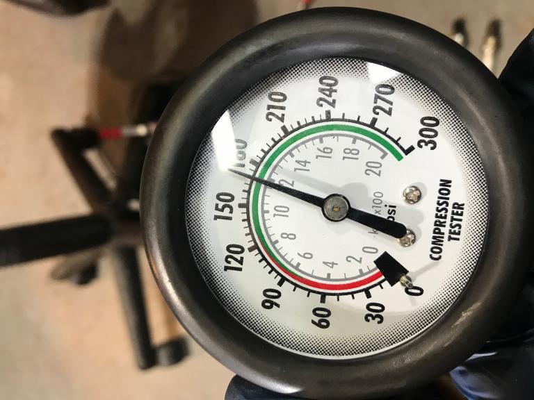

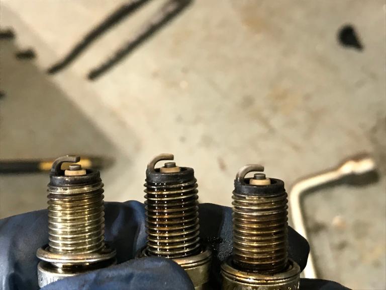

« Reply #35 on: March 15, 2020, 05:09:14 PM »
UPDATE
Compression test = Done. Reasonable and similar for each cylinder

Injector install = New injectors, new o-rings, cleaned injector pipe, replaced injector balance rubber caps
Port clean and 0-ring replacement, cleaned and done.
Exhaust mount check = replaced stock mica gasket checked all mountings
When I went to balance the throttle bodies I still could not get them to balance. The rearmost cylinder needs to be backed all the way out and still does not balance to the center cylinder
With the adjustment screws all the way in the front and center cylinders balance well.
A few weeks earlier I had sprayed the throttle bodies with carb cleaner and did not see a drop in RPM. I don't know if perhaps I was concentrating on the top of the bodies or not but this time I was out of carb cleaner so I grabbed the silicon spray next to me and the RPM drops hard when I spray the bottom of the throttle body of the front and middle cylinders.
No idea if this relates to my noise issues but obviously I will have to fix this first.
