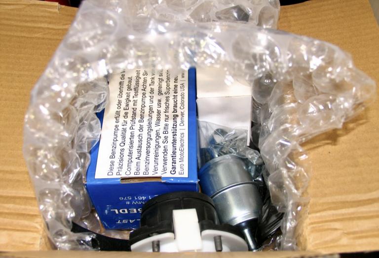

Received fuel parts and battery from EME today. Not bad, ordered Friday and received today Tuesday, from Colorado to New York, Fedex. Anyway, here are the pics of the goodies.
Enduralast 52mm fuel pump kit (pump, housing, anti-vibration, fuel lines, fuel filter, filter cup, screws and clamps).

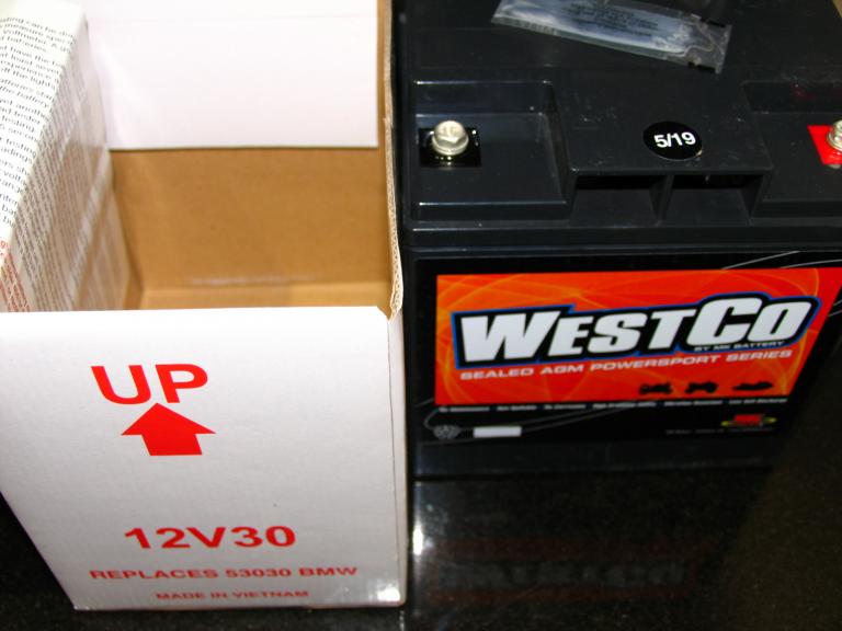

WestCo 12V30 AGM battery.
* IMG_0002.JPG (43.88 kB . 768x576 - viewed 1880 times)

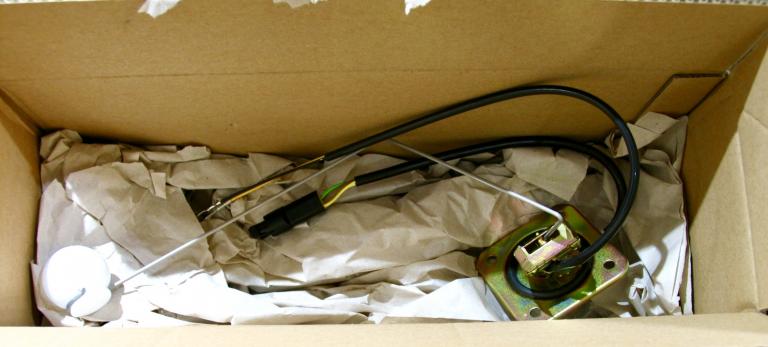

BMW OEM fuel level sensor.
* fullsizeoutput_37f4.jpeg (36.62 kB . 768x347 - viewed 1808 times)
Will work on getting these installed over 4th Holiday. I am curious to see how the electrics come on after hooking up the battery.
Question; What is the best way to try an initial start-up since there may be old fuel in the lines and injectors? Should I take the injector rail out and crank the starter to expel old fuel out the injectors and into a container, or leave everything as is and try to start?
I will have to also refill the radiator with antifreeze since I drained it. I am figuring I can change the oil and filter after I get it started.
Thanks.
