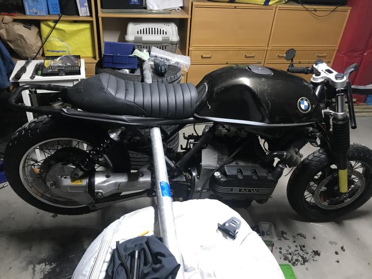

Hi everyone!
Here’s some updates on my work so far :
Front wheel is on but need to work on axle bushes. I have still to fabricate some brackets for the new calipers. I would like to use aluminum for the brackets, will see.
Fork yoke from Twisted Brothers. strap-ons from Cafe4racers. Original instrument bracket I’ll try to use as bracket for the front fairing.
Have some new Bosch injectors. Do they need some tuning? Will this swap affect idle?
New old k1100lt gearbox with final drive from same model.
Rear wheel fitted. No modifications needed. Except for the final drive lock(cap?) which is from a r1100gs and that one came with a caliper from same bike (or at least same model).
New rear shock and some awesome Pirelli MT60RS.
Motogadget Munit in progress. Looks like a mess but I think I came around most of the big issues. Still need to cut useless wires and relays from old harness. I did not had the guts yet :)
I’m thinking about modifying fuel tank. Give it a more straight line at the base. Will see.
What are your thoughts so far?

Offline Flodabo
  • Posts: 36
Re: Fitting a RnineT front wheel to a K75 1988
« Reply #11 on: November 14, 2018, 03:36:50 PM »
* image.jpg (69.1 kB . 768x576 - viewed 1423 times)

Offline Flodabo
  • Posts: 36
« Reply #13 on: November 14, 2018, 03:39:08 PM »
K1100lt gearbox and drive
  • Sweden, Gothenburg
  • k75s 1987
Offline Flodabo
  • Posts: 36
« Reply #14 on: November 14, 2018, 03:40:34 PM »
Rear caliper and gs lock(cap?)
  • k75s 1987
Offline Flodabo
  • Posts: 36
« Reply #15 on: November 14, 2018, 03:42:56 PM »
Munit and a nice headlight from caferacersunited
  • k75s 1987
Offline Flodabo
  • Posts: 36
« Reply #16 on: November 14, 2018, 03:53:16 PM »
And the front fairing. Will need to fabricate some bracket for this cause I can’t find anything on the web that I can modify to fit . I’ll keep that for last maybe.
