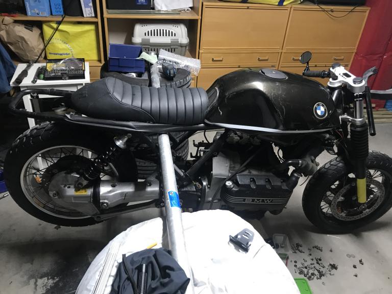

Hi everyone!
Here’s some updates on my work so far :
Front wheel is on but need to work on axle bushes. I have still to fabricate some brackets for the new calipers. I would like to use aluminum for the brackets, will see.
Fork yoke from Twisted Brothers. strap-ons from Cafe4racers. Original instrument bracket I’ll try to use as bracket for the front fairing.
Have some new Bosch injectors. Do they need some tuning? Will this swap affect idle?
New old k1100lt gearbox with final drive from same model.
Rear wheel fitted. No modifications needed. Except for the final drive lock(cap?) which is from a r1100gs and that one came with a caliper from same bike (or at least same model).
New rear shock and some awesome Pirelli MT60RS.
Motogadget Munit in progress. Looks like a mess but I think I came around most of the big issues. Still need to cut useless wires and relays from old harness. I did not had the guts yet :)
I’m thinking about modifying fuel tank. Give it a more straight line at the base. Will see.
What are your thoughts so far?

You've made significant progress. Did the engine of this moto run well before you started remodeling it? Did you ride it much?
Hi Laitch
I had bad idle in both cold or warm engine. Had to keep engine on with throttle. Valves?

You should perform a thorough tune up on your used moto that includes valve adjustment, throttle position sensor adjustment and throttle body balance once you have thoroughly cleaned and tightened all electrical/ground connections, cleaned or replaced the air filter, replaced the fuel filter, and verified that the fuel pump works well.
There is no way to tune fuel injectors. They can be cleaned and their o-rings replaced. Be certain their electrical contacts are clean.
