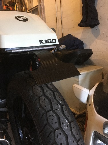

Good Morning World.
Spent the last few days finishing off the Machine and then took it for its MOT. The garage where I go are very accommodating and looked her over before the test and advised me of the following.
Under new legislation the indicators on a motorcycle over 50cc need to be more than 240mm apart at the rear and more than 300mm apart at the front. When you consider that a 7 inch headlight is only 177mm wide that means that unless your Bike has long stalks it could fail an MOT. The tester told me that most bikes already fail this requirement!
Anyway I need to add extra indicators to the rear, he will let the front go through. New indicators ordered.
Also the rear brakes were binding. I had bought new pads and the inside pad seems to be dragging. When I looked closely it seems that the rear calliper does not sit centrally over the disc. There was not any shim fitted when I took the disc off for cleaning and I could not see any on my Haynes manual. I ended up sanding down the inside disc and it's moving freely now.
I need to play with the bike a bit. Its running a little lumpy and I'm getting popping and the occasional backfire. Wakes up the pedestrians  :hehehe. The bike starts on the button and idles ok. Does not need the choke either. I think I may need to look at the air mixture or possibly ignition timing. If I get no joy I will post a video.

« Reply #84 on: July 05, 2018, 03:27:11 AM »
Good luck, Skunky!
Neither my front (either side of a 6.5" ShinYo headlight) or rear indicators (bolted to either side of the frame hoop) are 300mm apart, Triple S went through with no advisory's, MOT Testers discretion I believe.
He's letting the front go through which are 240mm. But he wasn't happy with the rear LED strip indicators when the brake lights were on as the yellow doesn't show clearly, so I'm putting a couple of additional ones on. TBH I had to agree with him. He also pointed out that the new headlight beam isn't the right shape. But as it's an e-marked light he's letting that through too. It just goes to show that even if you buy e-marked gear made for British roads they still might not be good enough.

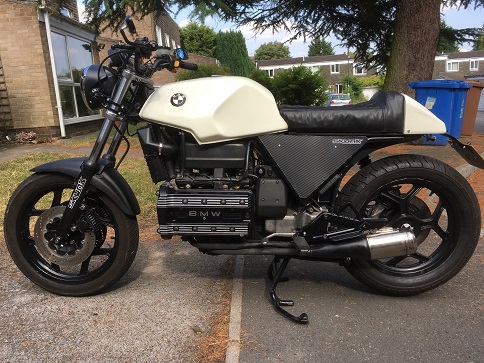

Offline Skunky
  • Posts: 525
Re: Not a cafe racer project K100
« Reply #85 on: July 11, 2018, 04:44:28 PM »
Enough Said. Time to get some miles in.

Offline Skunky
  • Posts: 525

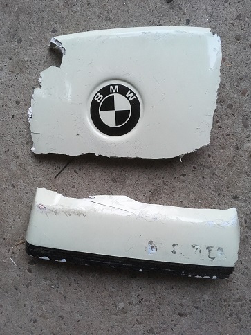

« Reply #90 on: July 14, 2018, 10:35:22 AM »
Brotherhood of the Beemer hear my confession. Insanity! Distraction! or Just Early Stage dementia I am not sure......
Last Sunday I took off the rear tail piece,(which I had so lovingly created using a broken tail from an RS instead of the slightly clumsier tail from the LT), In order to fit some additional Indicators to satisfy the MOT gods. Fitted the indicators and later that evening went for a short run down a fast dual carriageway for a "check everything was OK" joy ride. Got back home minus the tail!!!!
Went back out and recovered it.
And this.......
* rear1.jpg (68.71 kB . 378x504 - viewed 889 times)
Became this.........
* rearohdear.jpg (73.94 kB . 363x484 - viewed 934 times)
To say that I was pissed off would be an understatement. But it was me that put the tailpiece back on, and me that didn't put the screws back in. Oh and me that has to bear the bits falling off criticism and the "what else haven't you done up" Jibes from her in doors.
I quickly knocked up an alternative tail from the LT one that I hag in the Garage (As you Do). But it doesn't fit the seat properly. I managed to get another rs tail unit from DJ Ewen which I will start work on this week.
Apart from that the bike is finished and on the road and getting better every time I ride it. I will take the time to take some more photos etc and paste them up when I get time.
* bike.jpg (101.4 kB . 484x363 - viewed 958 times)
