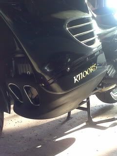

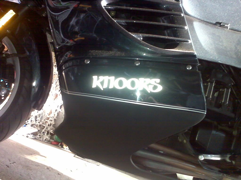

 Nothing is as tough as the Line X truck bed liner. It should run ya between 70 & 100 bucks.
 The quote from the guy in my area was on the high side, but they acted like it was a HUGE favor to do it for me. Hmmmmmmmmmmmm, bad vibes, no thanks.
 I went the Rustolum store bought can route. I did NOT do the entire cowl, just the lower portion as the paint on the upper is OK.
 #1 wash #2 tape off line to mark the area I want coated with blue painters tape #3 use 120 grit foam sanding block to REALLY rough up the paint, actually went down to the base in places #4 wipe with Brake clean or similar ether based product to remove ANY way residue #5 spray coat per instructions on Rustoleum can, at least 2 coats #6 let set overnight. #7 pull off blue painters tape #8 Add pin stripes #9 re-install and ride.
 After 2 weeks of warm weather it's OK to apply a protectorant over the newly spray area to repel dirt and keep it easier to clean. I use Turtle Wax Ice products. They leave no white residue. I don't thing you have to do this last part with a Line X coating. It's always shiny and tough. Also of note, I need to touch mine up annually for chips and wear. But! It only takes me a couple hours and the $8 for another can.
 I also could not resist and added that chrome plastic edging to set off the grill openings.
 Looks like this...
 And finally with the now black powder coated wheels.
I'd rather be riding.

« Reply #11 on: June 14, 2013, 11:02:47 AM »
Looks great! Well done.  :clap:

« Reply #13 on: June 15, 2013, 02:41:34 AM »
that jumpin jimmy b rattle can job looks abfab...
