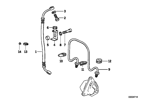

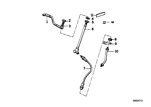

Which components were missing, Scud? My bike doesn't have a center tube feeding two separate brake hoses. Is that what you are referring to? My bike has a single hose from the handbrake to the right caliper and a pipe bridging from there to the left caliper. That is one configuration that is stock, not a modification.

Are you sure yours is stock, Laitch? The downpipe feeding short hoses to each front caliper looks standard across a range K75 bikes (realoem.com), 1995 included.
This is not true for my '94 K75 RT and S models w/ABS which have a hose to the right hand side caliper and a hard line crossover to the left side caliper.

Post by: Laitch on December 14, 2016, 09:39:20 AM
By the way, what's the difference between K75C and K75T? There seems to be a mix of windshields and handlebar heights no matter the designation.
According to the BMW parts fiche, John, it's one of the stock variations. Attached are two variations of the front brake layout found under K75S in the MAXBMW parts fiche. Mine is variation #2.
* K75S Front Brake Layout variation #1 from MAXBMW parts fiche.png (21.55 kB . 510x360 - viewed 642 times)
* K75S Front Brake Layout variation #2 from MAXBMW parts fiche.png (29.23 kB . 510x360 - viewed 699 times)
A C has a drum brake. The T model was a touring variation sold in the USA but the later models had disc brakes all around.

Post by: John Lang on December 14, 2016, 10:29:33 AM
Thanks for the clarification, Laitch. - J

A bit late to respond, but...
My 1990 K75s had the pipe through the steering stem. It was a non-ABS model.
My 1992 K75s had ABS - and it had a single flexline to the RH caliper, and the solid line arcing over the wheel to the LH caliper.
FWIW - I deleted the non-working ABS from the 1992 and moved all the non-ABS components (and forks and triple-clamps) to my 1992 "keeper."
As for missing parts, Laitch, the PO of the 1990 had run new lines from the downpipe directly to the front calipers, and had eliminated the hard lines. When I got the apparently too-short lines for the 1990, I assumed Spiegler had made an error, but then I learned that I was missing parts, not them.
