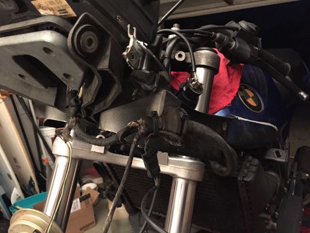

Found a local that fixes speedo/odometers and he's a K bike guy. Thinks he can repair the gears. Fingers crossed.
Also how is this suppose to be routed? Through the middle? Or around the side? And the grommet goes where?

« Reply #34 on: December 28, 2016, 03:40:41 PM »
It's routed like this:

« Reply #35 on: December 28, 2016, 04:39:38 PM »
Perfect - Thanks a bunch Scud!
