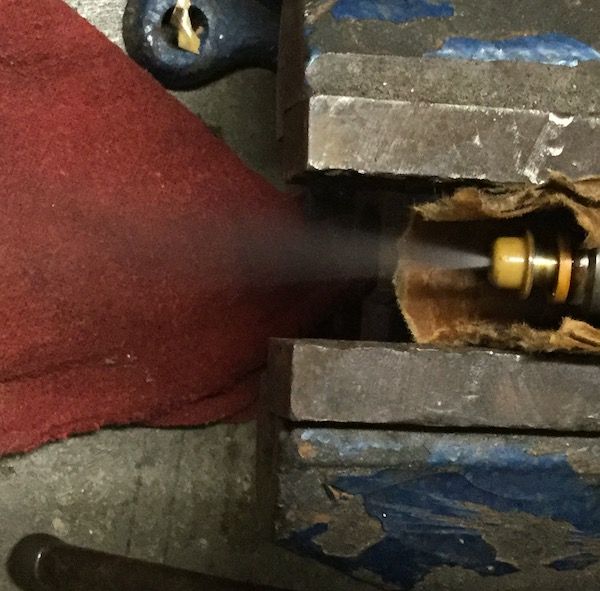

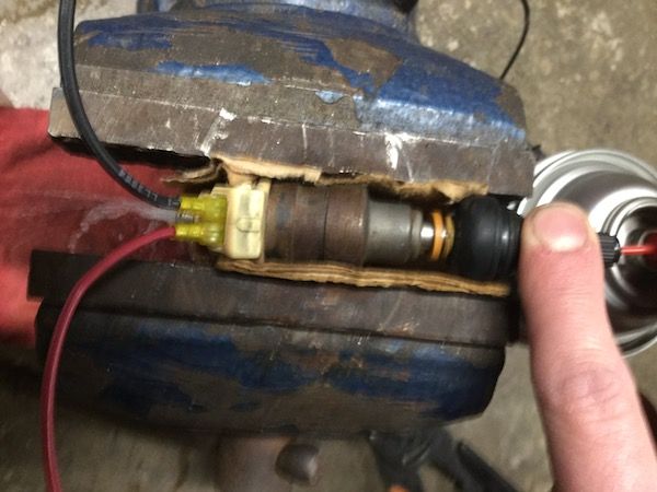

The injectors were probably 50% when I started.  Spraying multiple tight little streams. (you can kinda see the streams in the photo)  Then they came around and blasted a sweet even fine fog.

I also read there is a fine screen inside each one.  So tonight I am gonna try to shoot some cleaner through backwards to flush the screen backwash style.

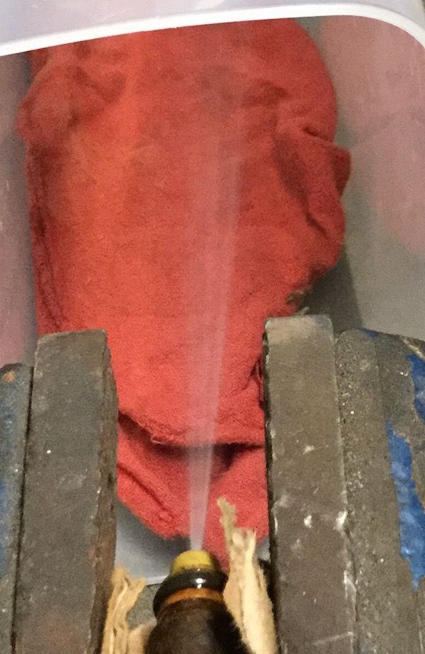

I found I had to hold the stem onto the injector.  But, was able to backwash them.
Comparison shot.  Really doesnt do it justice, can was new on the starting shot, pretty low on pressure for the final shot.
But you should easily see a difference.

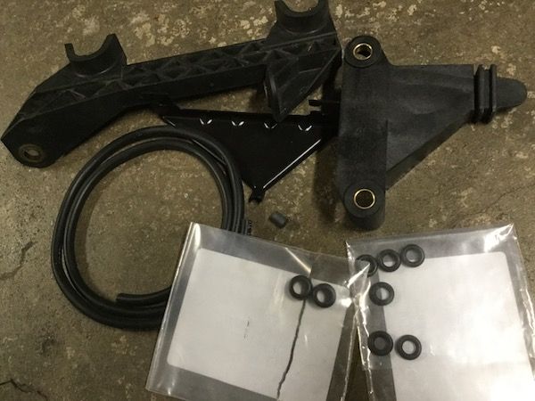

As luck would have it O-rings, grommets, vac hose and new brackets arrived from bobsbmw.
New fuel line should arrive by weeks end.

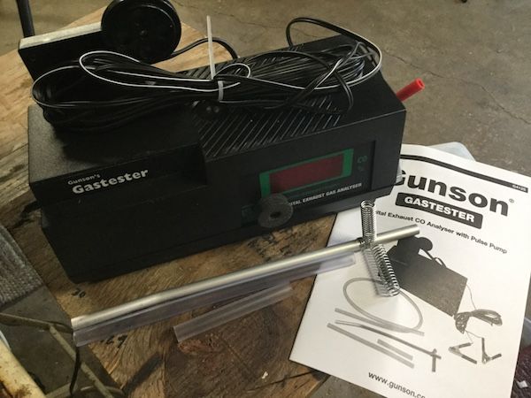

Holy cow the Gunson arrived in record time.
  • Illinois
  • 87 K75C
Re: 87 K75C injectors
« Reply #241 on: March 25, 2017, 05:52:12 PM »
For best results with the Gunson be patient, setting up is extremely important, give it time to settle. Allow time between  small adjustments for it to settle otherwise you will be chasing your tail. Important, if you need to rev the bike at any stage remove the probe. And after use you must allow adequate time for it to purge. Also due to it's light weight build treat it with care, don't drop it and don't lend it. If a mate wants to borrow it, tell him you'll do the job for him. I've had stuff broken by people who didn't treat tools with adequate care. Mine is now 18 years old and is still going strong it should serve you for a long time.
