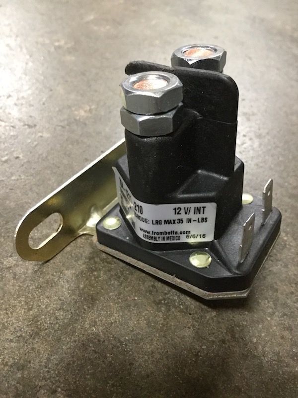

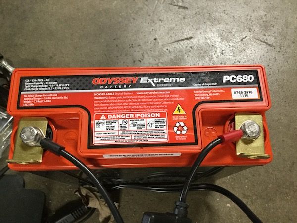

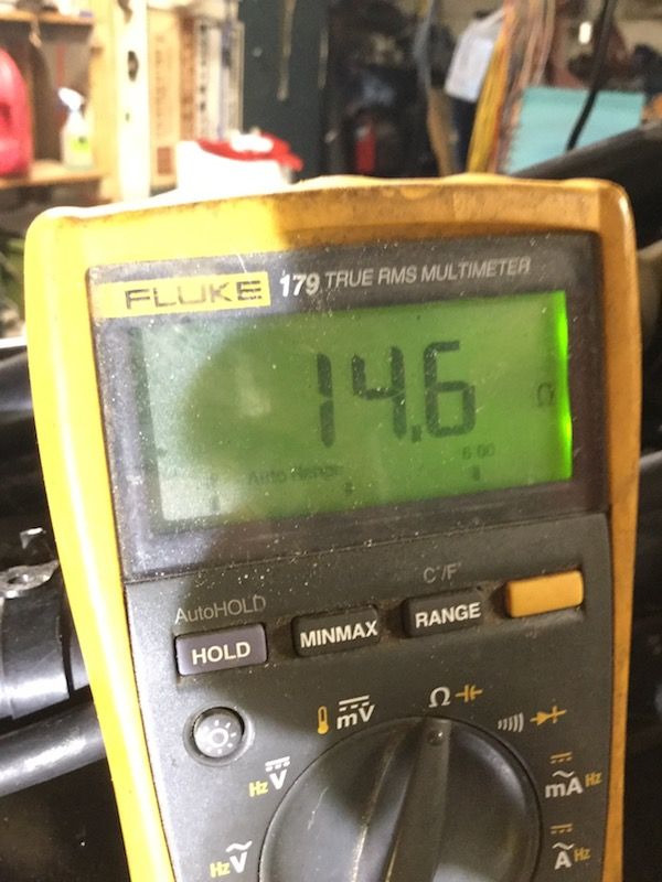

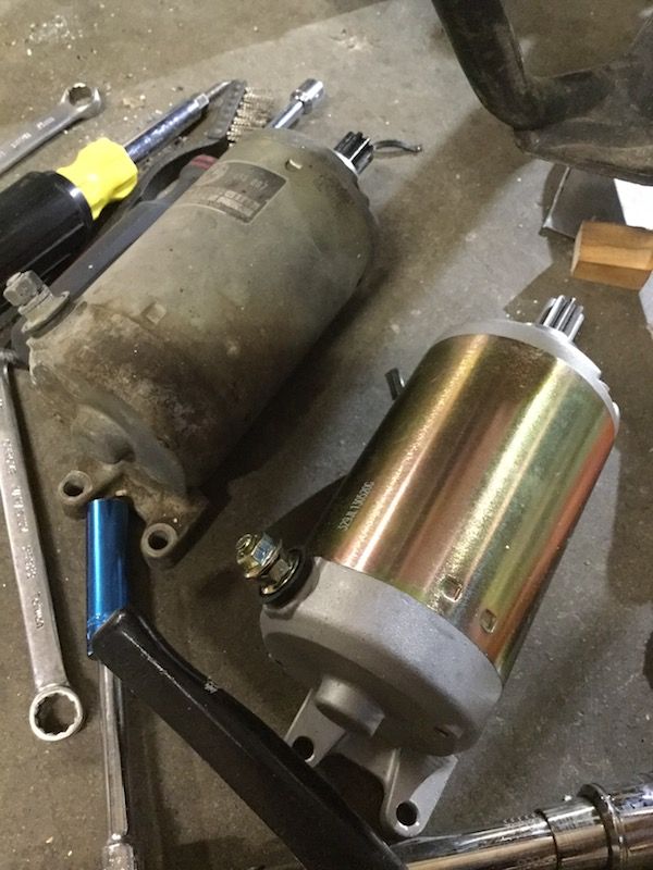

  The new Auto Zone battery the PO installed is junk.  I had it fully charged and it welded the solenoid contacts.  Pulled solenoid opened it up to clean up.  Ended up just replacing it w a better solenoid I had bought for my garden tractor.
Then, found the battery wouldnt even pick the new solenoid.  HA.  So jumped battery directly to starter.  Fully charged it wouldnt crank the engine one turn.  JUNK ARGH!  After some digging on here I found and ordered the highly recommended Odyssey Extreme PC680.
  While waiting for the battery I did some more tests and found I get 12v to solenoid by pulling the clutch but only 9v through the Neutral sw.  Hmm.  So, dug into that.  Found I got a flaky switch.  Keeping in neutral a wiggle of the shift lever I read as high as 14+ ohms through the switch.  So got a new one.

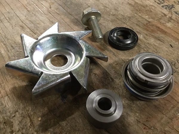

Also, while digging for Neutral sw info.  Stumbled across a Bulletin detailing the water pump rebuild.  Found I should have installed the new style impeller along w new slip seal. So I ordered all that.  Apparently the Special tool for properly installing the slip seal is no longer available...I found Bike bandit offers the tool for sale.  Ordered and a couple hours later recieved email "Unavailable"  So texted my buddy Kiley down in B-ham Alabama.  He is currently making the tool.  Maybe in the mail Monday.   :clap:
Oh and ordered a fresh starter.  As long as Im digging in this deep Im not gonna mess around.  Plan to rebuild the original and putting it on the shelf.

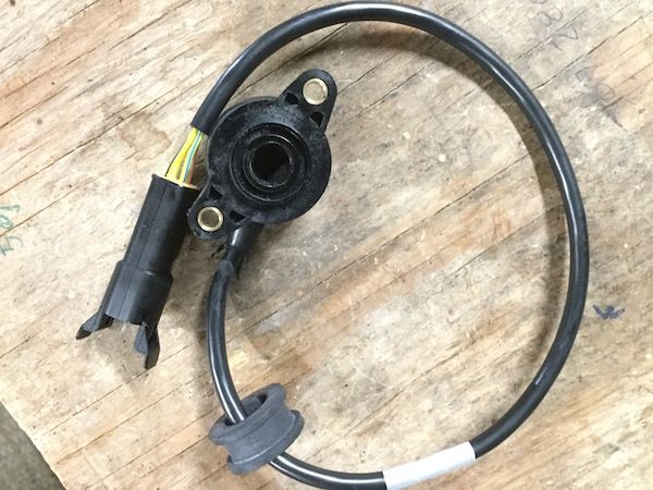

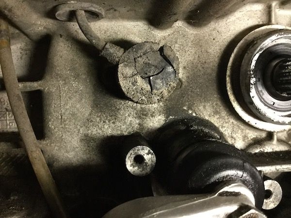

HA!  the gear selection switch might need a bit more than just a cleaning.  Probably got some water in it, then suffered an Illinois winter or two.
  • Illinois
  • 87 K75C
Re: 87 K75C/T "Flaky Neutral Switch"
« Reply #163 on: January 08, 2017, 03:06:01 PM »
Mine looked worse than that, you have nothing to loose give it a go.

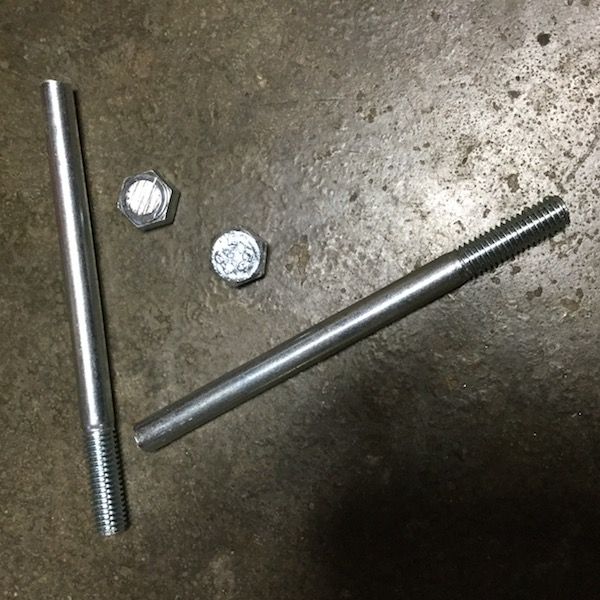

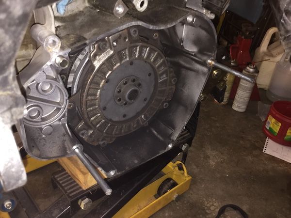

OK gents.  Gave the new switch 4-5 thick coats of plastidip spray.  Paying close attention to the seam where the cover meets the body and the wires go in.
Finally found 120mm bolts for tranny.  So, heres my thinking.
gonna drain trans oil.
Pull alternator for cleaning and check bearings, etc.
pull coil pack.
Swap trans bolts for the longer bolts and ease trans back till I can access the spines, clean and lube.
Anything Im missing on this?  Is threebond suitable for re-assembly or am I needing a better product?
  • Illinois
  • 87 K75C
« Reply #167 on: January 10, 2017, 11:29:42 PM »
No need for Threebond between the transmission and the intermediate section.
I found that those 120mm bolts work really nice for guiding the alternator back into place as well.

« Reply #171 on: January 14, 2017, 11:40:27 AM »

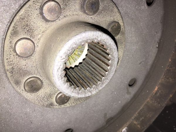

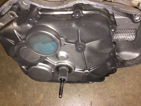

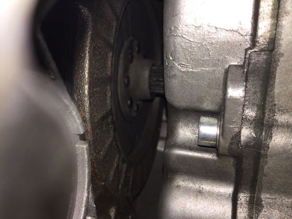

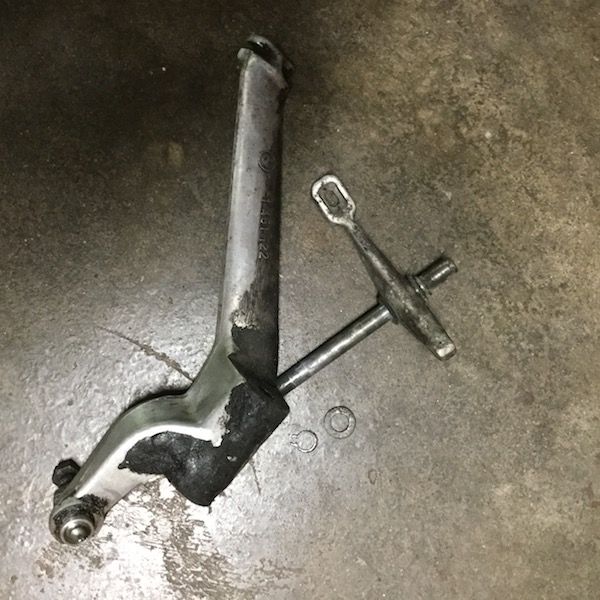

Cut the heads off the 120mm bolts.  Using the bolts to guide and support things was a huge help.  Thanks!!!
Toughest part of the whole job was removing the clutch lever without damaging the bushings and Unplugging the coils.  HA!!!

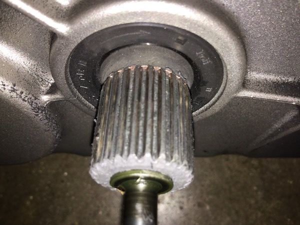

Splines look a bit dry and dirty.  Otherwise appear to be in perfect condition.
  • Illinois
  • 87 K75C
« Reply #172 on: January 14, 2017, 12:13:02 PM »
The clutch slides back and forth on those splines when you change gears.  Dry splines don't wear that much in that application, but by allowing the clutch parts to slide a bit easier, your shifting will be noticeably smoother, especially downshifting from 3rd to 2nd and 2nd to 1st.
With a couple table spoons of molybdenum disulfide added to the transmission oil you can have a transmission that shifts as smooth as a rice burner.

hey guys.  I can easily tell the clutch rod is starting into its hole.
However, I can not get the splines to mesh.
The gear box just stops 5/8inch from home. (when the splines contact.)
I have reached in there w a long screwdriver and spun the shaft 50 times.
But cant seem to line them up to get it pushed on.
Is it just a matter of keep trying til it goes?  OR am I missing something?
